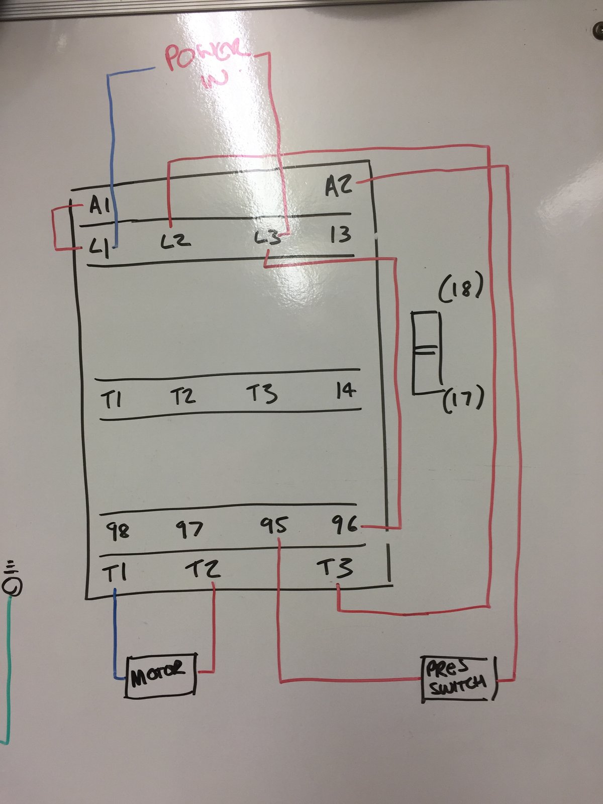

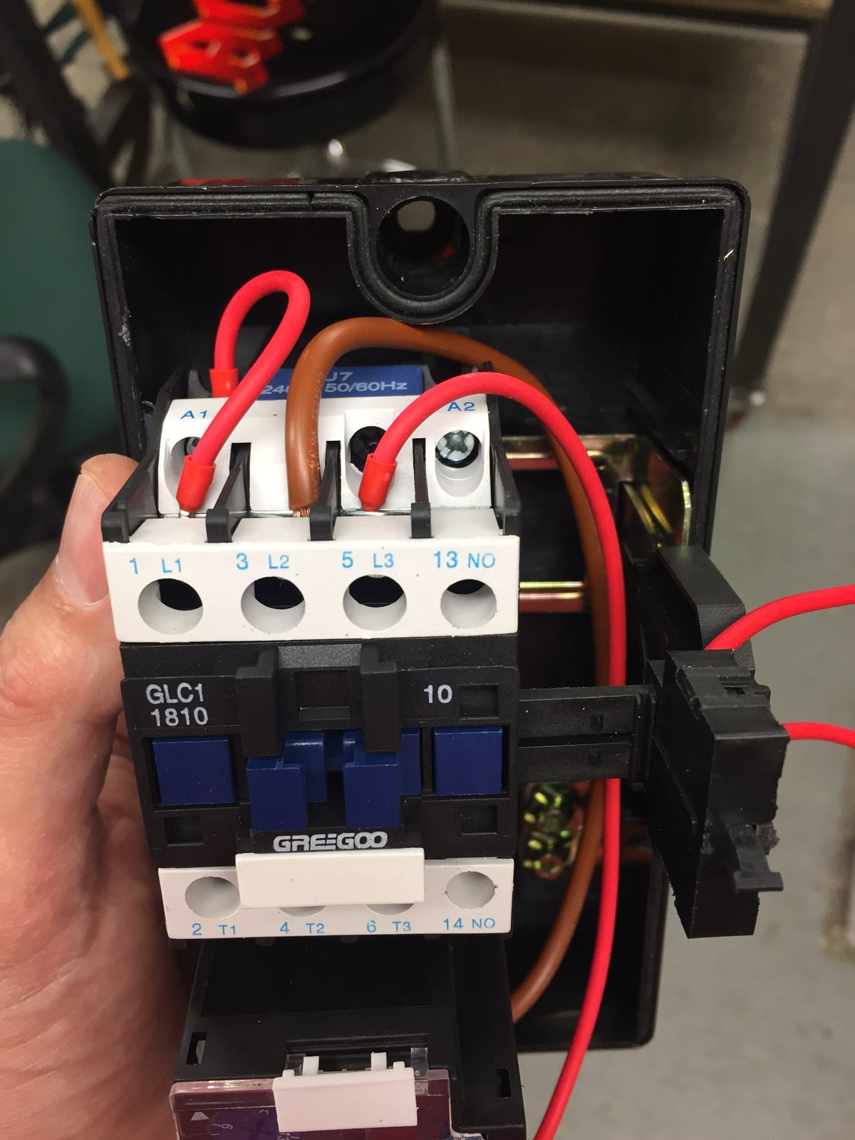

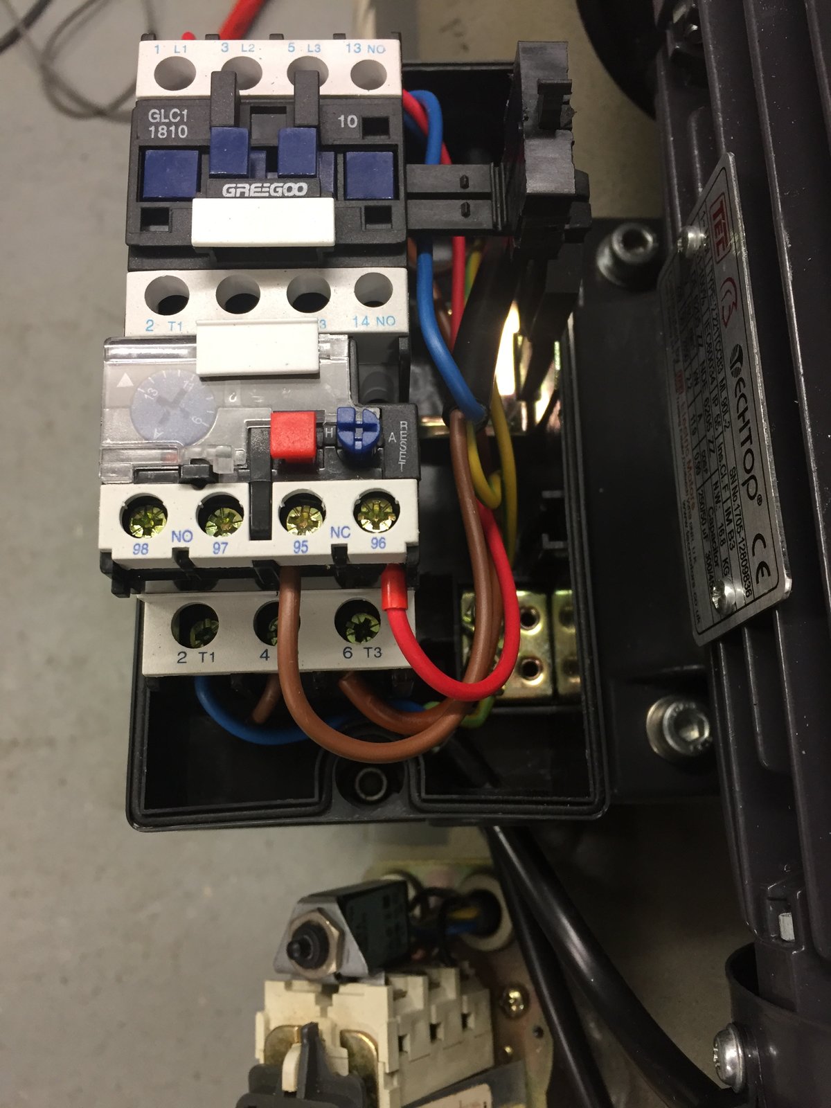

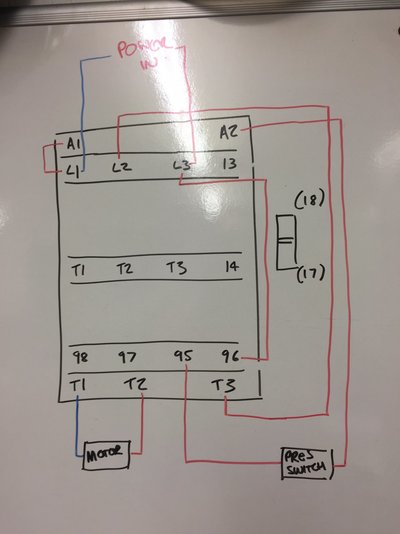

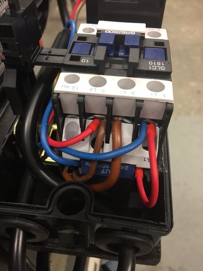

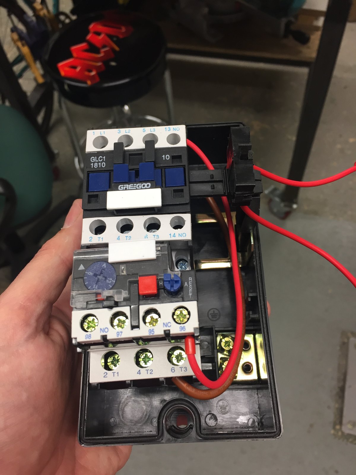

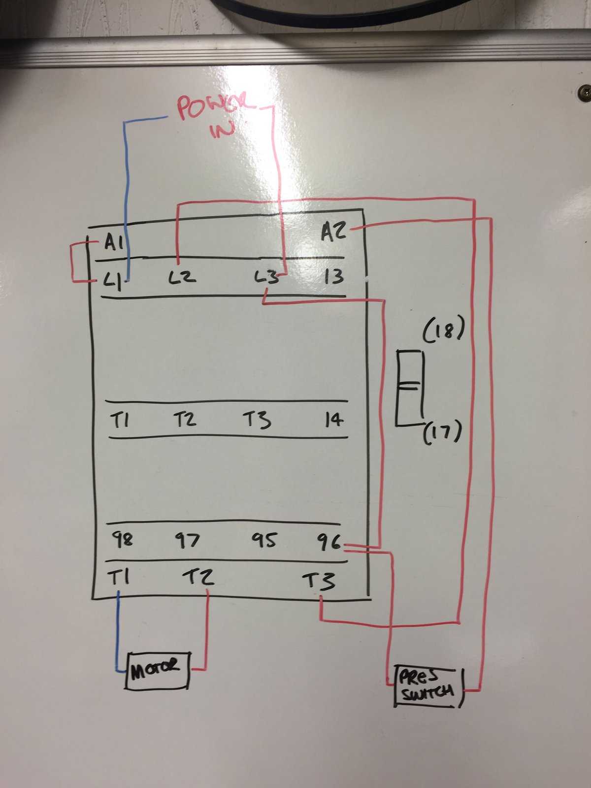

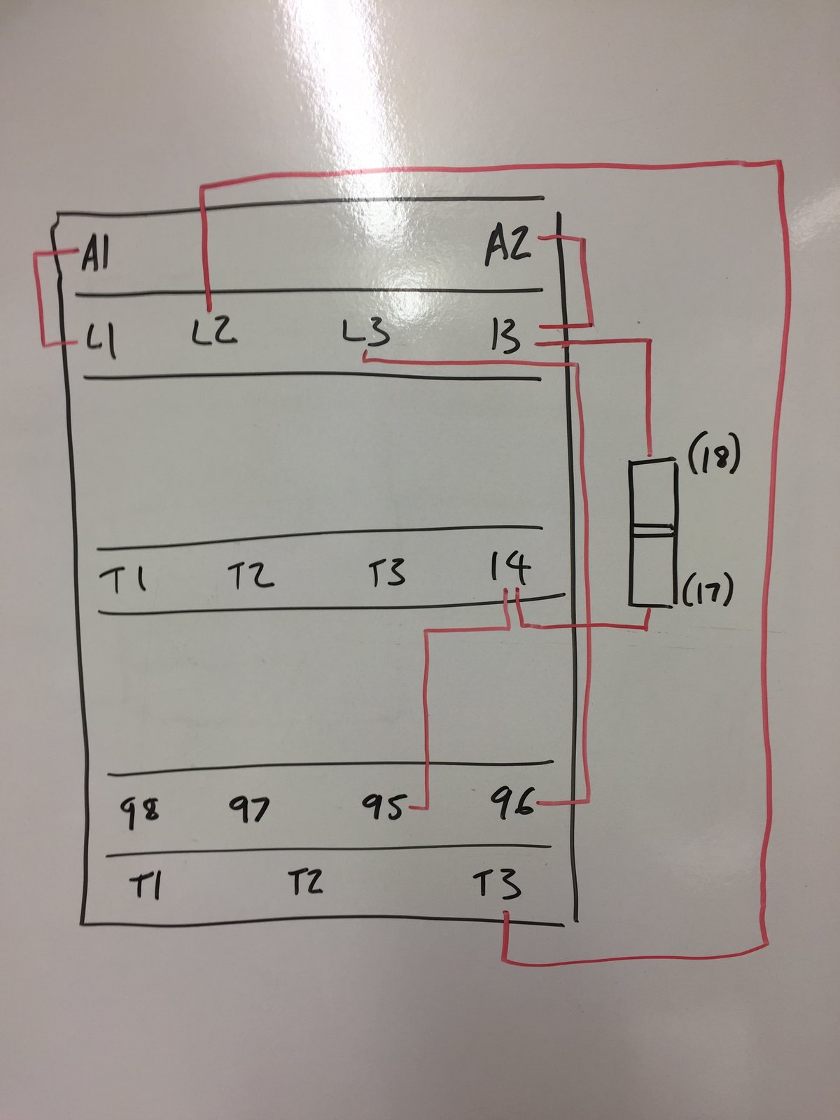

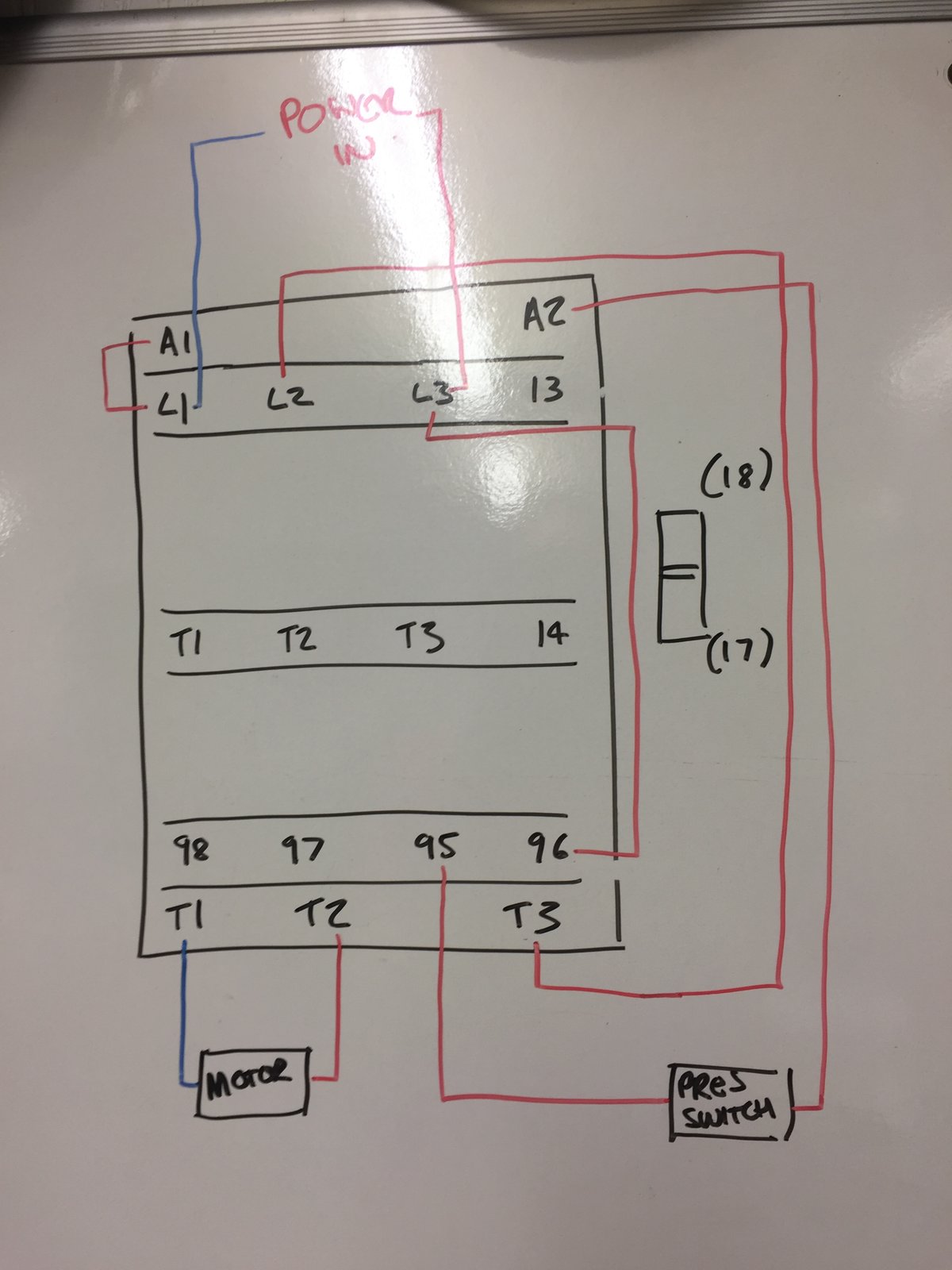

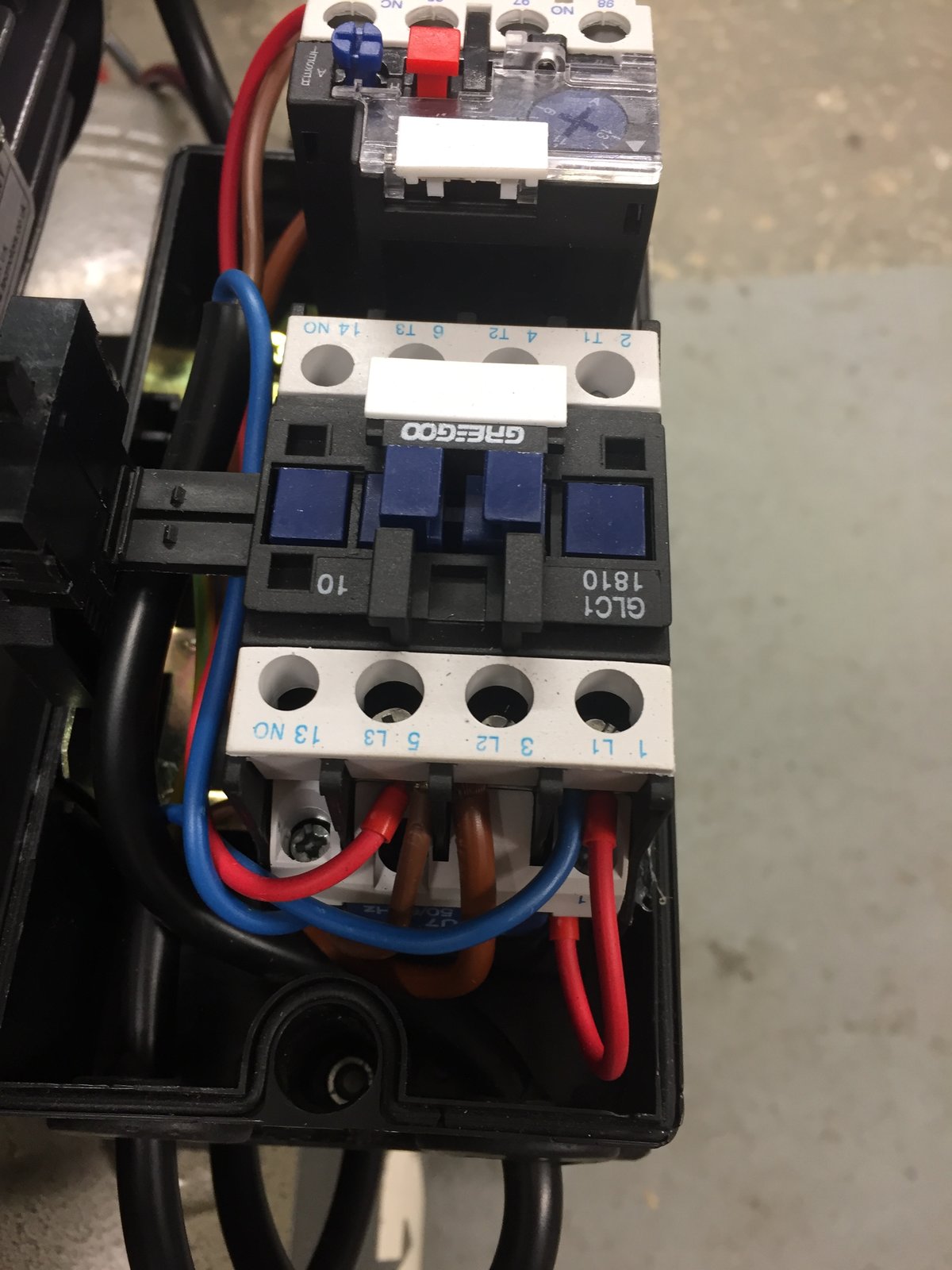

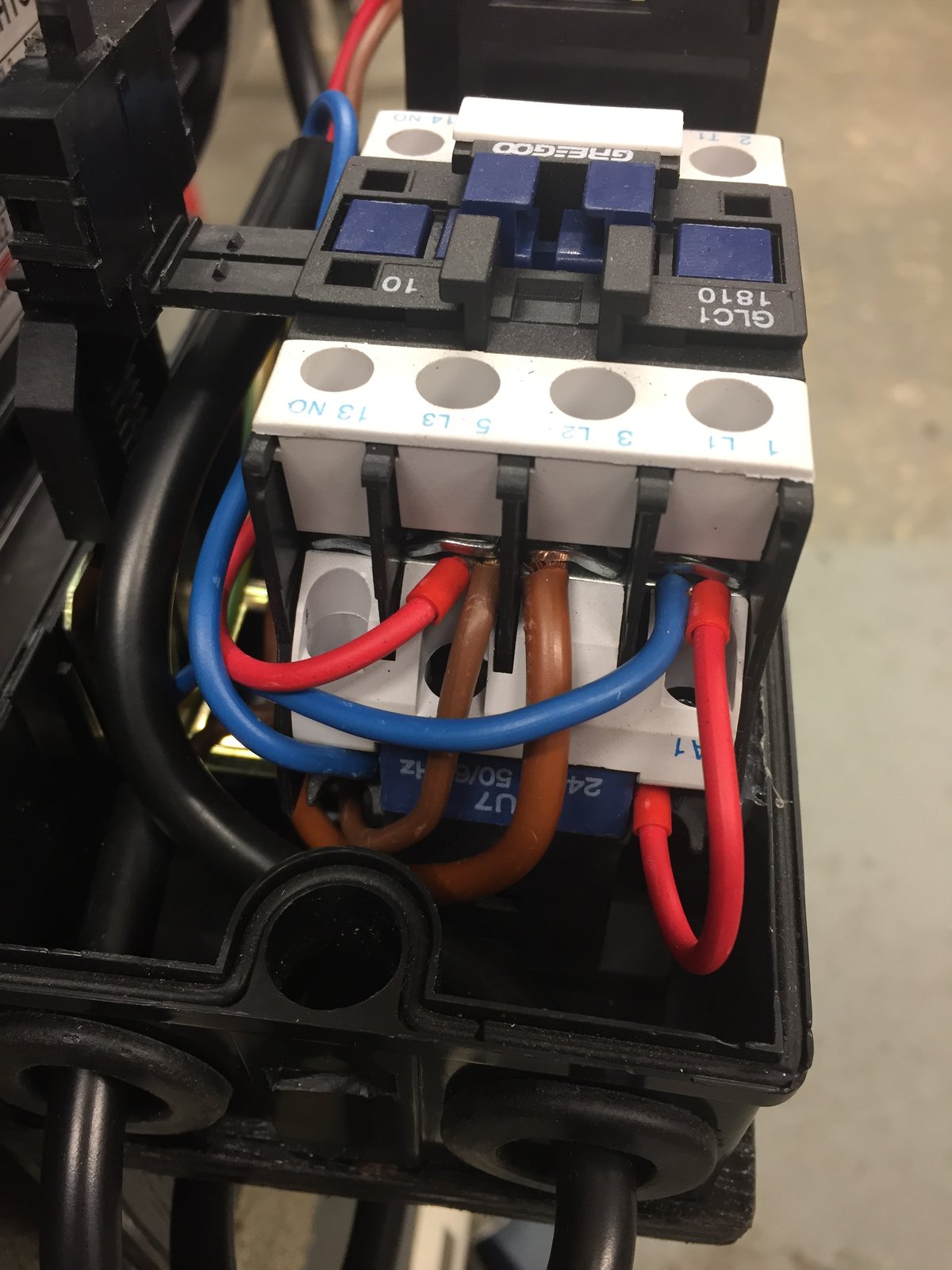

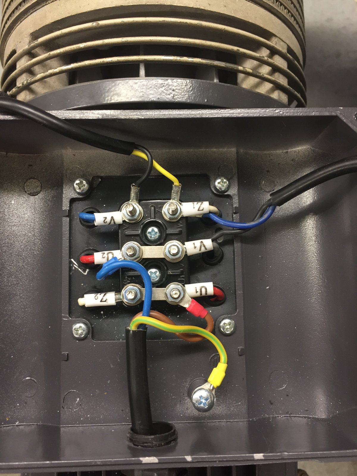

Ok the easiest way i can see going with what you have is to:
Remove wire links between,
96 to 14
18 to 14
17 to 13
13 to A2

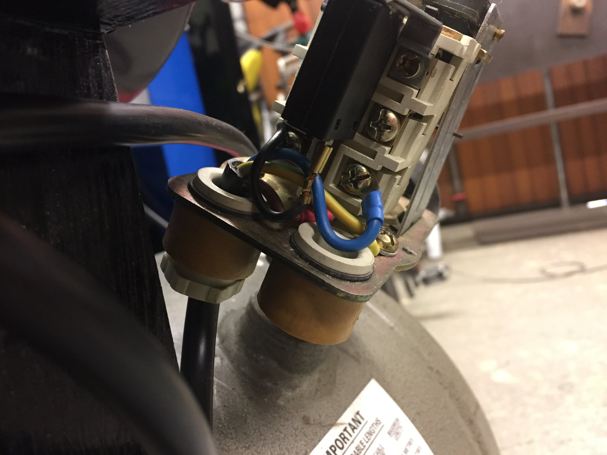

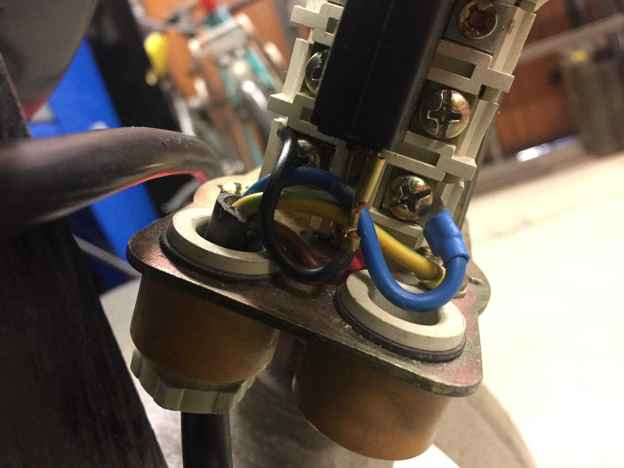

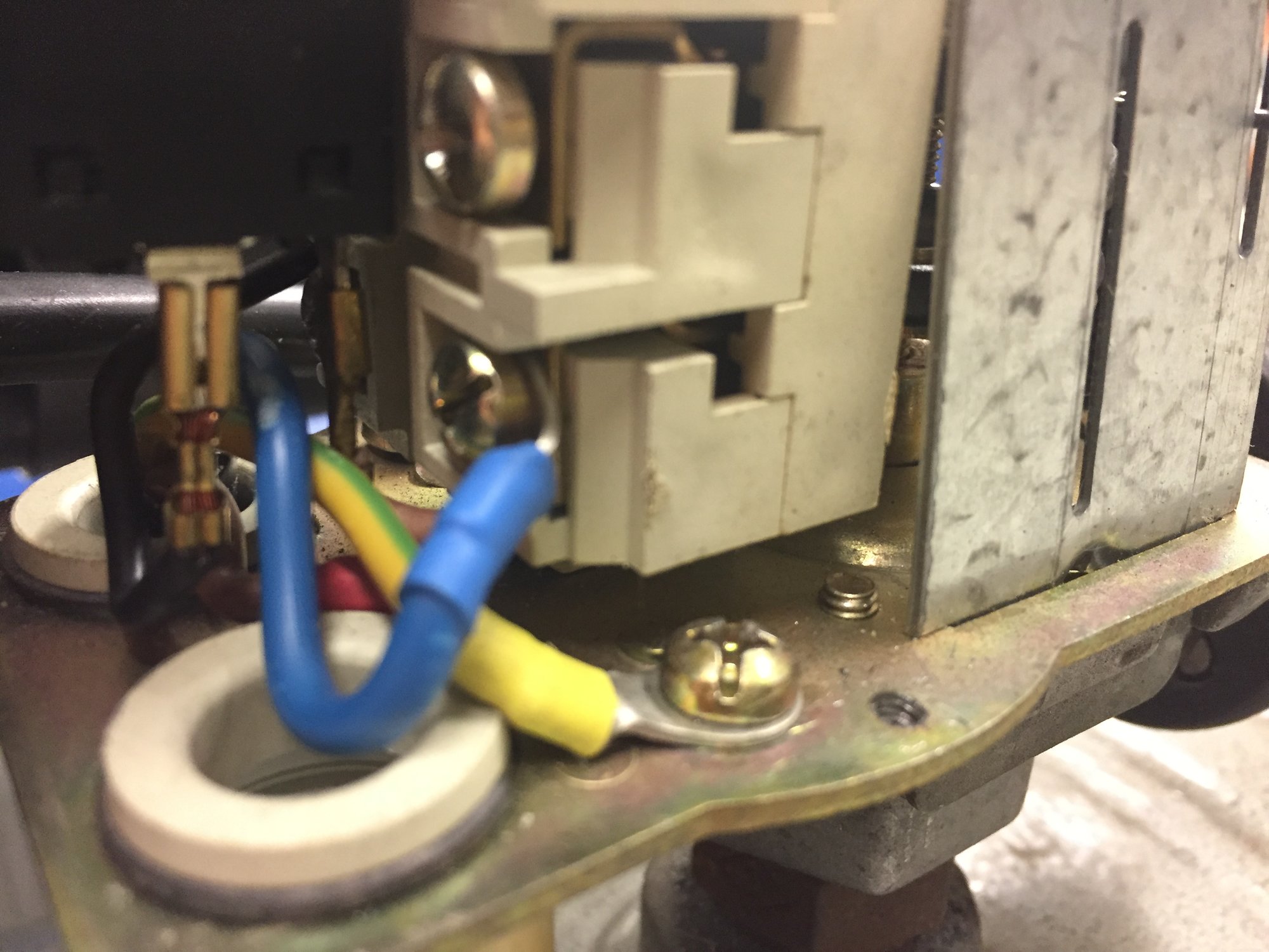

Then insert the 2 new wires from the pressure switch connected to where you previously removed either the brown or blue pair (it doesn't matter what pair you use) Between the terminals numbed 96 to A2.
Your mains in on L1 L3 and out to motor on 2 and 4 as in supplied diagram.
You will still operate the compressor as before and the pressure switch will operate the DOL Starter.
EDIT on L1 &L3
96 to 14
18 to 14
17 to 13
13 to A2
EDIT on L1 &L3
