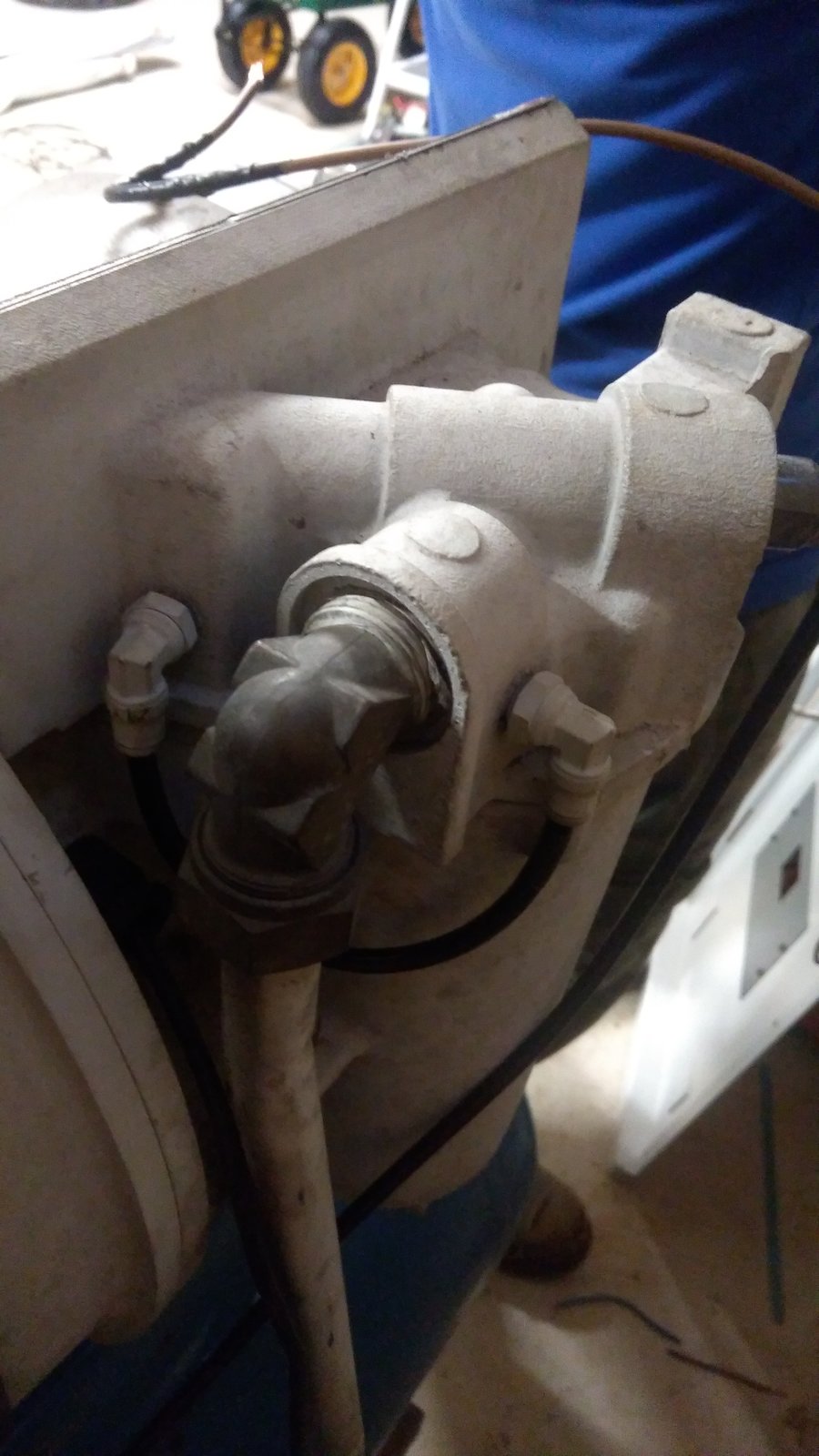

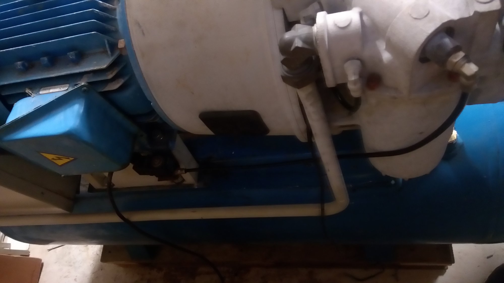

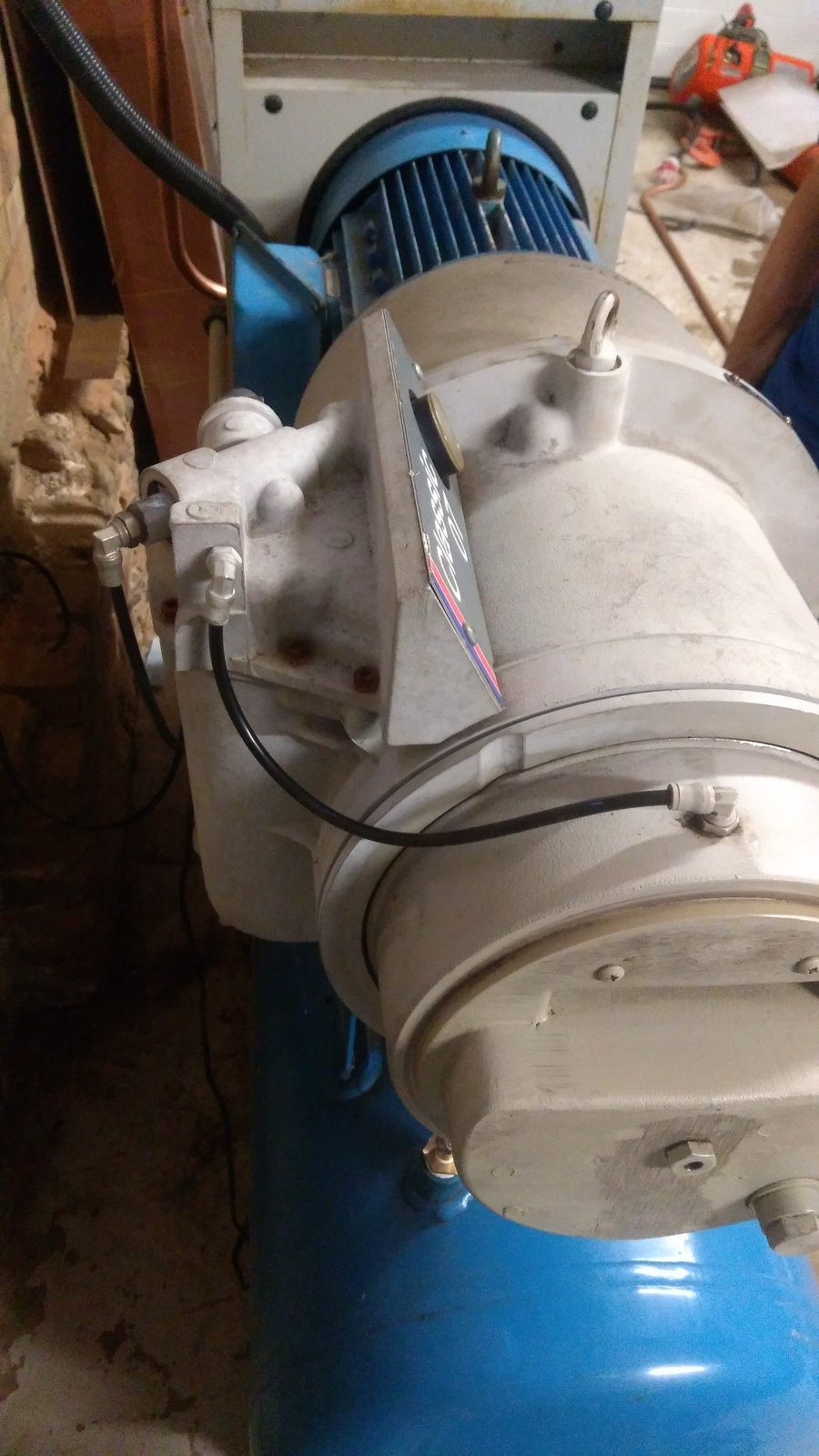

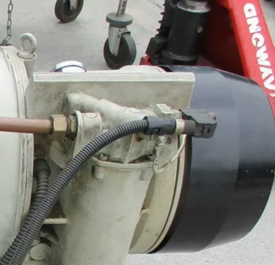

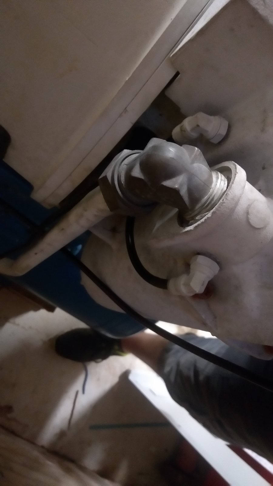

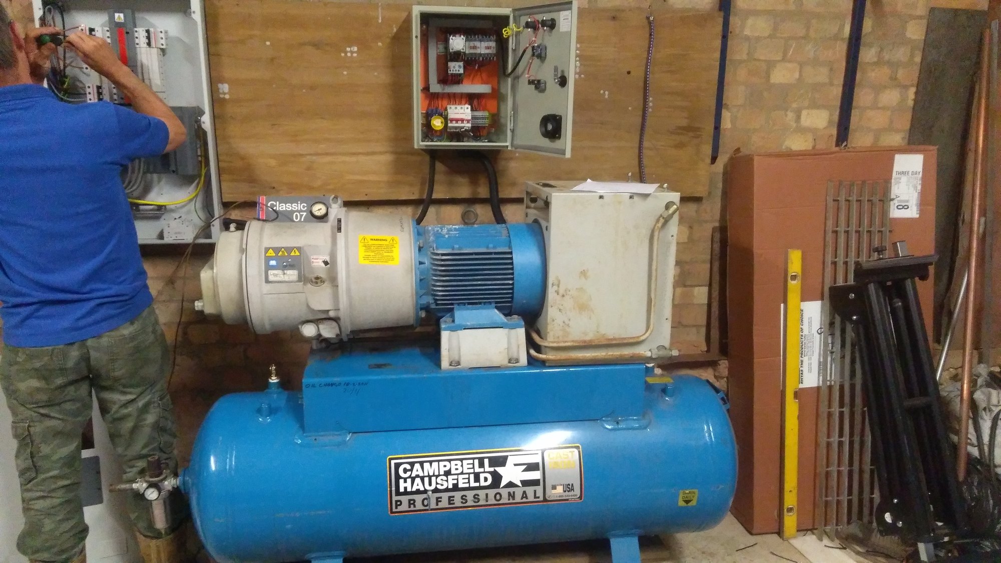

Hi guys,
Got a classic 07 hydrovane nearly up & running, just need to set up the unloader valve.
The original control box was faulty so have used a off shelf star delta.
Pressure switch is in & running at 8 bar cut off & 25psi drop cut in.
What micro bore fittings do I connect to the unloader? & Am I set up correctly at the back??
I have the star delta timer set at 3s but this could probably be 1s?
I can add loads more pictures if required. Not had much luck on line so want a resolution for any one in the future.
We have it running clockwise looking at the after/oil cooler end.
(Had to swap 2 phases after a bump start check on rotation)
TIA Martin
Next on agenda is a full oil & filter service
The tank is a 270ltr tank only 3 years old
& I think 1800hrs on the compressor when we removed the old box.
All in cost is £700 for 40cfm so far.
