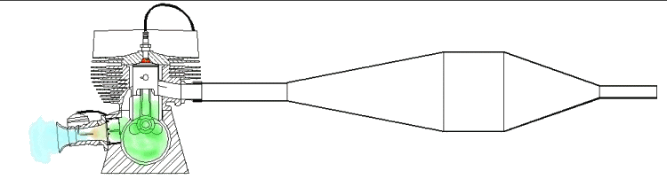

2T expansion theory. Lots of maths involved, never quite as simple as that though. Gorden Jennings & Graham Bell have writern very good books on 2T tuning which is what I always refer back to. I do have them save on my PC if anyone is intrested in 2T tuning & expansion design. Via email only as I dont want to get done distributing. I also got alot of manufactures designs saved, talk to a few builders quite oftern, its one area that has intrested me since I was a weeee lad.
BUT 2T expansion theory has moved on since then as you can now go onto mulitple stage defusers. think the KTM GP bike has a 4 or 5 stage defuser.
I understand the theory, I can deviate away from another design to suite my needs. My new design was done but a very good expansion designer who builds "Kenny Pipes" BUT was to my specs.
It can eather be called a 2 stage header pipe, or a 3 stage defuser pipe. Its beyond me this design as I can only go as far as 2 stage defuser tops.
