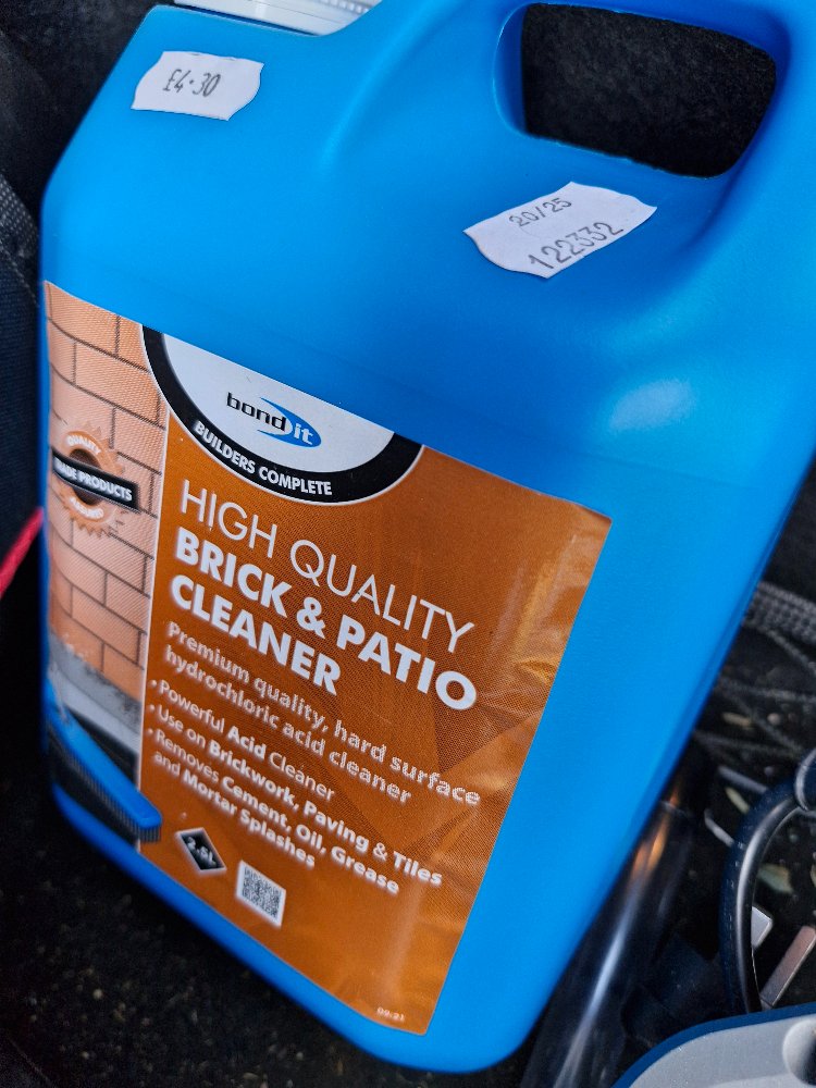

That should do it - It'll be a roughly 10% solution (data sheet says 1-10%, but density is consistent with the top end of that range). Concentrated hydrochloric acid is about 37%.
Their "High Strength Brick Acid" is 16% HCl if you can get it.
Do the instructions tell you how strong the acid should be?How many parts water should I add for a mix to dip bolts for 30 - 60 seconds before plating steps?
