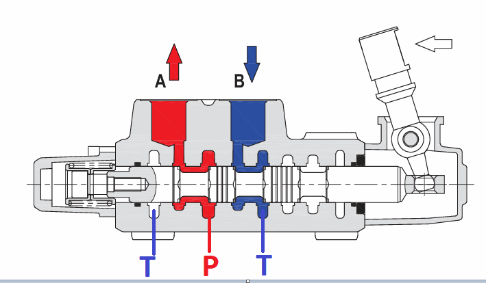

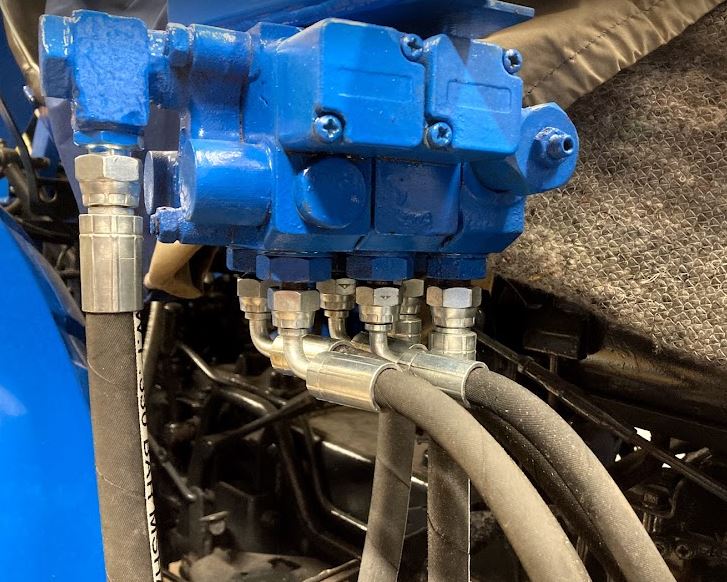

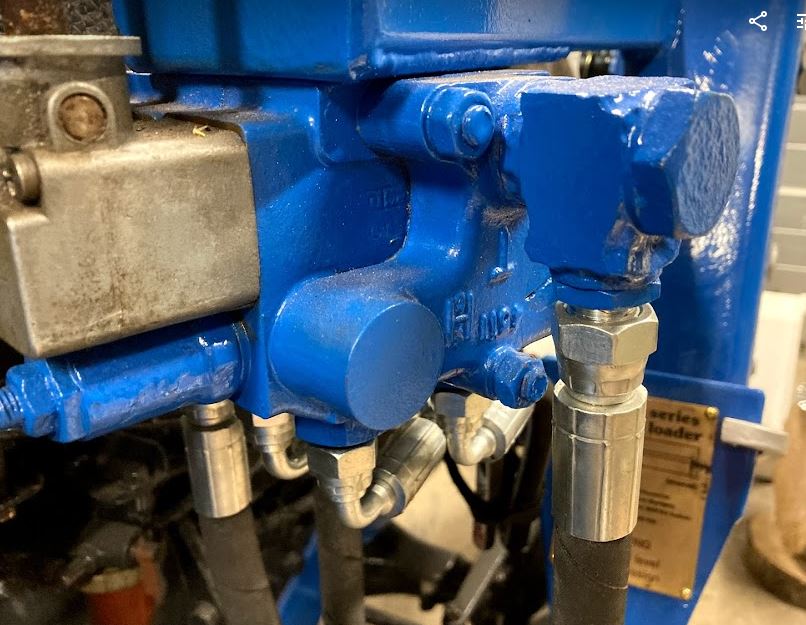

I connected the spool up to the compressor, a drawing would be so much easier but I will try and type whats happening (but its clear to see)
P port is on relief side,
lever 2 (nearest relief) pull it back, it directs air to A1 which is front port then a pop and it changes to port B1, and in reverse if the lever is pushed port B1 gets air then a pop and A1 gets air, this is different orientation from the video, they must have reassembled the valves the other way round.
lever 1 pull it back and it directs air to B2 only then forwards push it directs air to A1, (working as expected)
It would seem the valve is operating exactly like the video in regards to what I dont want it to do, why can flowfit says its working as it should?
