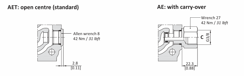

Yes it was drilled on a mill, the hole on the inside was picked up, then the cover was turned over and drilled, never had reamer the correct size but had one slightly smaller, used it and took, oh its been a few weeks a 0.2 or 0.3mm off the small OD and screwed it in with the O-ring tighter than it would be originally, the adaptor was aligned spot on to the hole so hopefully thats not the issue. But maybe I should unscrew it and make sure the o-ring is intact.Did you drill and tap the cover for the HPCO adapter?
If so, that's where I would look first.
If the adapter isn't perfectly aligned with the bore, then there is every chance that is what's leaking under pressure.

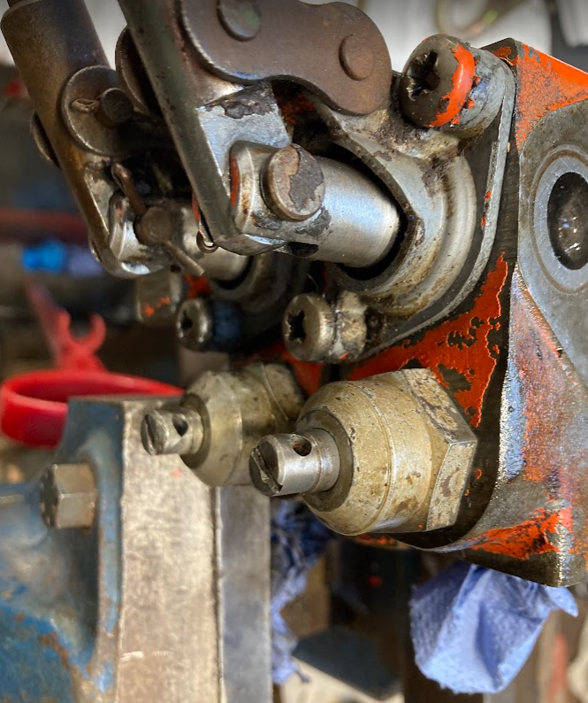

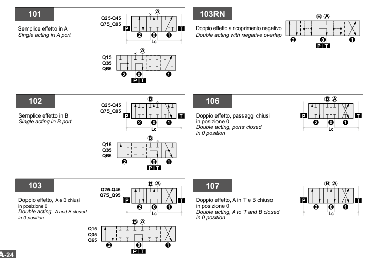

It would seem that if they are unscrewed, the rams act like single acting, probably for single acting rams, then when I screwed them in I was pumping in both direction.View attachment 503473
It's been many years, so I could be completely wrong, but I *think * those are adjusters, used for setting the spool to actuate a single or double acting ram, by altering the length of travel of the spool.
That's exactly what I expected, and for exactly the reason you describe.It would seem that if they are unscrewed, the rams act like single acting, probably for single acting rams, then when I screwed them in I was pumping in both direction.
you were spot on, the o-ring was nipped on assembly and thats where the leak path was, thanks for your help and pointing this out.Did you drill and tap the cover for the HPCO adapter?
