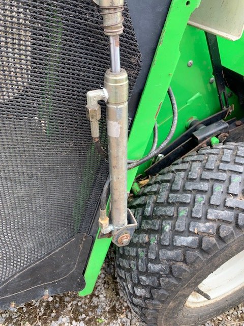

Ctop symbol shows this nicelyTypical circuits have the cylinder lines blocked when the control valve is in neutral to hold the cylinder, depends if they actuated the valve when changing the reservoir oil, unless the valve is worn and there is excessive leakage.
