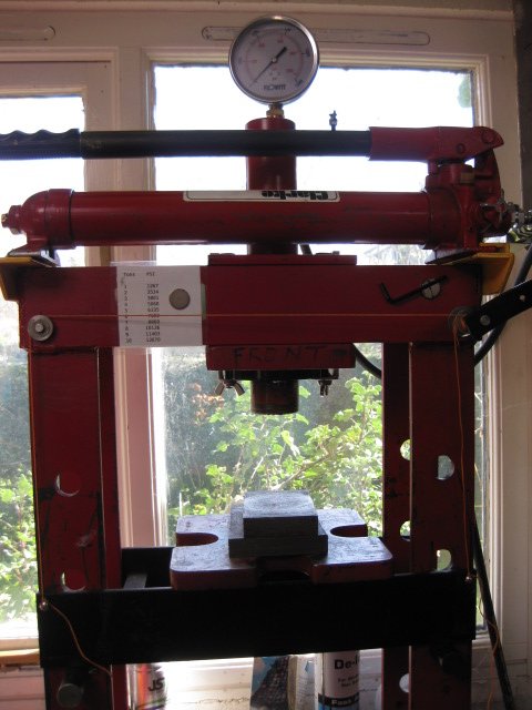

I bought my 10ton bench press from Machine mart in about 1988 and it's done me well. I mounted it on a 7 drawer roll cabinet, so I can move if necessary to work on a large item. If I were to buy again and had the room, I would choose a floor standing version and higher tonnage.
As supplied the pump unit was not attached to the press. It needed to be accessible of course but out of the way, so I made brackets to mount it
on top of the press:
Some more modern presses and particularly higher rated ones mount the pump to the side with the handle pointing
towards the operator, but I would find that very inconvenient and it can limit use of longer objects side to side. I've also added a telescopic
extension to the handle to reduce the force needed at higher pressure loadings.
The ram units on these presses can be moved sideways. To avoid the need for spanners, I welded plates to the top mount to prevent the hex headed
bolts rotating and replaced the hex nuts with wingnuts. Now easy to move, but I rarely seem to have the need now.

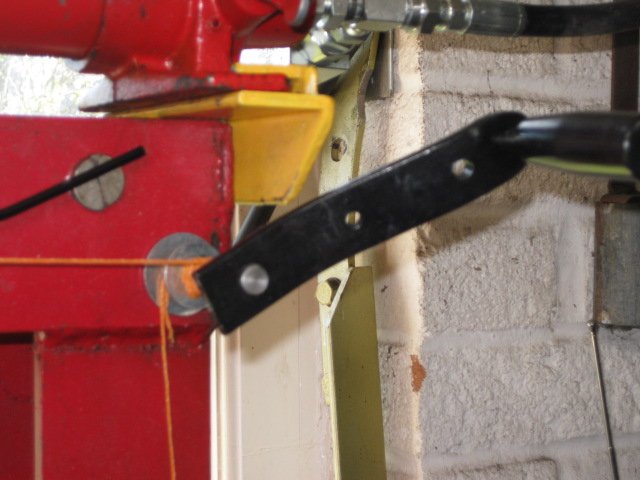

I always found it difficult to adjust the plattern up and down (it's heavy!). So designed my own simple winch arrangement. Thin
polypropylene builders line runs over 25mm dia pulleys to the winch "drum" which is just 10mm bar. Since there are 2 lines on front and back
(to keep the plattern horizontal when lifting), there are "repair washers" to keep the lines separated on the drum:
Works really well. Some larger presses do have winches, but they generally block access to put long items through from the side.
Many modern presses of this type come with tonnage gauges. Mine didn't, so bought a gauge from Flowfit (had to calculate a psi to tons chart) and
tee'd it into the hydraulic line. At the same time I bought an air over hydraulic foot operated pump from Vevor (cheapest I could find) and tee'd
it into the standard ram hose via an on/off valve. No more exhausting hand pumping just to move the ram down. When I want fine ram control, just
close the on/off valve and use the hand pump. All works really well.

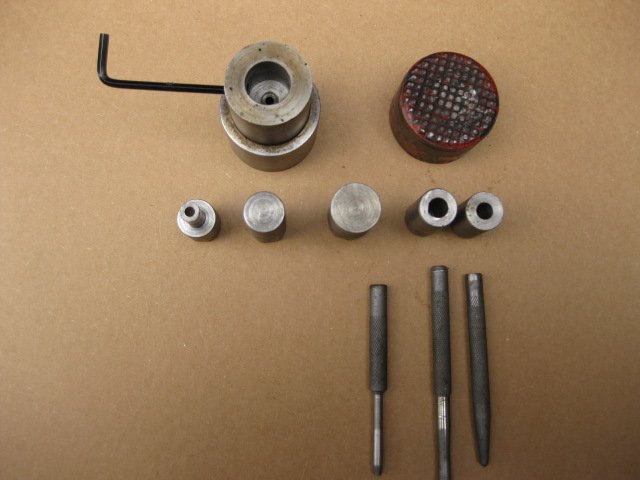

The press originally came with a common serrated ram fitting and one machined multi-dimensioned. I cut off the smallest spigot and drilled this fitting
to take any other sized tooling I need:
Oh, and of course I have the usual box of odd bits of pipe, bearing races, etc, but frequently not the right size for the job in hand, but I
do have a lathe.

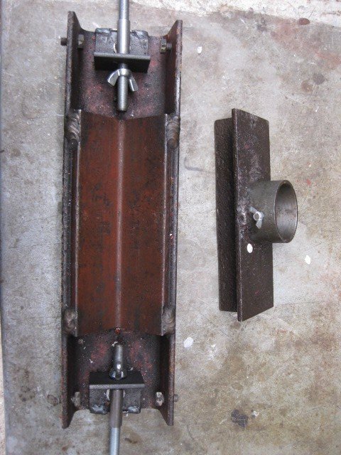

I have a 3in1 shear/pressbake/roll for processing sheet material up to about 1.2mm thick but for occasional bending thicker material use this
crude arrangement:
which fits between the press uprights and works surprisingly well.

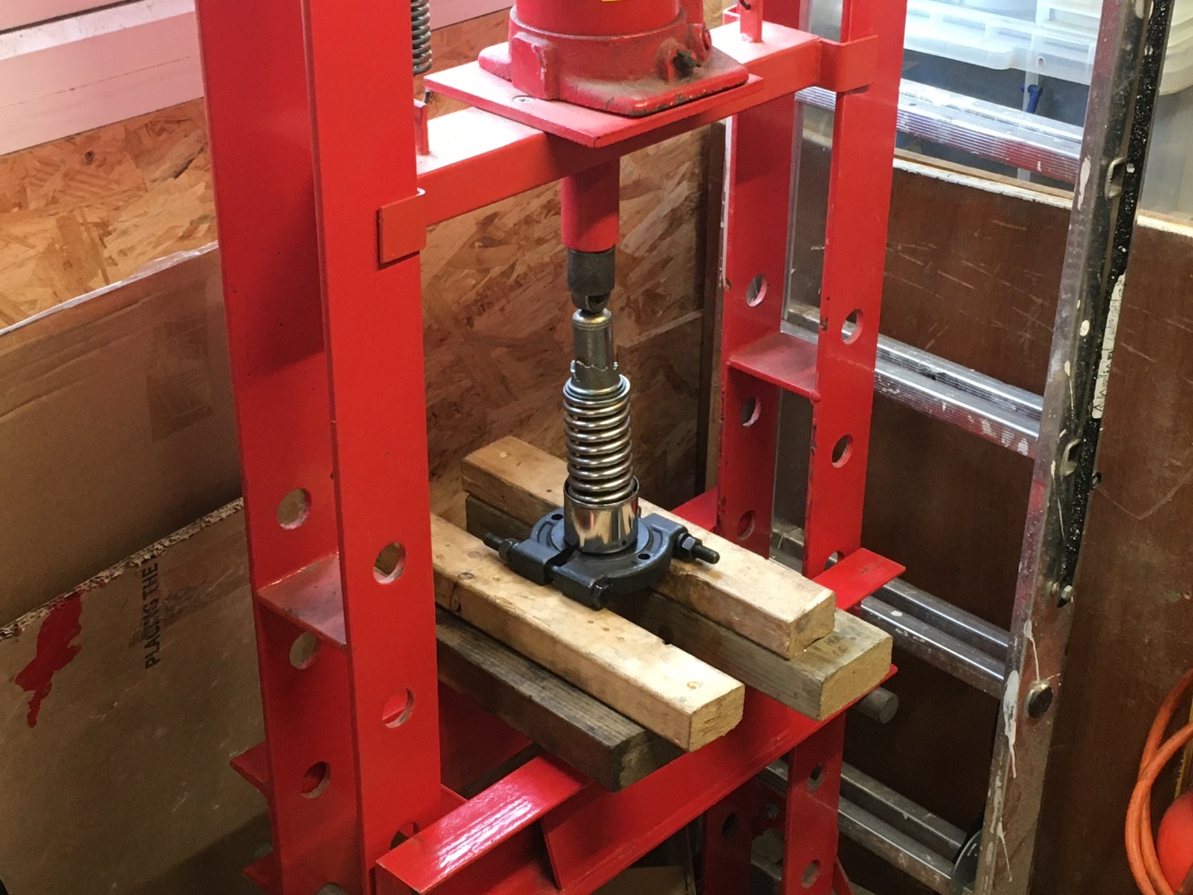

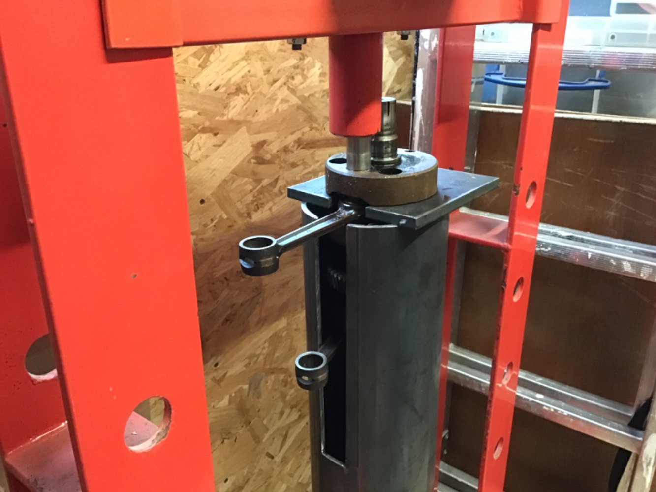

Was looking at some of the gear I use and it suddenly dawned on me that its a lot older than I am , The Laycock 65 ton press serial number 689 is 1940`s as are the two old oil dispensers. The oilers were at another yard as was the press and still in regular use, will relocate the press and carry on using it.
Beast of a thing for pressing in bushes and bearings , before I built my hydraulic press I also used this thing to fold 1/2" steel in a v block...
