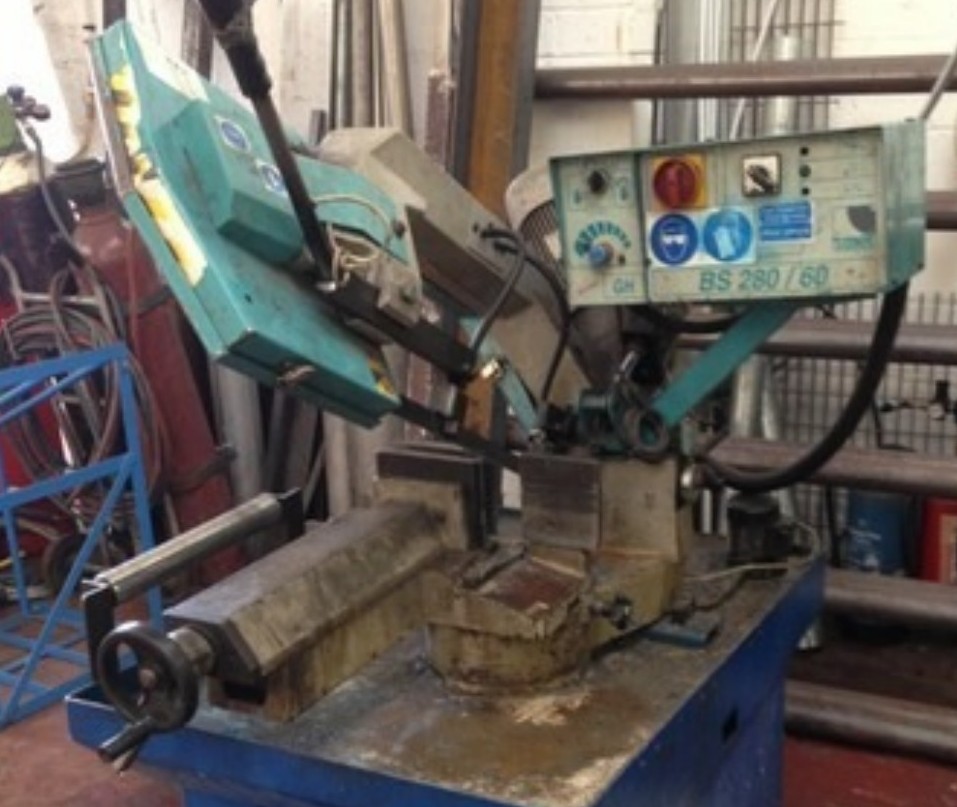

Some do, some don't, mine doesn't, in fact none of the ones I have owned had them.saws with coolant have brushes to clean the blade before it reaches the wheels.
I didn't mean to sound snotty, just some do have them and some don't. My friends auto saw had circular wire brushes but as said none of mine have had them, current saw is an Imet 280/60, brilliant sawI stand corrected!
Sorry hood, no snottiness at all. The only saws I've used with coolant systems have had brushes. Tomet saws. So I do now stand corrected!I didn't mean to sound snotty, just some do have them and some don't. My friends auto saw had circular wire brushes but as said none of mine have had them, current saw is an Imet 280/60, brilliant saw

See i cut all my alu dry. Different ways I suppose but I find alu sticks in the teeth more so with it than without.

Thing is doing so would be fixing a problem that isn't there. I fitted the coolant system with its own switch so I just turn it off for cutting aluminium. It doesn't clog if it's run dry and alu is soft enough not to worry about causing wear to the bi metal blade.How about fixing a brush (try it with something like a toothbrush?) that cleans the blade before going through the metal?
Dunno. It might not be the "done" thing but it's not causing me any problems. I don't cut any hefty gage stuff mind. I'd imagine thicker stuff could get hot without coolant and possibly transfer heat into blade?? The thinner gage tube, box and flat i cut doesn't get chance to get warm before the blade is through it.Fair enough, I thought ali was not very good to cut dry but it's not something I have any experience of working with.

hey all ) so ive put the adjuster on LL and now its ripping through plate much faster. Appreciate all the info on this thread, very glad I started it.
There is one more thing about this saw, its seriously loud. Is there anything I can do about this? Id love to wrap the motor in a blanket but of course I cant do that. Anyone have other suggestions? I realise this probably is impossible, but, ive been surprised before, and you just never know.
