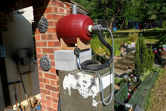

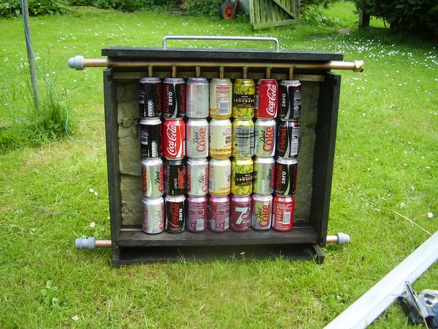

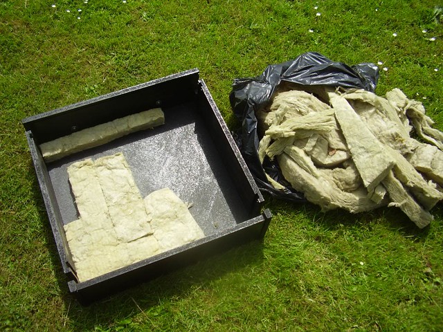

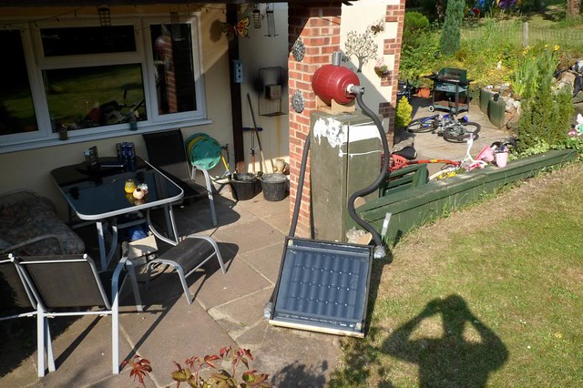

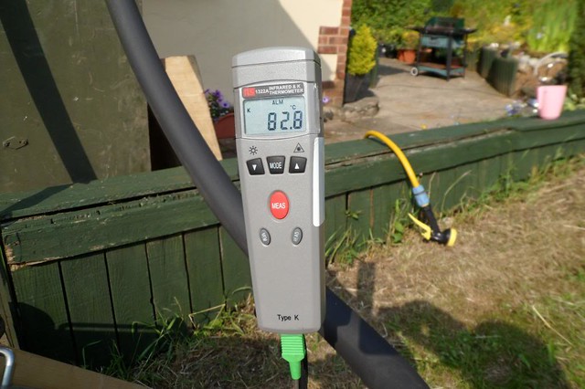

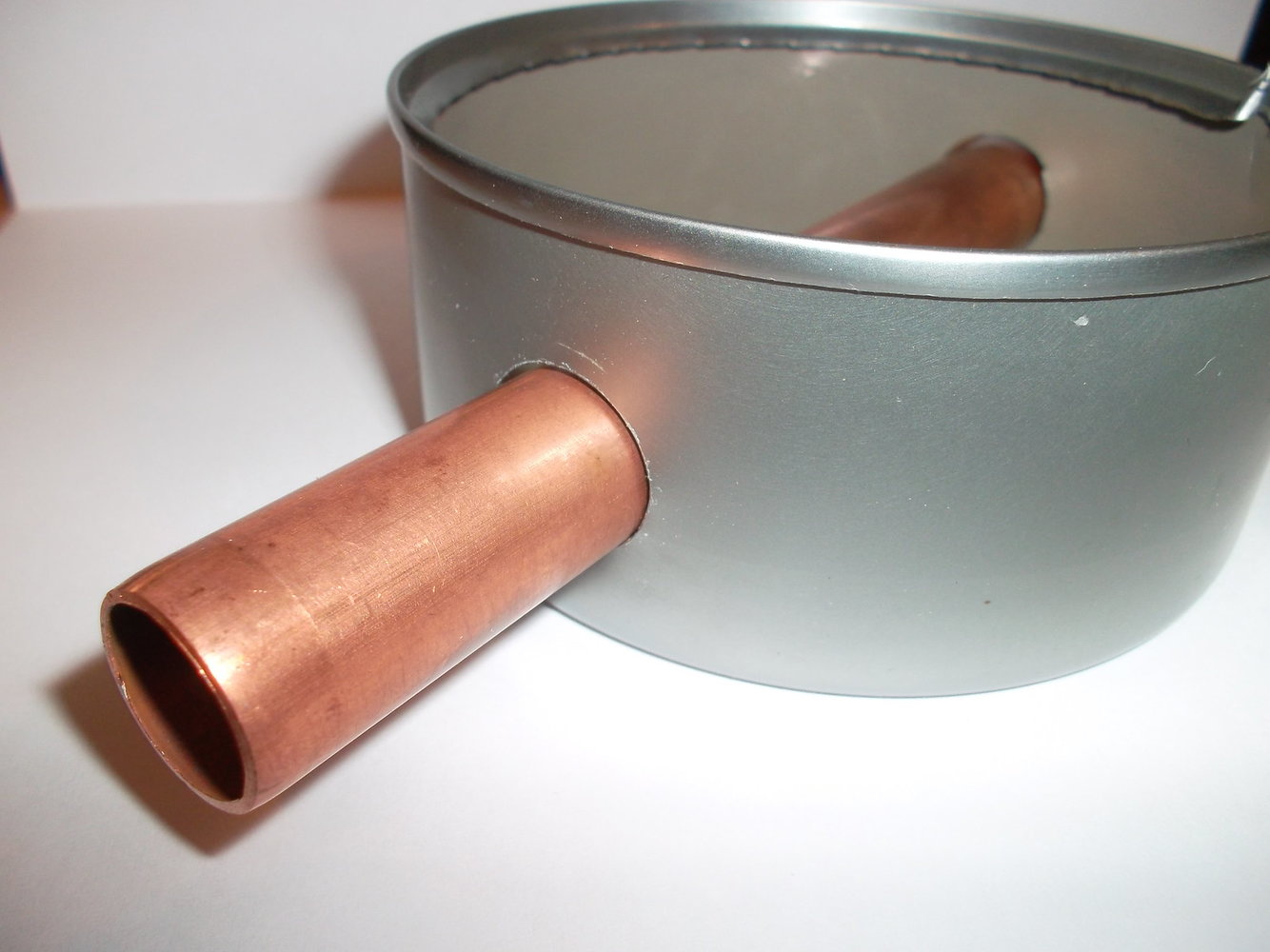

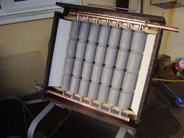

Wow, care to explain this thing ?Another rabbit hole I went down. Just to show the kids what could be cobbled together from junk:
I call 50degC above ambient from a 4' square panel a win.

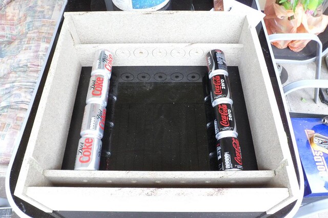

Could the aluminum can have a surface treatment/coating (besides the label/ink) that could limit conductivity? Maybe scour the surface with a scotchbrite pad or something?With this one, thinking if I open up the bottom of the beer can and expose it to the electrolyte, that might help?
Loved that.We won't go into my tuna tin solar collector experiments. Showed huge promise until the big corporations paid me to stop working on it...
