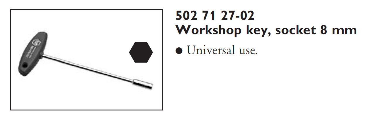

P PDJ355 Member Messages 50 Location uk Highlands Nov 5, 2017 #21 It’s a 8mm bolt on this saw unfortunately
The_Yellow_Ardvark I'm a citizen of Legoland travellin' incommunicado Messages 20,284 Location Going Away. Nov 5, 2017 #22 My Halfords deep 13mm/ M8 deep socket fitted into my Husky.
P PDJ355 Member Messages 50 Location uk Highlands Nov 5, 2017 #23 Try’d a deep 8mm teng 1/4 drive but it wont locate onto bolt so guessed it was to thick as no play to locate on top of
pedrobedro Man at Matalan Messages 13,103 Location CX near Chesterfield Nov 5, 2017 #24 8mm socket onto the bolt head under the fins then poke the 1/4" extension down the hole in the fins, they must have got them in there somehow. Is there a bevel on the socket, I had to grind the end flat on one to fit.
A andymfell Member Messages 195 Location cumbria uk Nov 6, 2017 #25 the official tool is a WIHA 8mm T handle socket
R robinj66 Member Messages 42 Nov 8, 2017 #26 you should be able to strip the machine down completely with one of these - http://www.ebay.co.uk/itm/Plug-Spanner-Socket-Tool-Fits-HUSQVARNA-K750-K760-/390458569991
