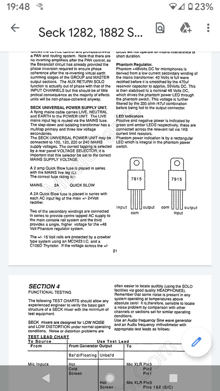

Won an old analog mixing desk for a pittance.
To big for me right now so cleaning up the internals and making sure everything works as it should is a winter project
The downside
No power supply.
Needs a 6 rail psu.
See schematics below.
Seck 1882
Anyone have any ideas that might do the job.
Company makes replacements but none available and haven't heard back from them yet .
