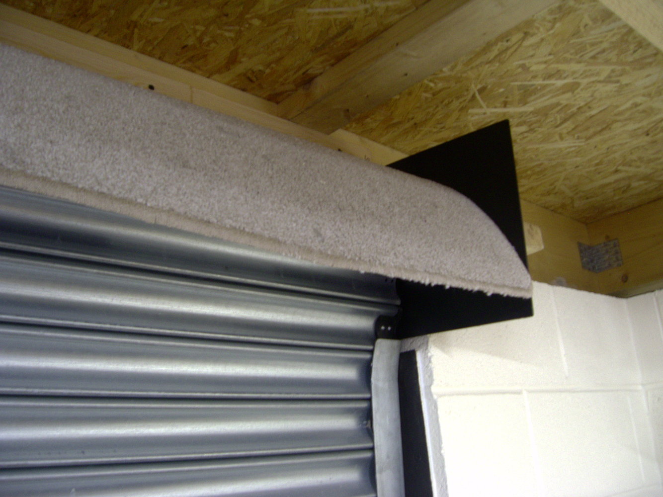

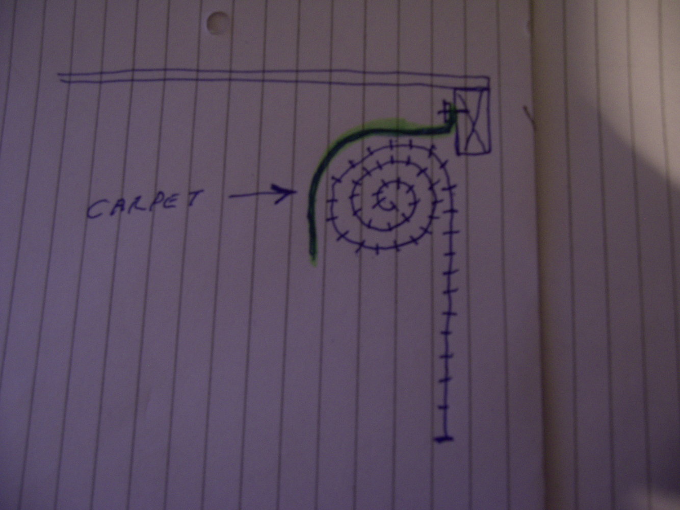

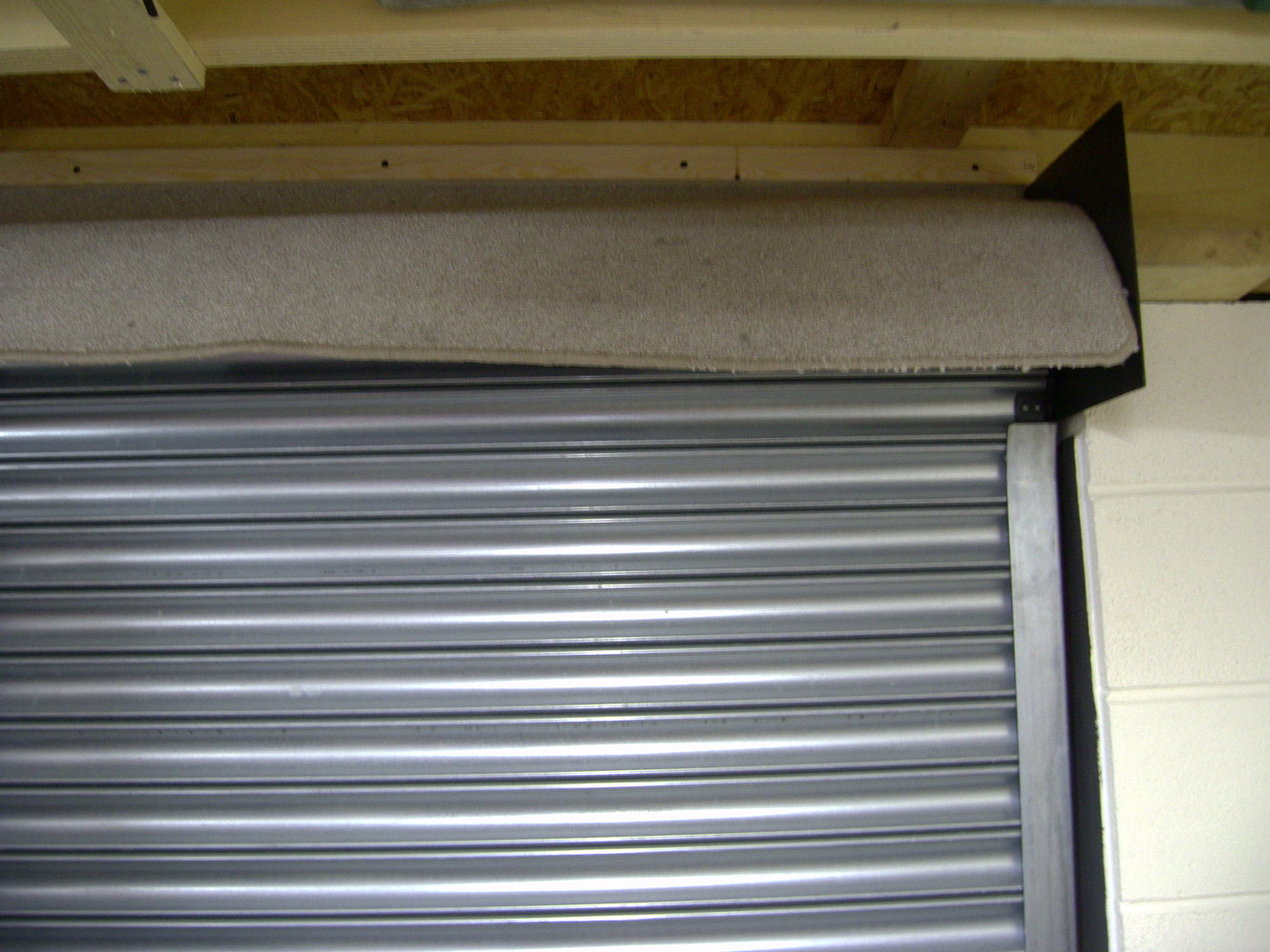

Side brushes, yeah. Just what I need to complete draft exclusion on my rollup door. I attached rubber backed carpet to a batten and installed it on the header over the door. Thanks for the tip about brushes being available at Screwfix.Here are some photos of my solution for eliminating overhead draft.
View attachment 388972 View attachment 388973 View attachment 388974
Thanks for that yes you had a good idea there with the carpet.
My roller shutter and ceiling are not ideal for the carpet idea though so I'm trying to fit a brush draught excluder along this gap externally which should be effective.
Trouble is this is not going to be easy and involves grinding lots of render out of the way, making bracket tabs and arc welding overhead which I haven't done before
