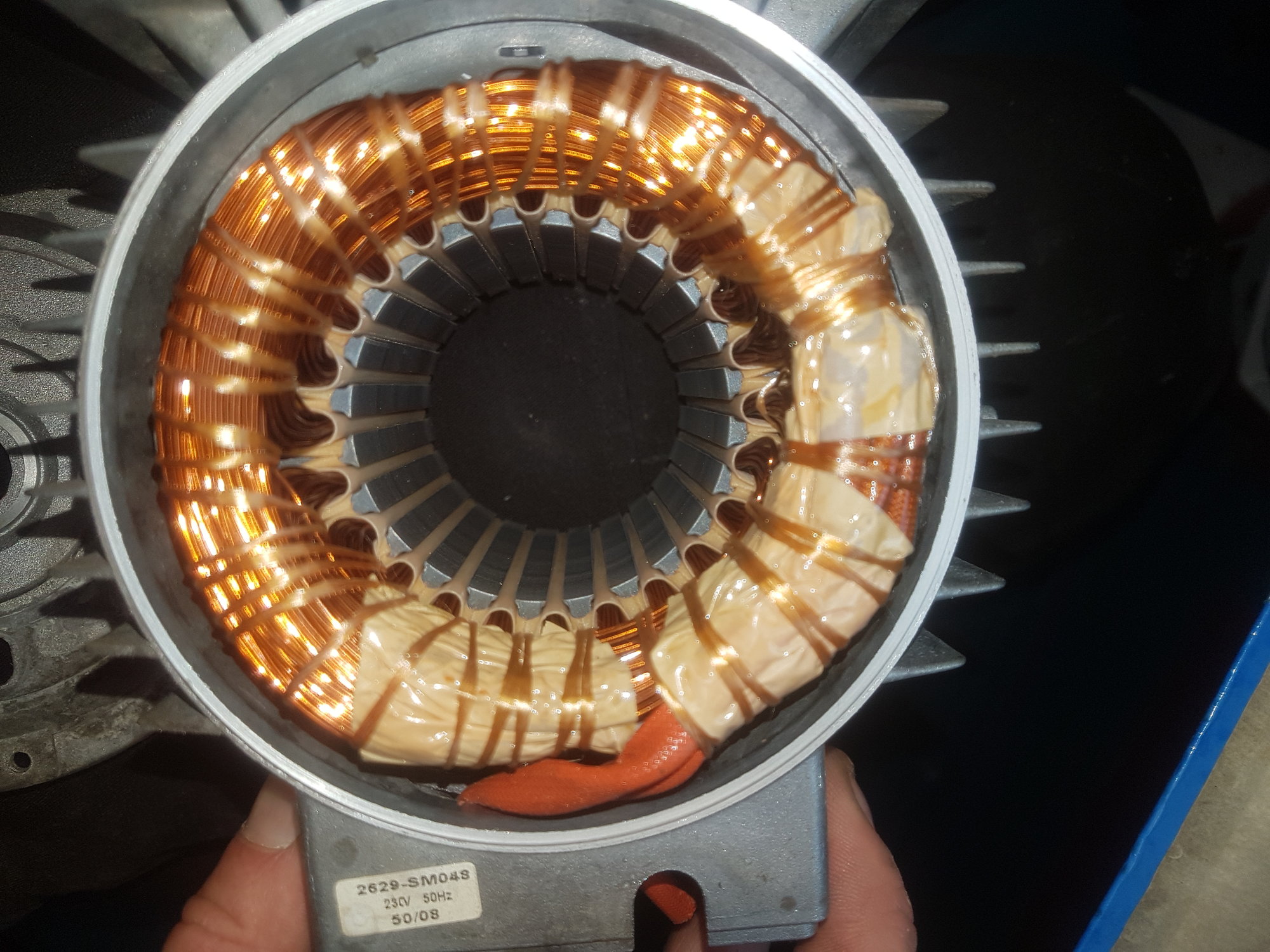

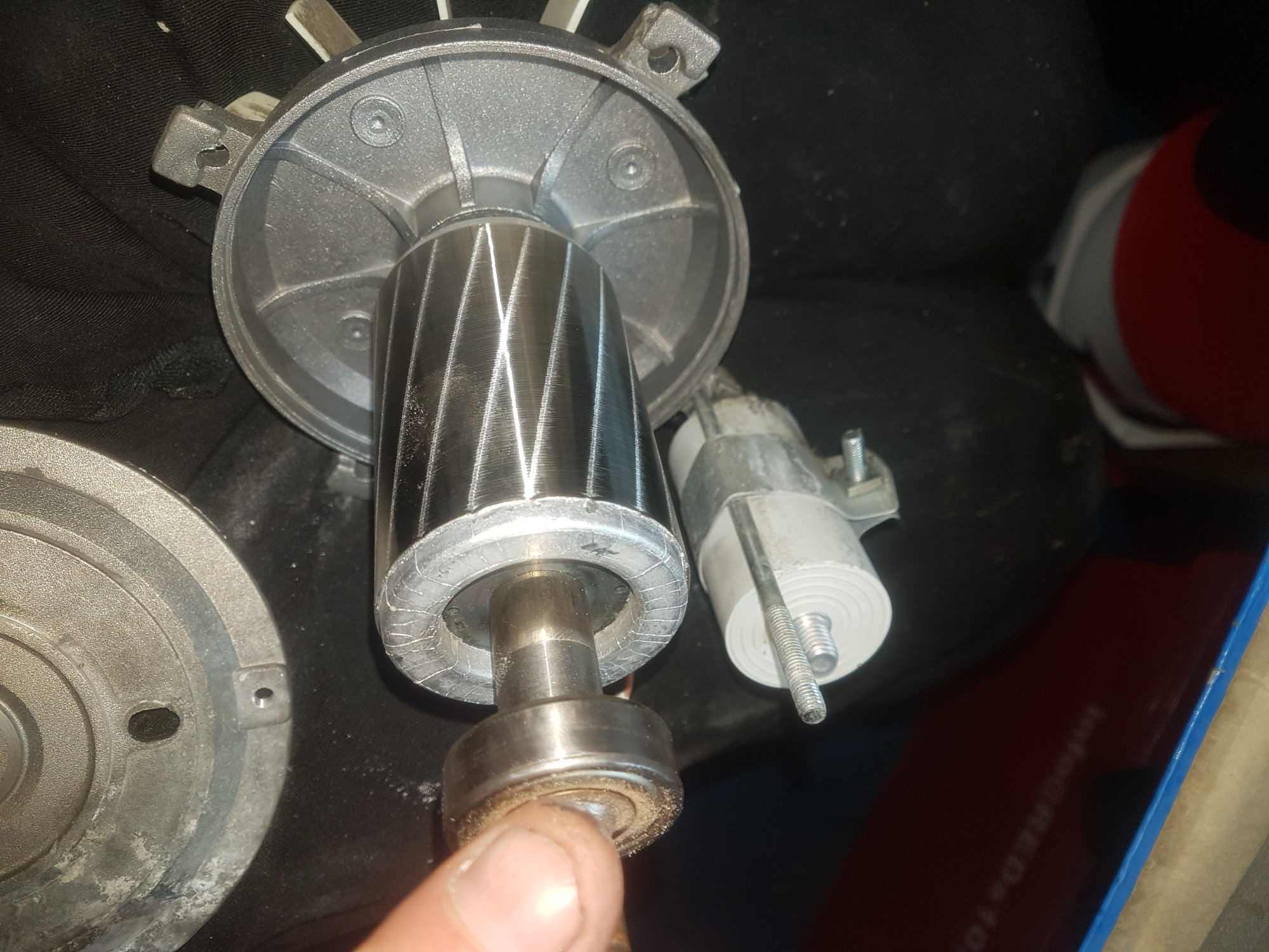

Oh I forgot now I will have to check Monday when I get back to workHow much and between which ends?
it was merely a whiff I pulled the plug before much smokeYou might be lucky but once a motor starts to smoke it's life I going to be shortened as the insulation has started to burn away, then the coils start to short reducing the resistance, causing the heating effect to increase
@JulieandTony do those extra resistances tell you anything extra6.1 black-white
1.5 red-white
8.2 brown-black
12.7 brown -red
Ok, so it probably won't reverse in that application, but I assume it remains multi-speed; unfortunately, whatever way it was used, the multi winding arrangements don't give an obvious solution for the correct connection for direct mains running.
