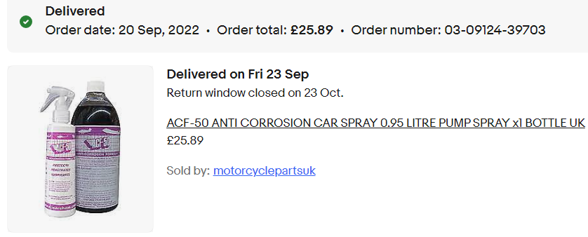

If anyone knows the answer to these re: ACF-50
What's it like to weld near, 6-8 months after applying?
How much would you expect to use coating inside chassis cavities only, on a MWB Transit?
100ml?! I'm close to buying 2L of slightly out of date stuff for £40, and simply carpet bombing the cavities. Sounds like it won't be very volatile by next spring/summer for welding. Do you think 2L is overkill? There is quite a lot of sill/box section and it really is rotting like a pear
I generally use a gallon on most vehicles.100ml?! I'm close to buying 2L of slightly out of date stuff for £40, and simply carpet bombing the cavities. Sounds like it won't be very volatile by next spring/summer for welding. Do you think 2L is overkill? There is quite a lot of sill/box section and it really is rotting like a pear
I've given my recipe here before.what do you pay for it in the states ? its like £25 a quart here
