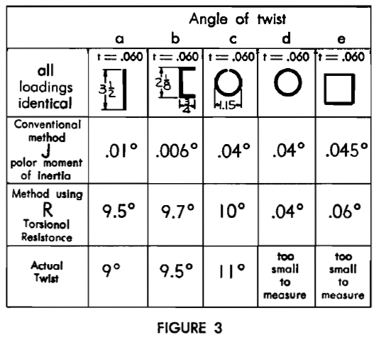

ive never found a situation where having more related knowledge has hindered my efforts...reading the book may not help with this frame as it looks naff from the start, but it cant hurt the attempt at re-making or re-designingI don’t think reading a book will help stop an angle iron frame like that from twisting. Outer frame as a minimum needs to be c section or box.
