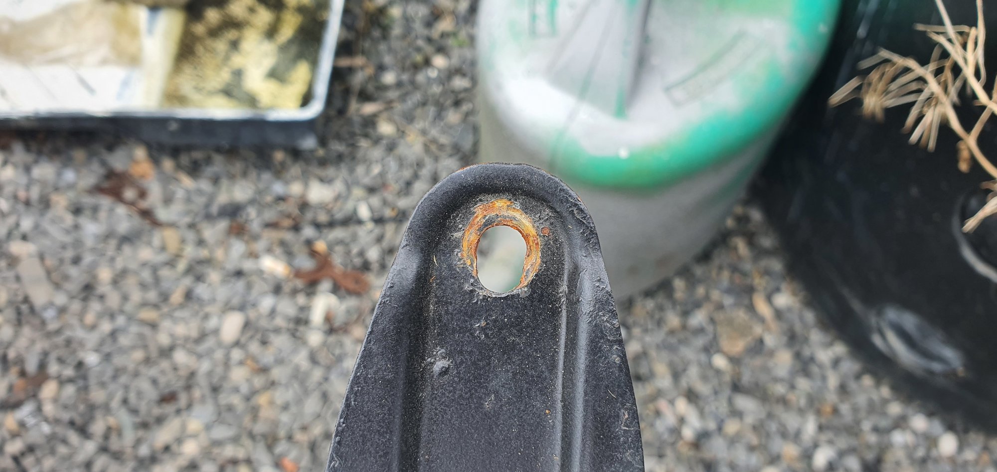

C Cosantoir Member Messages 584 Location Ireland Jun 28, 2021 #1 I feel that the answer may be use 2K primer and paint. But this piece I repaired over all is okay but where the bolt bolts it in places it's causing rust already. How can I prevent this?
Onoff In the land of the unfinished project I am King! Messages 13,733 Location Sevenoaks, UK Jun 28, 2021 #2 Liberal dose of copper slip or aluminium anti seize paste, grease etc?
B bricol Member Messages 7,462 Jun 28, 2021 #4 Use a washer - hopefully the washer stays still, rather than rotating and scraping the paint off.
steveo3002 Member Messages 8,076 Jun 29, 2021 #5 will happen with most coatings where the bolt touches , yes 2k would be tougher id go with a washer and dab or grease or waxoyl under the washer
