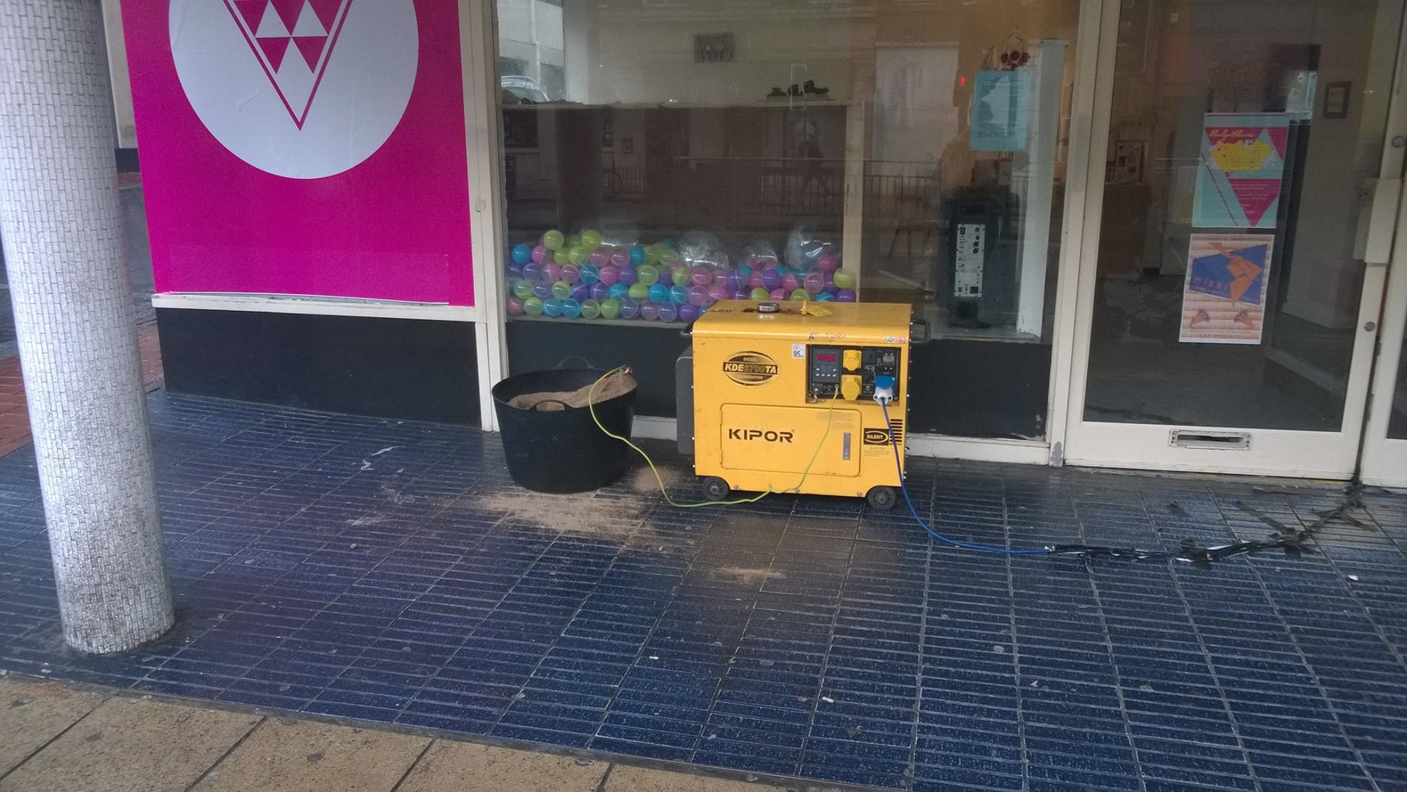

In my case the metal housing was clean metal nearby the hole ,if it wasn't I should have cleaned it so remove little bit of paint.so do i just connect a wire to the metal case with a screw and run it to the plug, and does it matter what size wire i get for my earth?
Essentially yes you have to run the wire from the plug to the metal case
The size shouldn't matter but it's common sense to use the same exact section of the power cord .
I've used H07-RNF 3G2.5mm² cable for my welder power cord
It's working better than ever since I've replaced the power cord
I wonder what sort of resistance readings they got?..
no need the genny uses a floating earth if only power tools are plugged in
