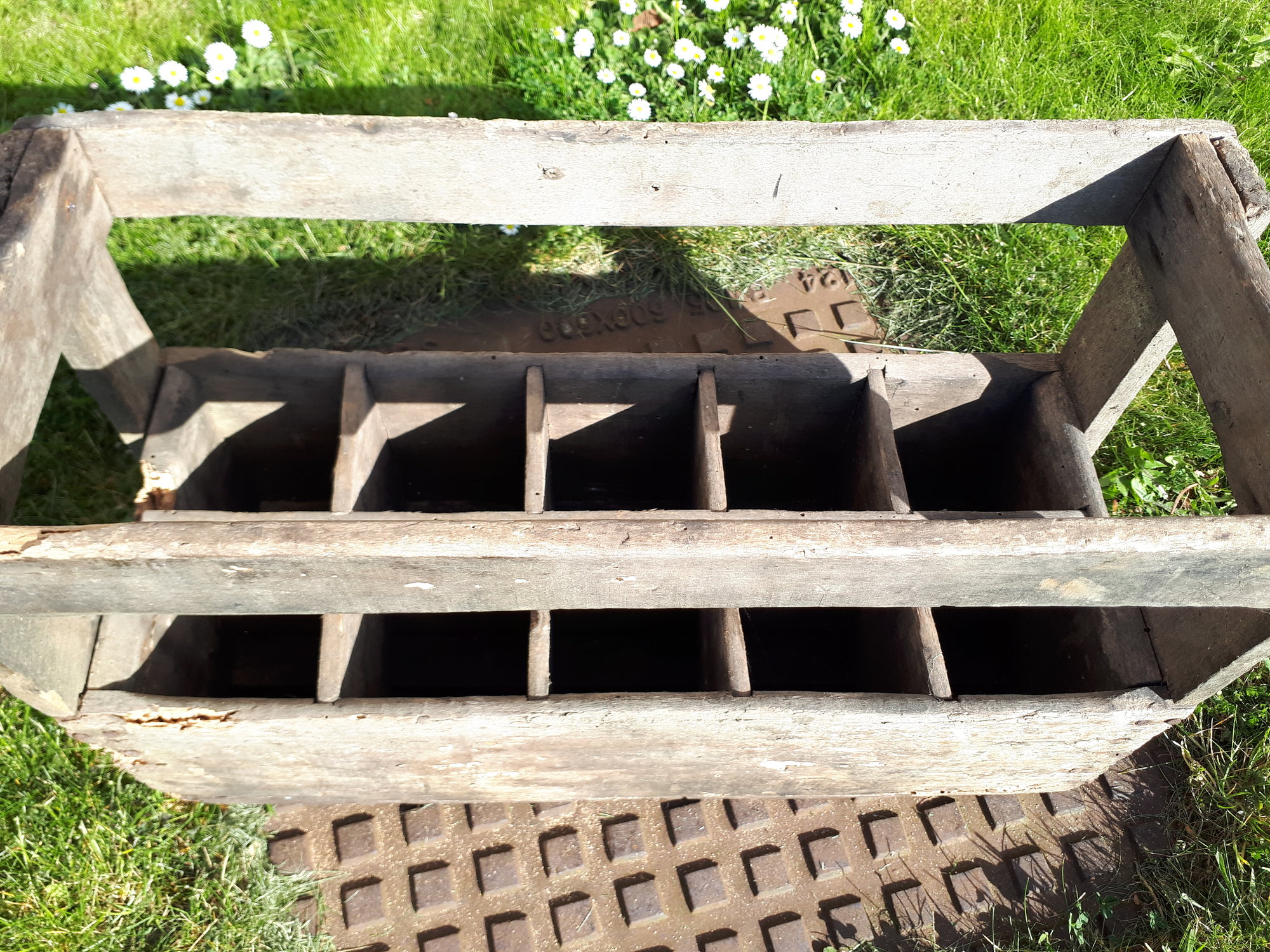

Noticed today a wooden crate I brought back from France is still being eaten by woodworm; I naively thought leaving it in the car for six months would be enough.
I'd like to protect it from further damage so its fit to use again. Any suggestions?
It's not easy to get rid of the ones inside. But painting some stuff on the outside will kill them as they enter or exit, and, eventually the whole part will be free of them.
You can get stuff off eBay cheaply that you just dilute about 1:20 or so. Most of the branded ones just have exactly the same chemical, but at 5x the price.

But often they are exit holes as they have moved onto fresh wood, sometimes on the same item.
The wood can be stabilised after the active worm is treated.

Had some meths in so have gone out and slowly poured that in as many holes as I could; didn't have any syringes on hand to squirt it into the holes.

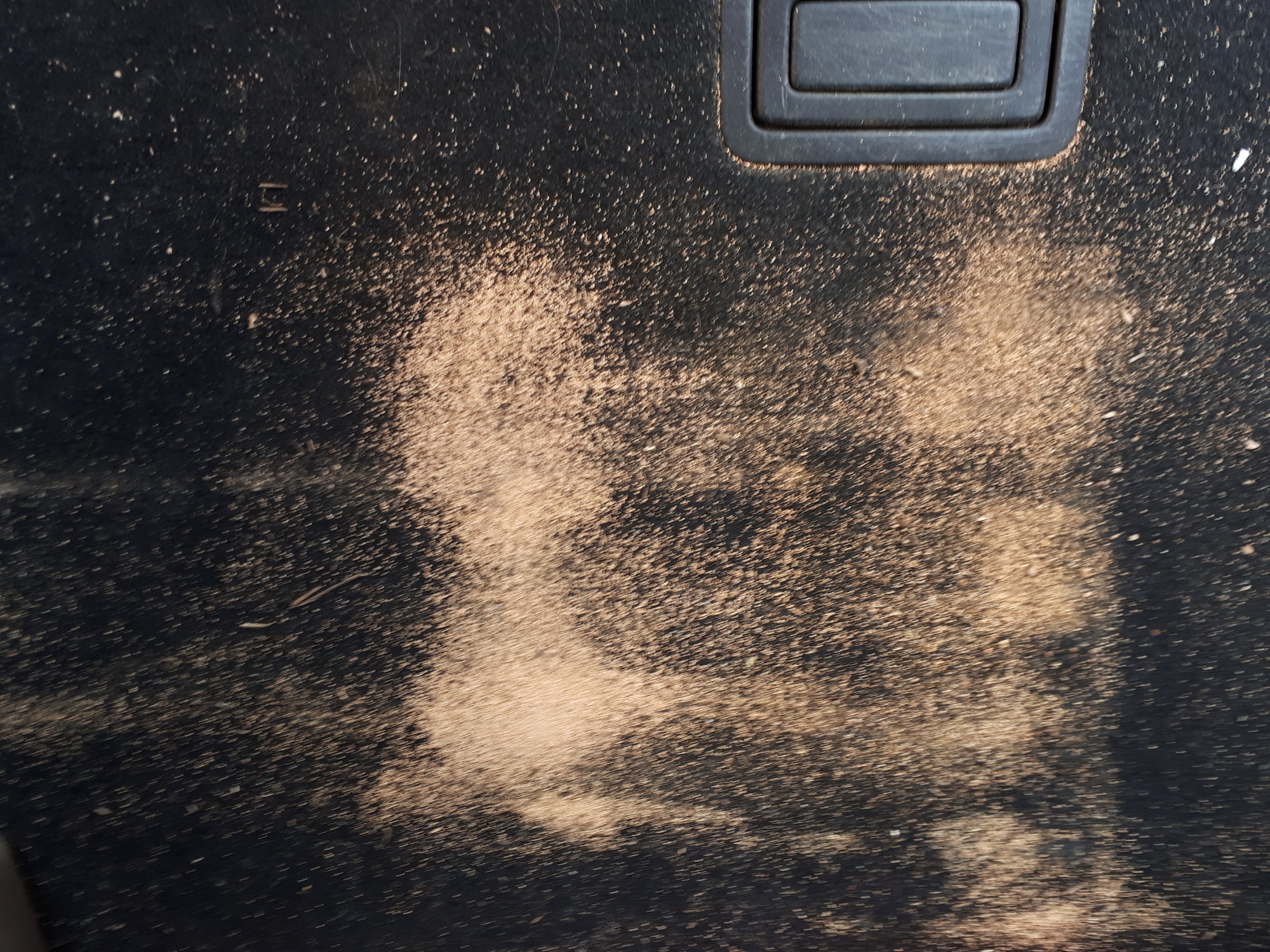

May have left it too long before treating. I thought there was a 4" or so size patch of wood dust in the boot... turns out that patch was much bigger. I also forgot the size of the crate, but not used it in months.
A few gentle taps on the floor outside, quickly accumulated this amount of wood dust, and I stopped before the loose dust fully stopped coming out as I was concerned about breaking it further. You may see a few chunks of wood that came off. The worst areas look similar to honeycomb and are very weak and soft to the touch.

Used all the meths we have on it in hopes it will stop them causing more damage. Had a fresh piece of timber alongside the crate in the car; couldn't notice any activity on it, so assuming they prefer the older wood. Have binned the fresher piece as that's been living in the car in case it had worms also have I only had enough meths to do the crate.
Will probably need to add some support in the areas where the bulk of the material was lost. Its mostly used for holding bottles safely in the boot of the car when travelling and for the ferry back from France, so hopefully will still be up to the task. Wish I took care of it long before now though.
Can't upload the photo of the pile of wood dust I knocked out for some reason getting errors, even tried changing the format to .png... It was a lot of dust though, surprised me how much they've eaten of it.
