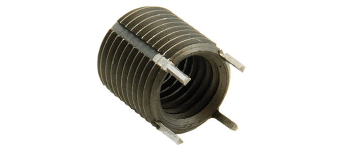

On a bike I would drill and helicoil and then replace the bolts with stainless steel, fitted with LM grease and you'll never have a problem again, also the threads will be stronger. Spent many a hour trying to correct damage caused by heat, easy outs, off centre drilling and broken taps! Language and temper soon go way ward!
