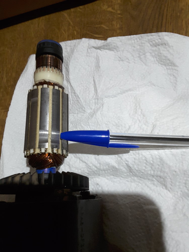

Mart I would not be using wirewool. It fragments to much. Bit of fine glass paper and a light rub round the copper segments. Then a small fine file to scrape/clean between the segments.

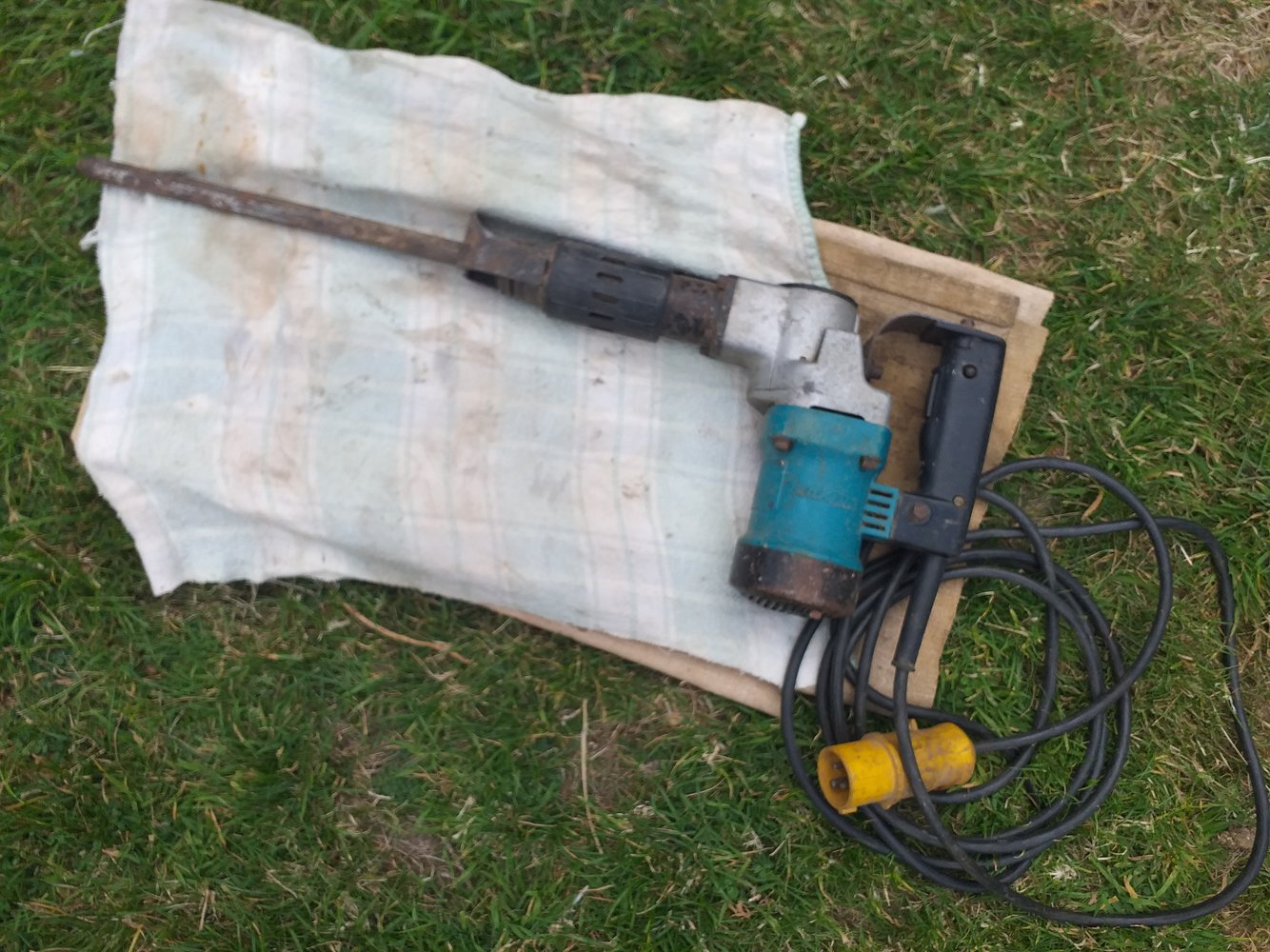

Oh well talking about a 30 years old demolition hammer ....I'm not so sure that Makita parts are that inexpensive.
I've got a HM0810 Demolition Hammer, it's a great bit of kit and new today it's £319.00.
Example prices of a selection of replacement parts:
Replacement Barrel: £114.31
Crank Housing: £57.34
Helical Gear: £22.64
Flat Washer: £11.04
O Ring: £5.24
Tool Holder Set: £106.29
Armature: £109. 47
Field: £ 39.92
Makita HM0810 Demolition Hammer Spare Parts | Miles Tool & Machinery Centre
An exploded drawing and spare parts listing for the Makita HM0810 Demolition Hammerwww.mtmc.co.uk
That is where metal has been removed for balancing.I just took this photo with the tablet device.
The only thing that l can see which looks odd is some sort 'hollow areas' on the armature near the pen nib.
