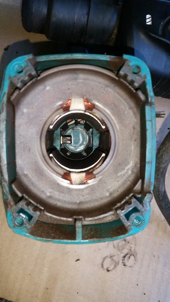

Mart I would not be using wirewool. It fragments to much. Bit of fine glass paper and a light rub round the copper segments. Then a small fine file to scrape/clean between the segments.

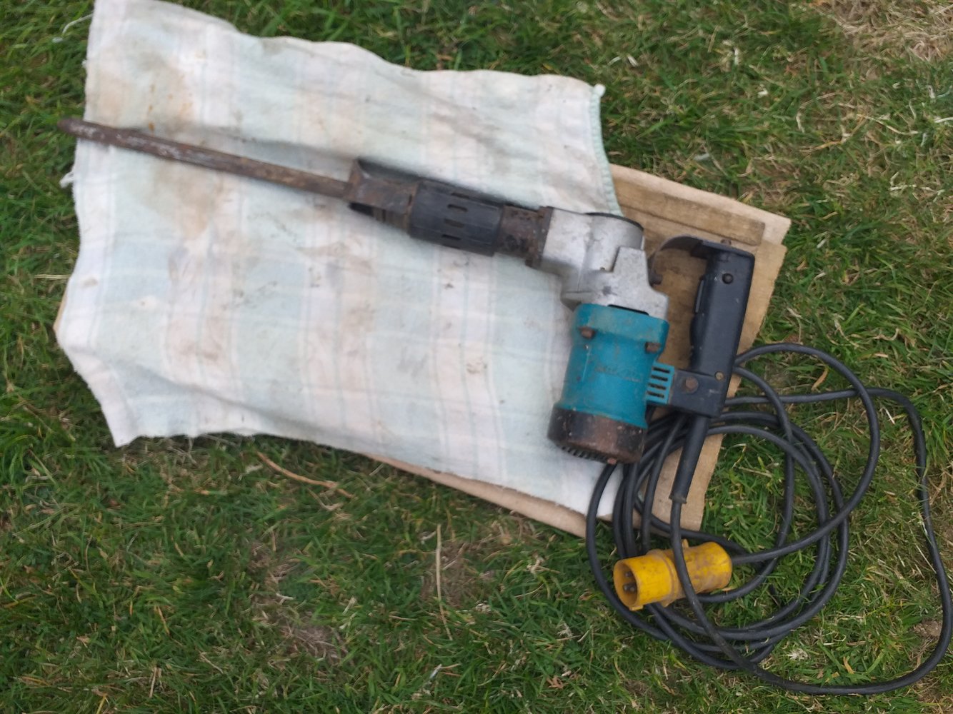

Oh well talking about a 30 years old demolition hammer ....I'm not so sure that Makita parts are that inexpensive.

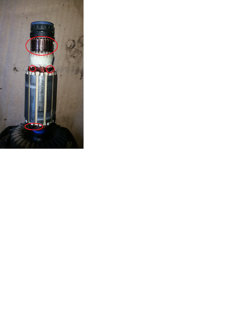

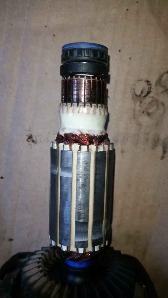

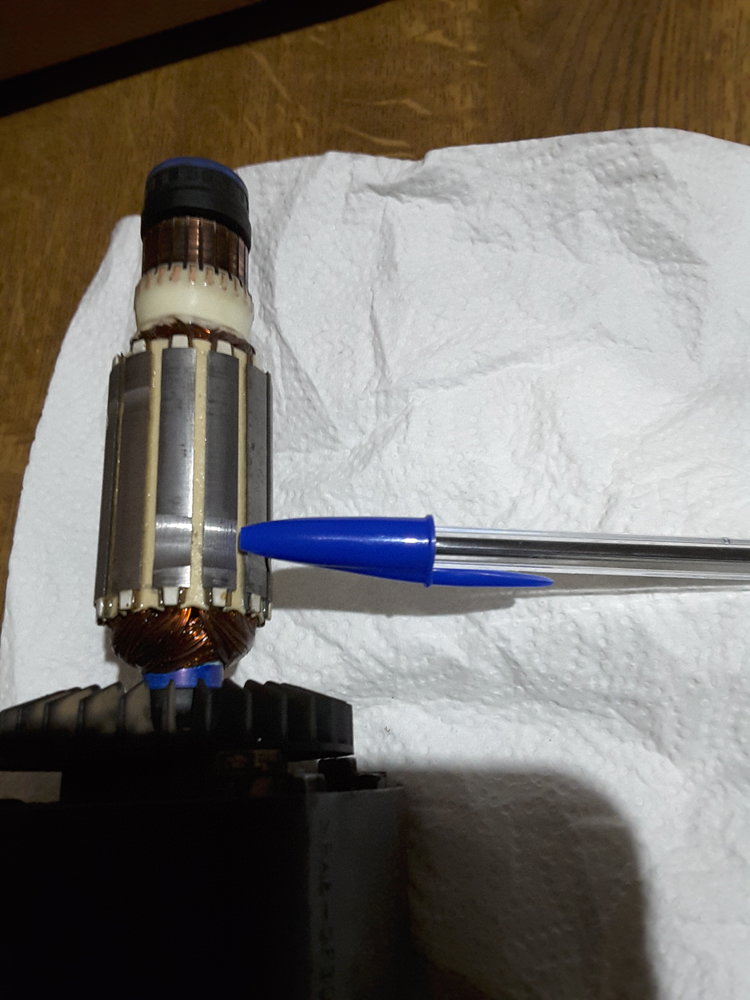

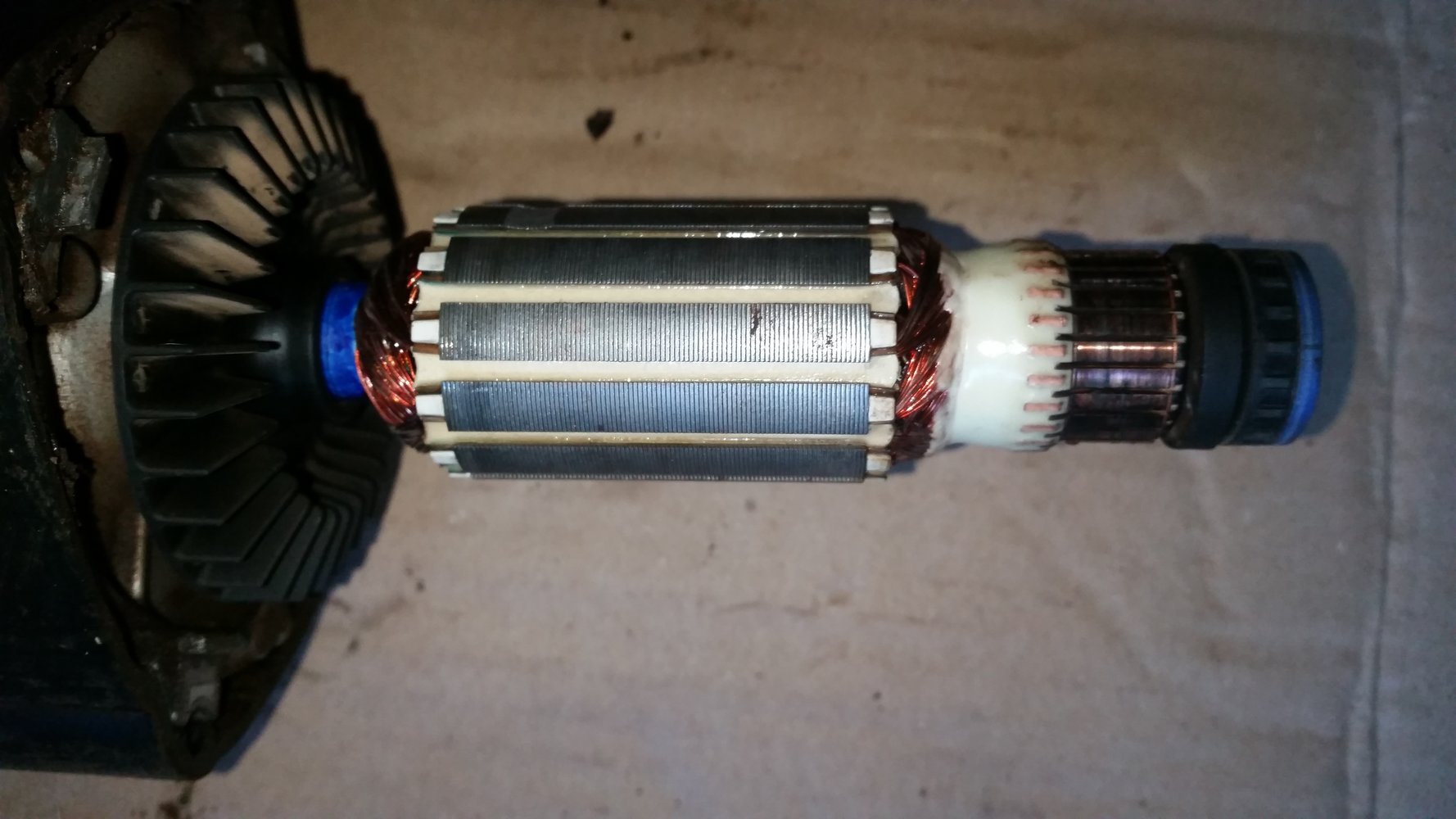

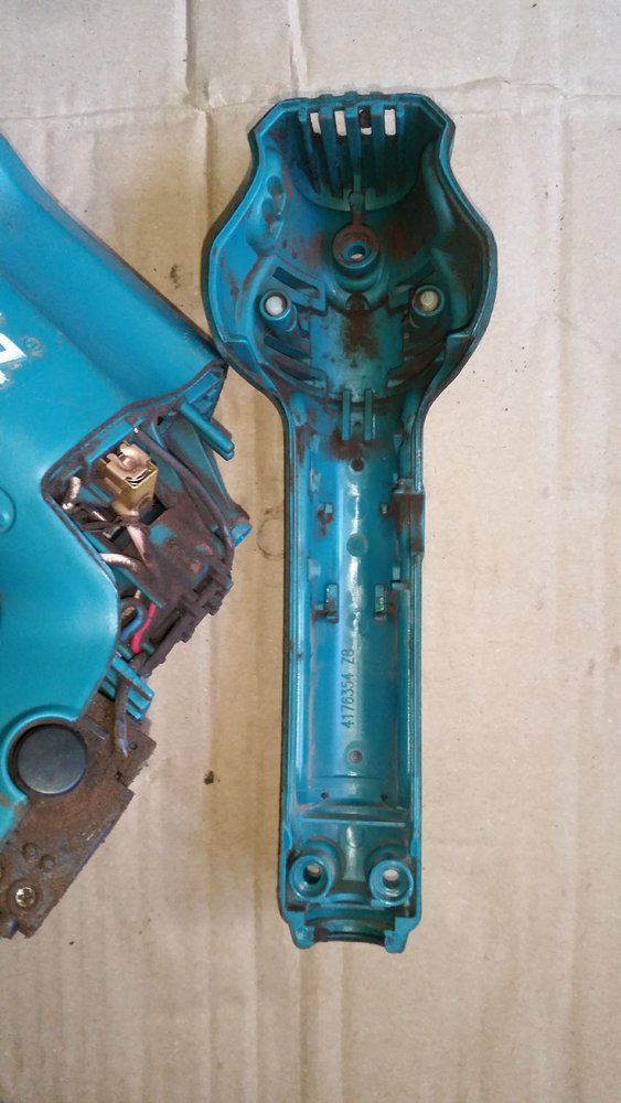

That is where metal has been removed for balancing.I just took this photo with the tablet device.
The only thing that l can see which looks odd is some sort 'hollow areas' on the armature near the pen nib.
