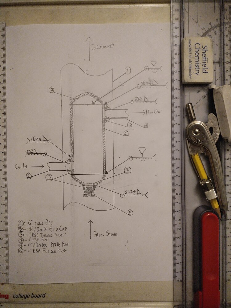

last woodburner we added back boiler too, was just simple tank that replaced the rear firebrick, with fittings like @sardine is showing.
Wouldn't do it again as it changed the efficiency of the woodburner.
could never get it to burn quite as hot = when you just dont get any soot on the glass. and it used more fuel.
That's no big surprise.
In modern boiler design, water-wall is usually implemented as a way to reduce/control the combustion chamber temperatures whilst acting as an economiser (water preheat) for a water-tube system.
As a design water-wall is far less efficient at heat transfer than other designs due to the geometry, but is also robbing the combustion chamber of radiative heat that would be re-radiated from the refractory helping to maintain chamber temperature.
back boilers are banned after 2005 that includes the wood burner due to not being efficent by the morons
That's a different part of the building regs (Part L), and I would agree it does seem like a ham-fisted approach that neglects the benefit of energy recovery for suitably designed appliances.
I was referring to Part G which is about the safety of such systems, and specifically pointing OP to the requirements for venting and heat dissipation to prevent potential boiler failure, system pressurisation, or excessive DHW temperatures... All good stuff!
I grew up with a coal-fired back boiler, and whilst I occasionally get nostalgic for it, would absolutely not have one as a primary source of DHW or central heating (there's pretty much always a better alternative).there efficent enough to do that job whilst you enjoy your stove fire at the same time however i wouldnt want to use it as a main supply unless i had to do as then there not an efficent way to do it
Fine as supplementary heat, but utterly impractical to depend on once you've had a combi-boiler.
	 My point exactly!
