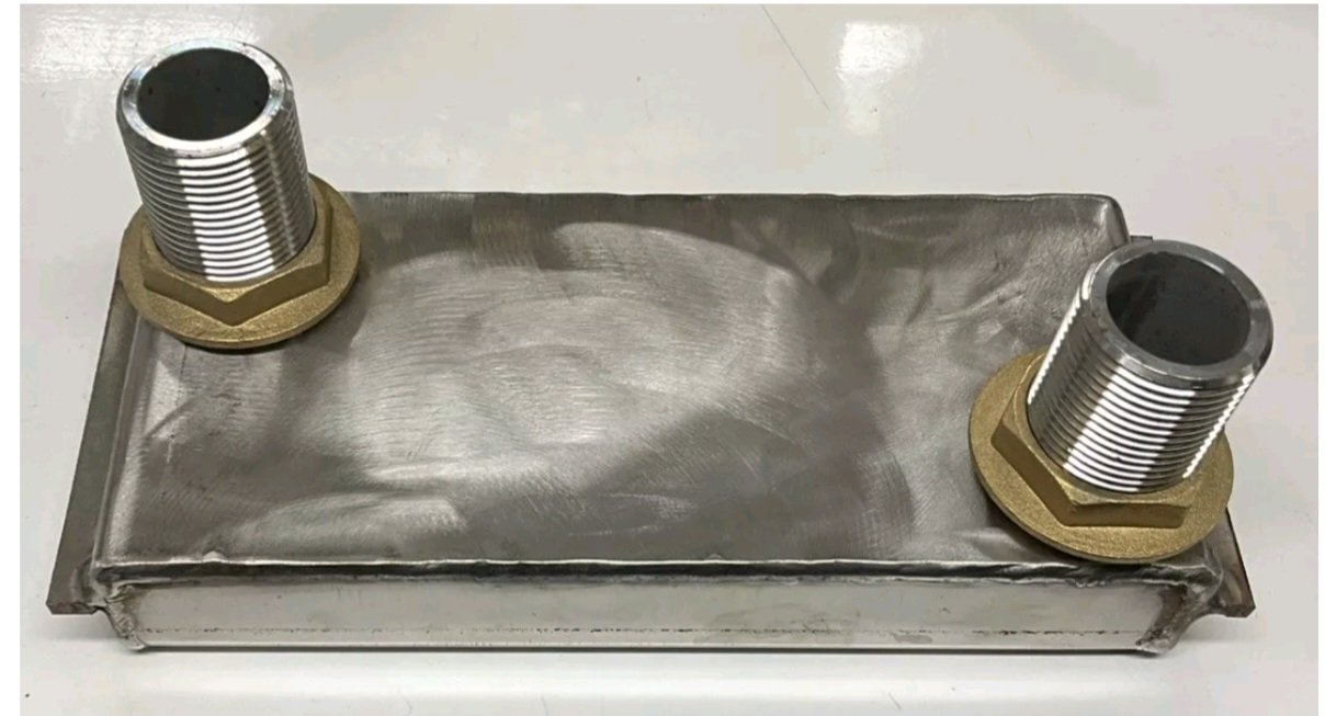

but since you mentioned the old back boilers in the chimney they are prone to boil due to there design of straight up to the cylinder and back down
the issue with them is no sediment collection tank other than the back boiler itself and that can block up and thats when they can explode
they are also not a serviceable part either ( but could be with a sediment tank )
the danger lies when they arnt used due to central heating and then fired when needed as they can be blocked
a degrading one is noticeable due to longer heating times needed the more it blocks up
