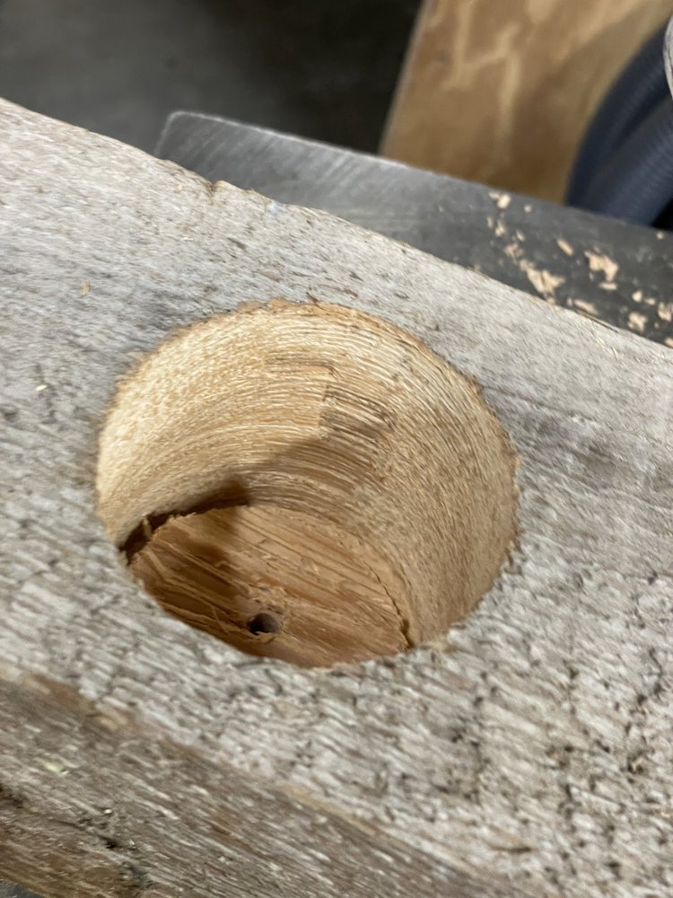

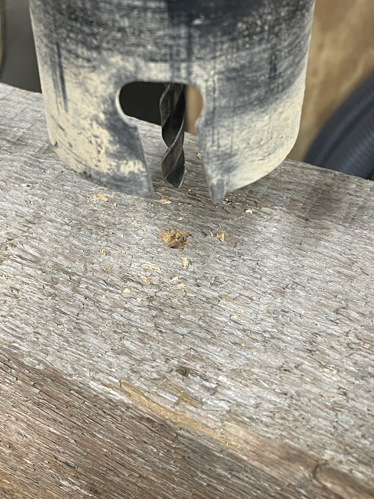

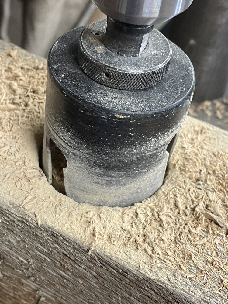

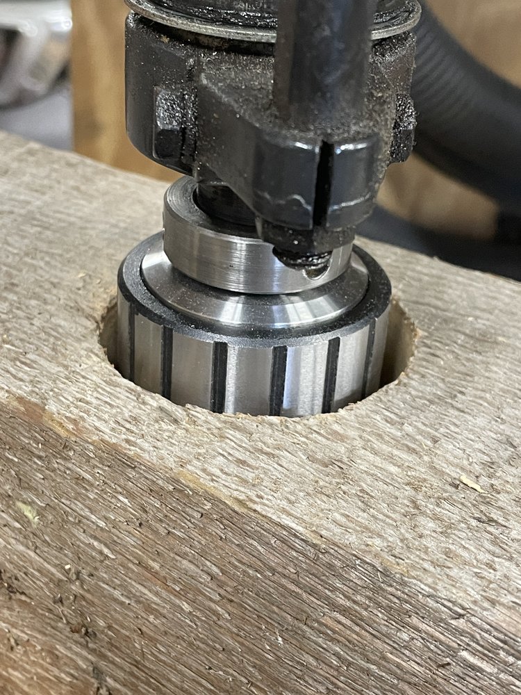

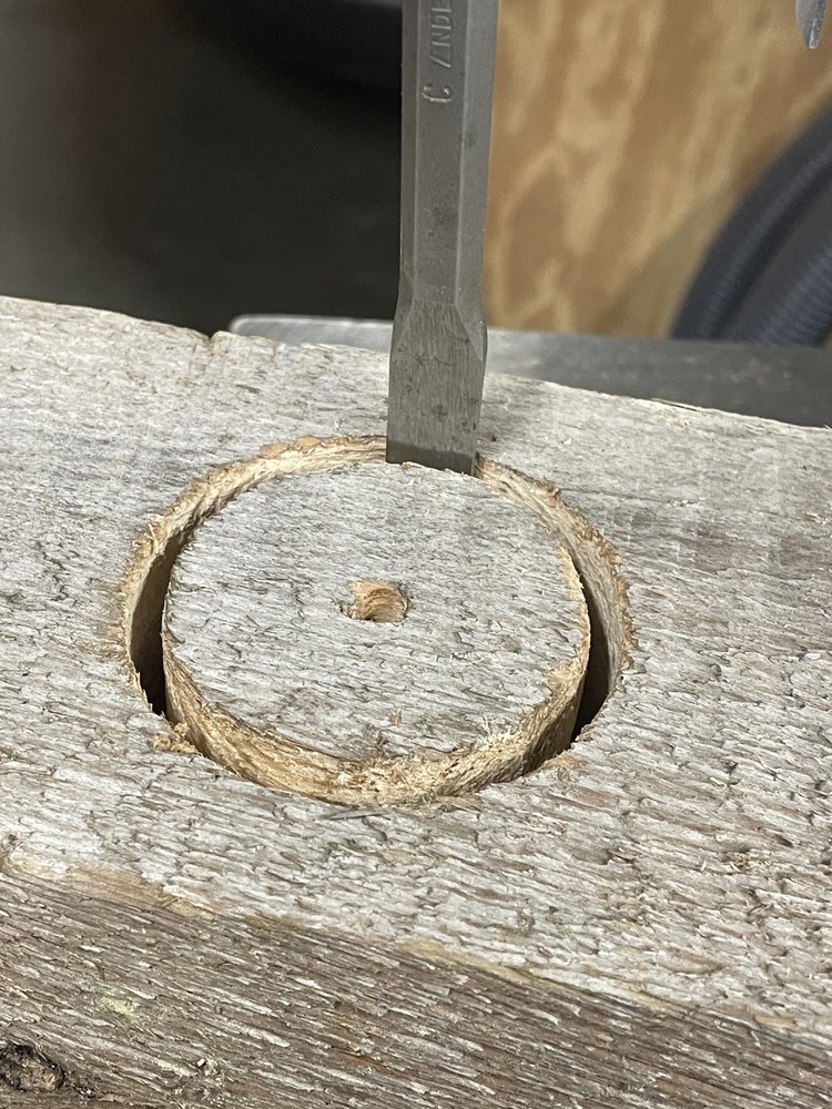

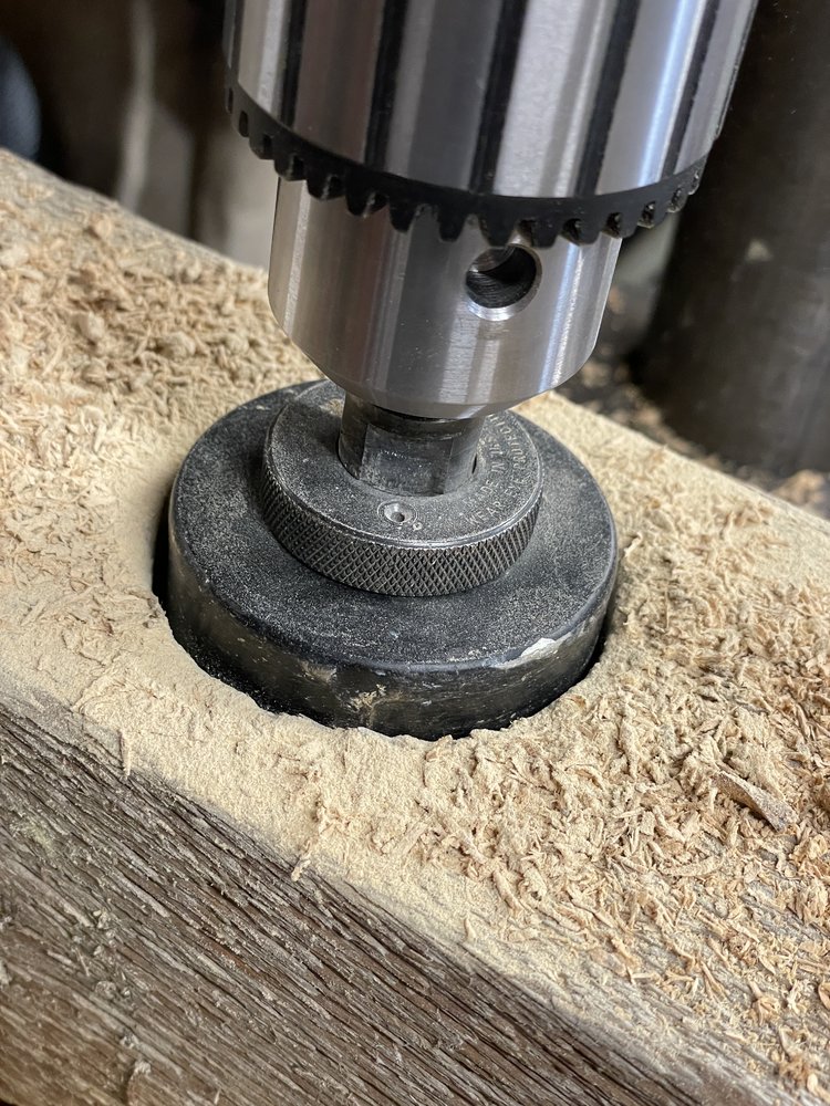

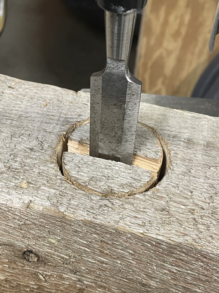

Now I've got a chainsaw on the way for my garden project next question is how would I make, say, 60mm holes in new sleepers so 48mm scaffolding tube will pass through?

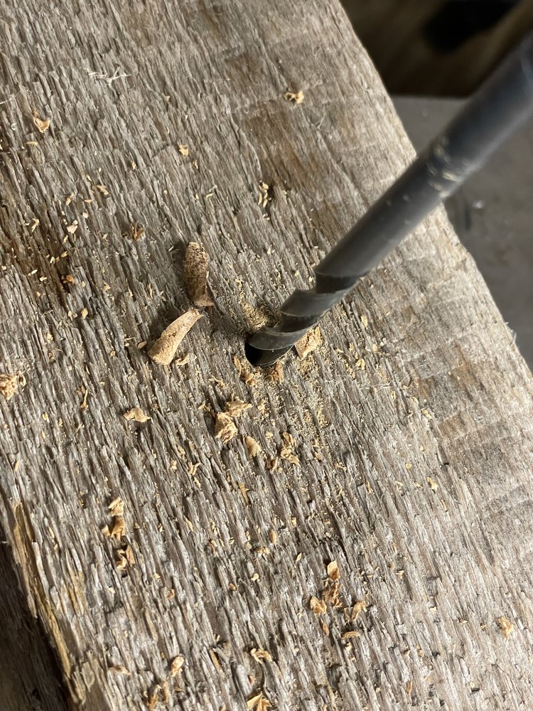

, these are seriously aggressive effective drills!
