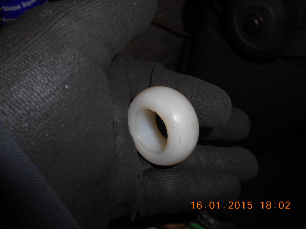

The item is a 'no longer available' gearshift bush from my 89LT28.

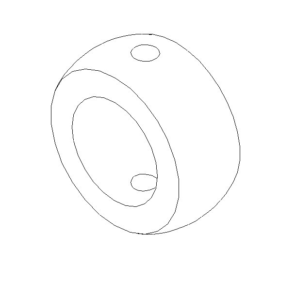

It is a section of a 35dia ball, 16t with a 21dia bore and a 5dia cross drill. Material is Nylon6.

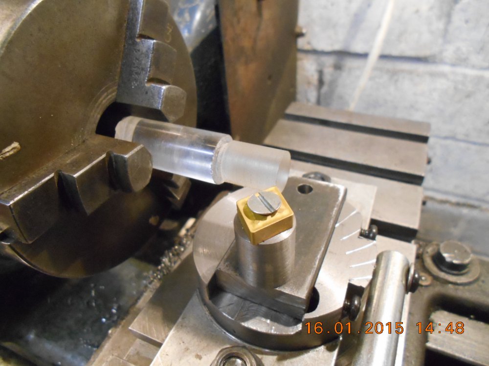

I have a Myford ML7 and a MiniMill.

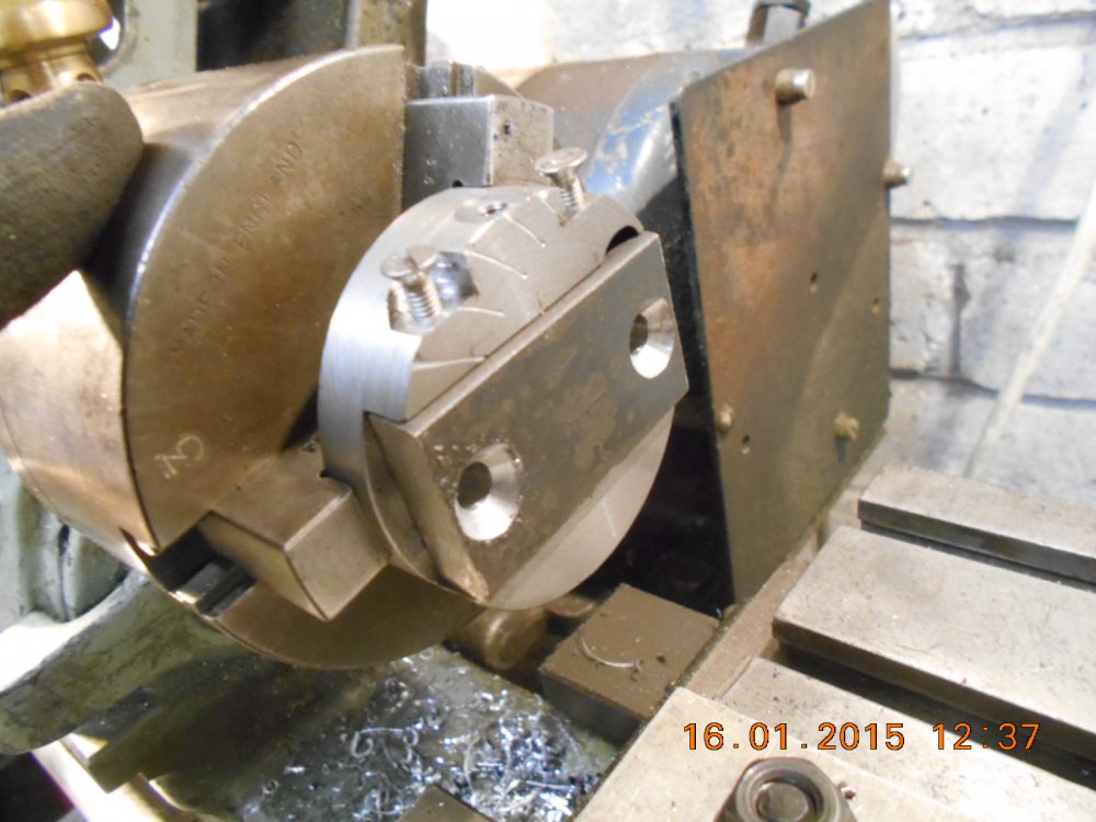

Edit:Not made or procured yet will be a radius turning fixture.
