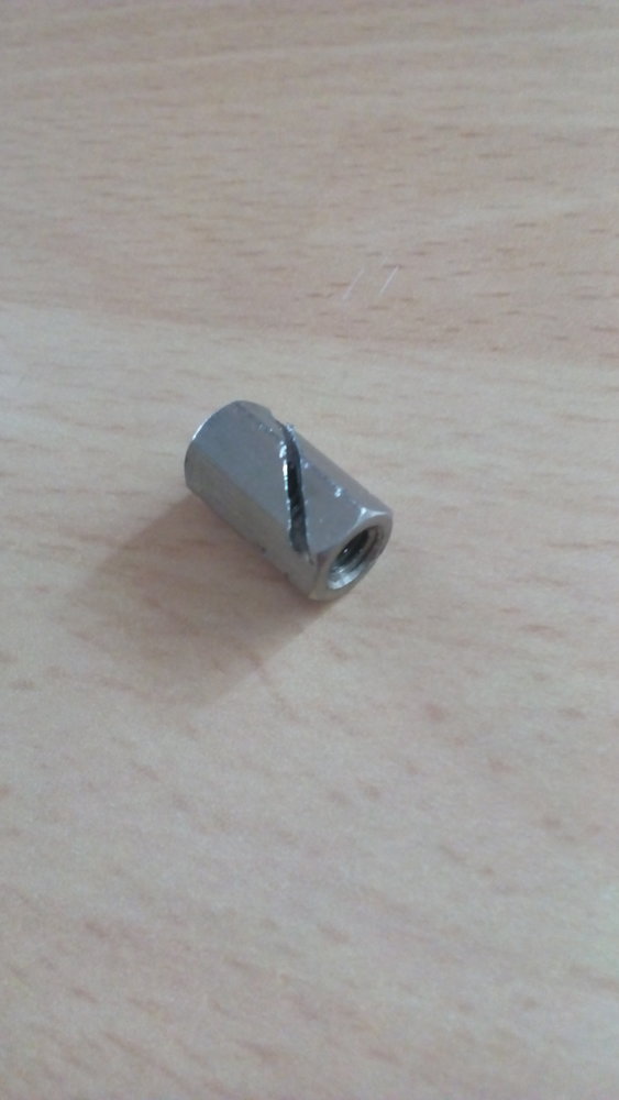

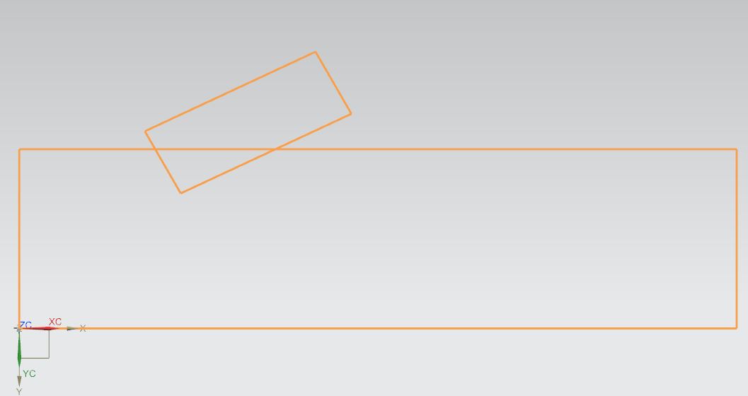

i have new joiners ...i want to cut them in 2 as per the cut in the photo , the angle of the cut means the blade would cut into the viceWhat are you trying to do? is the first question.

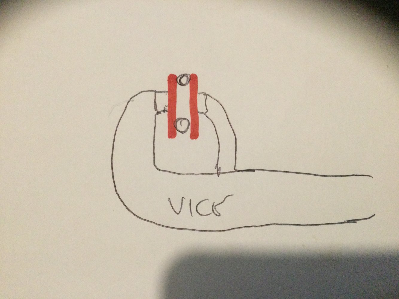

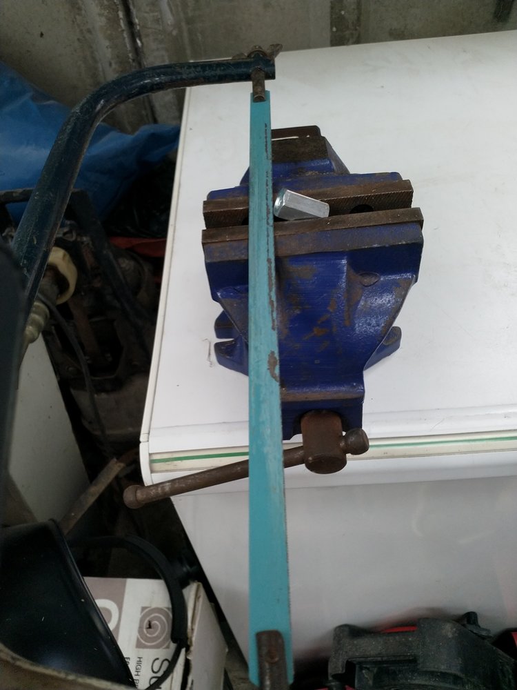

m5 nut isnt really man enough to hold it up in the vice if the joiner is sticking out far enough to swing a blade at itM5 bolt with a nut on either side of your coupling nut.
Use the vice to hold the bolt
Stand a couple of bits of 3mm plate in the vice, clamp up nuts and cut down from the top.
