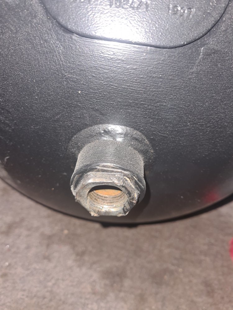

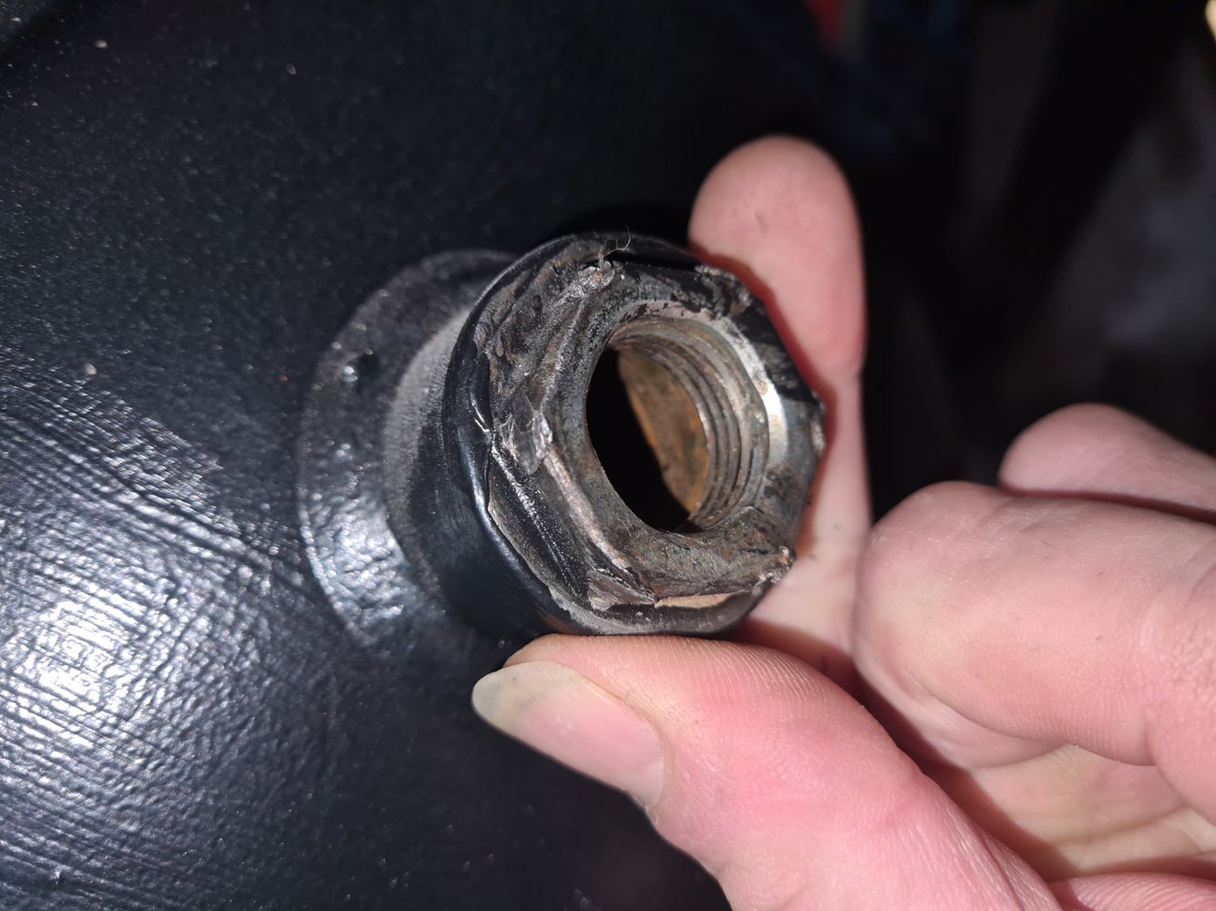

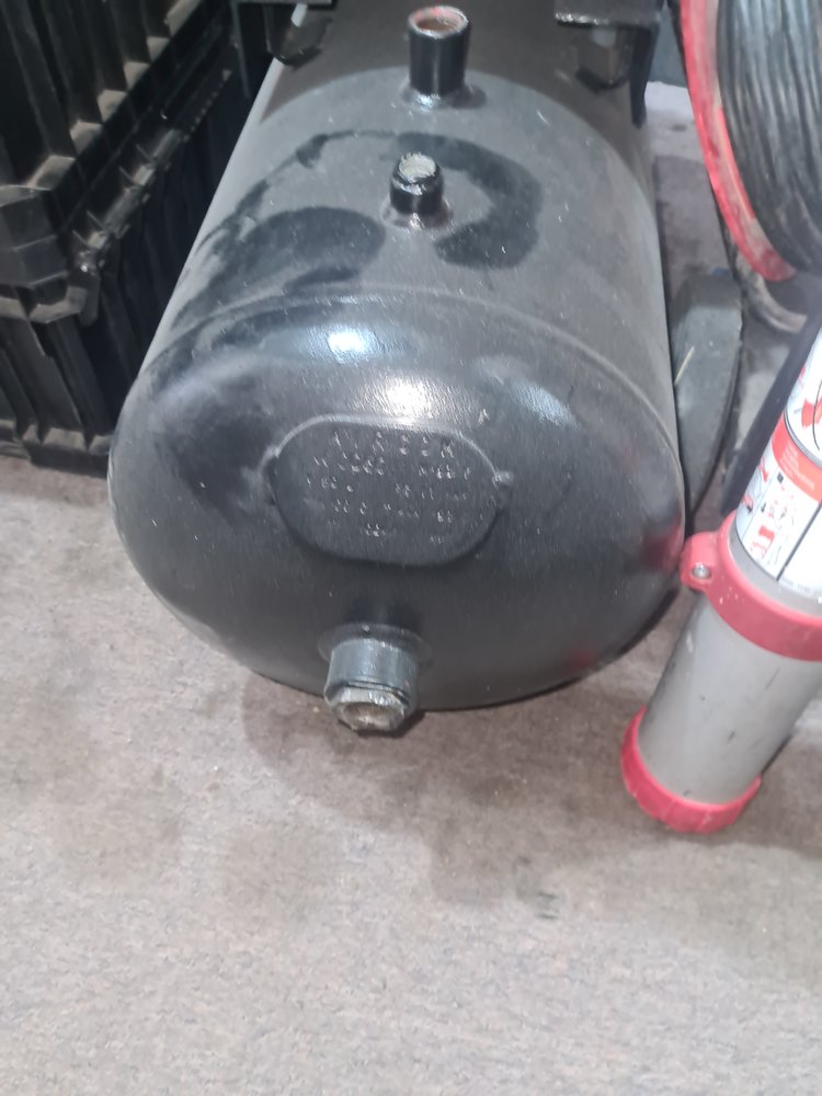

Can I Weld a nut on it ?
100 mm 4 inchI'd bet it's been treated with a Loctite type thread locker, before risking the paintwork, maybe try screwing a 100mm pipe nipple into the bush and heating the nipple; the heat will migrate into the bush and hopefully ease the thread locking solution. It's worked for me in the past, although not on an air receiver.
Best of luck with it.
Yes clean the threads is an easy idea but as I've put much work in it be nice to make it all good looking
If it comes to it thata what I will do
I go with this as well, it looks like it's fixed to screw a union into it.Is it supposed to come out - it just looks a little strange to me, as the bore of the boss that you can see further in appears to have no threads - if it was a reducing bush screwed in, I would expect to see threads on the larger ID.
