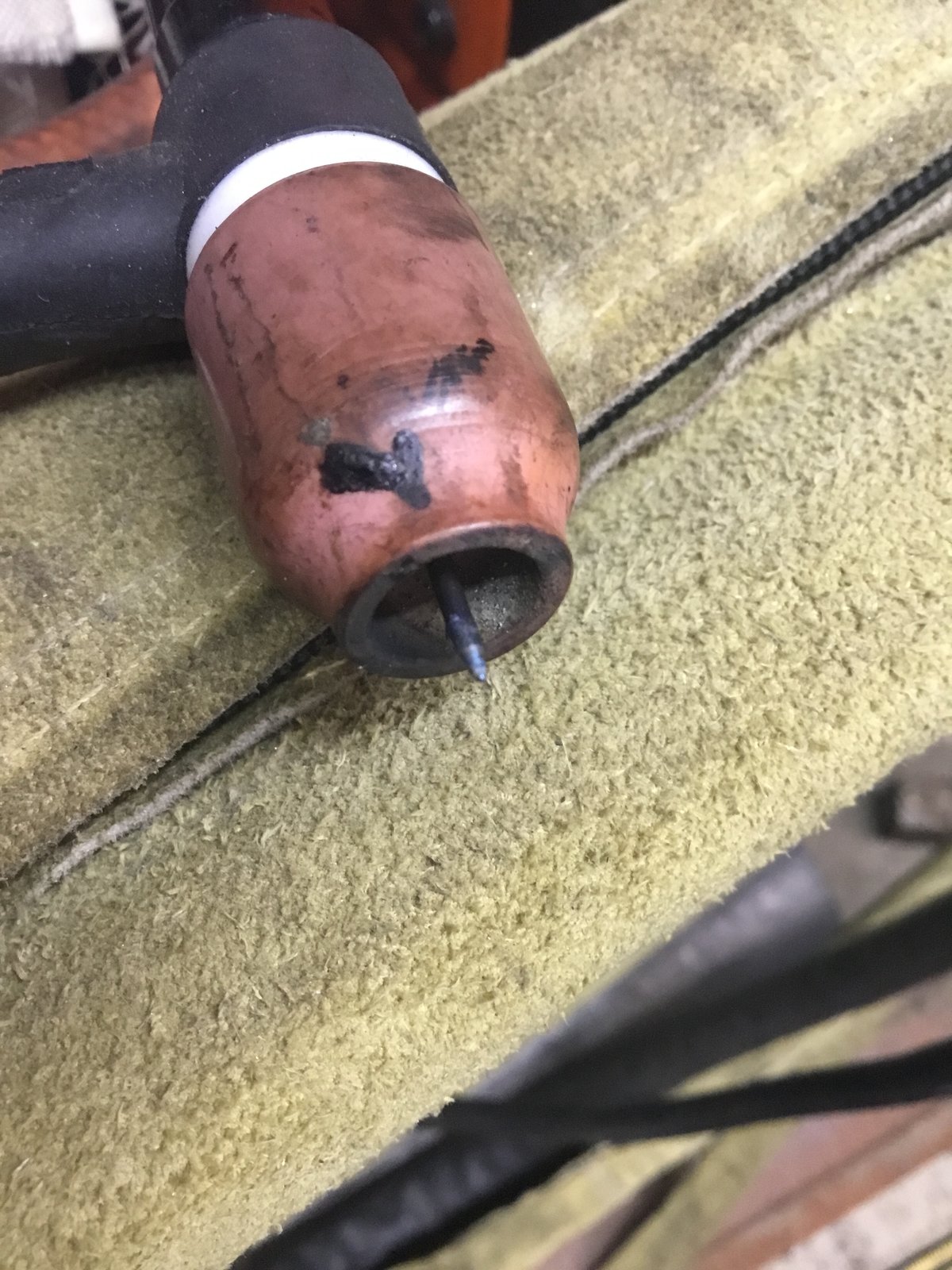

  9. Shox Dr
    Shox Dr Chief Engineer to Carlos Fandango
    Messages:
    15,248
    Location:
    East Yorkshire
    All true, I’ve done the same. I was going to take a picture of my tungsten, then saw the state of it:laughing:. But that comes with experience. Far easier to start fresh everytime when you are learning.
    (Piccy for S&G:ashamed:)
    Munkul likes this.
