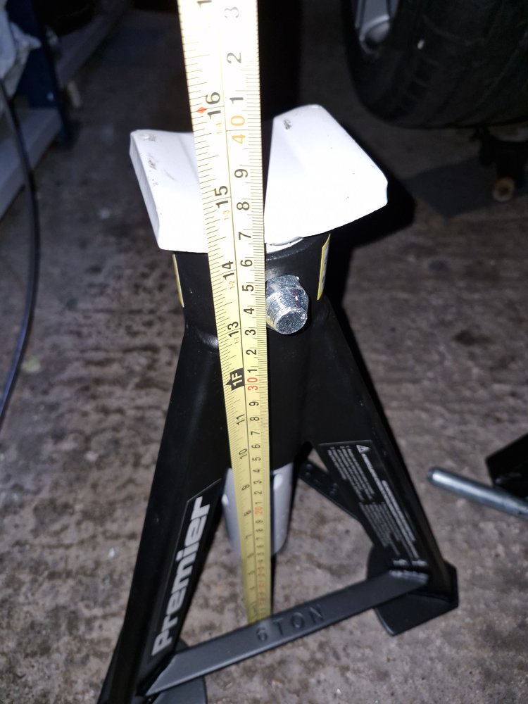

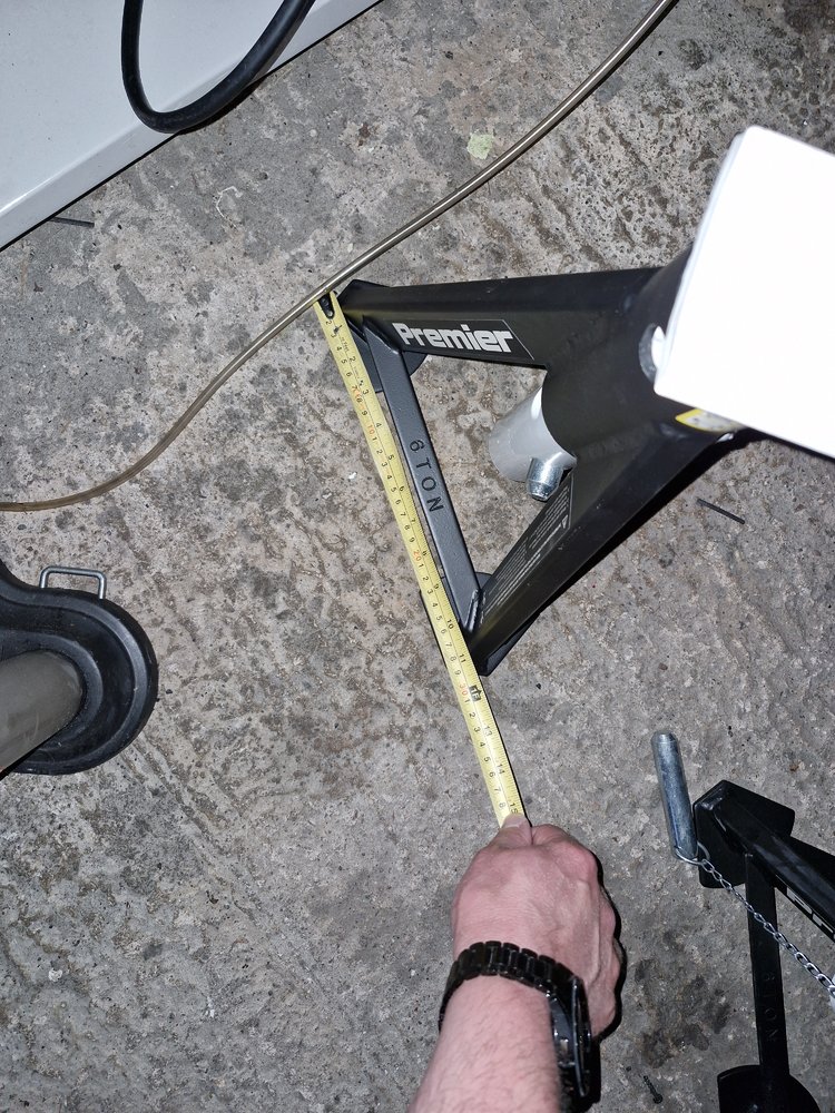

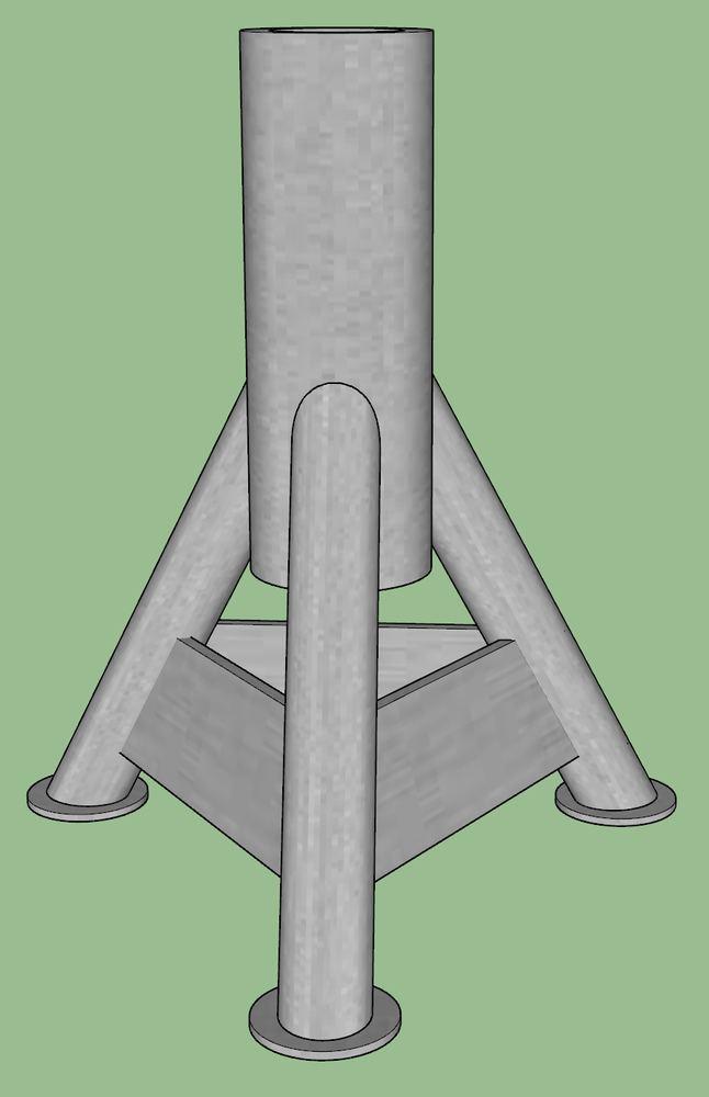

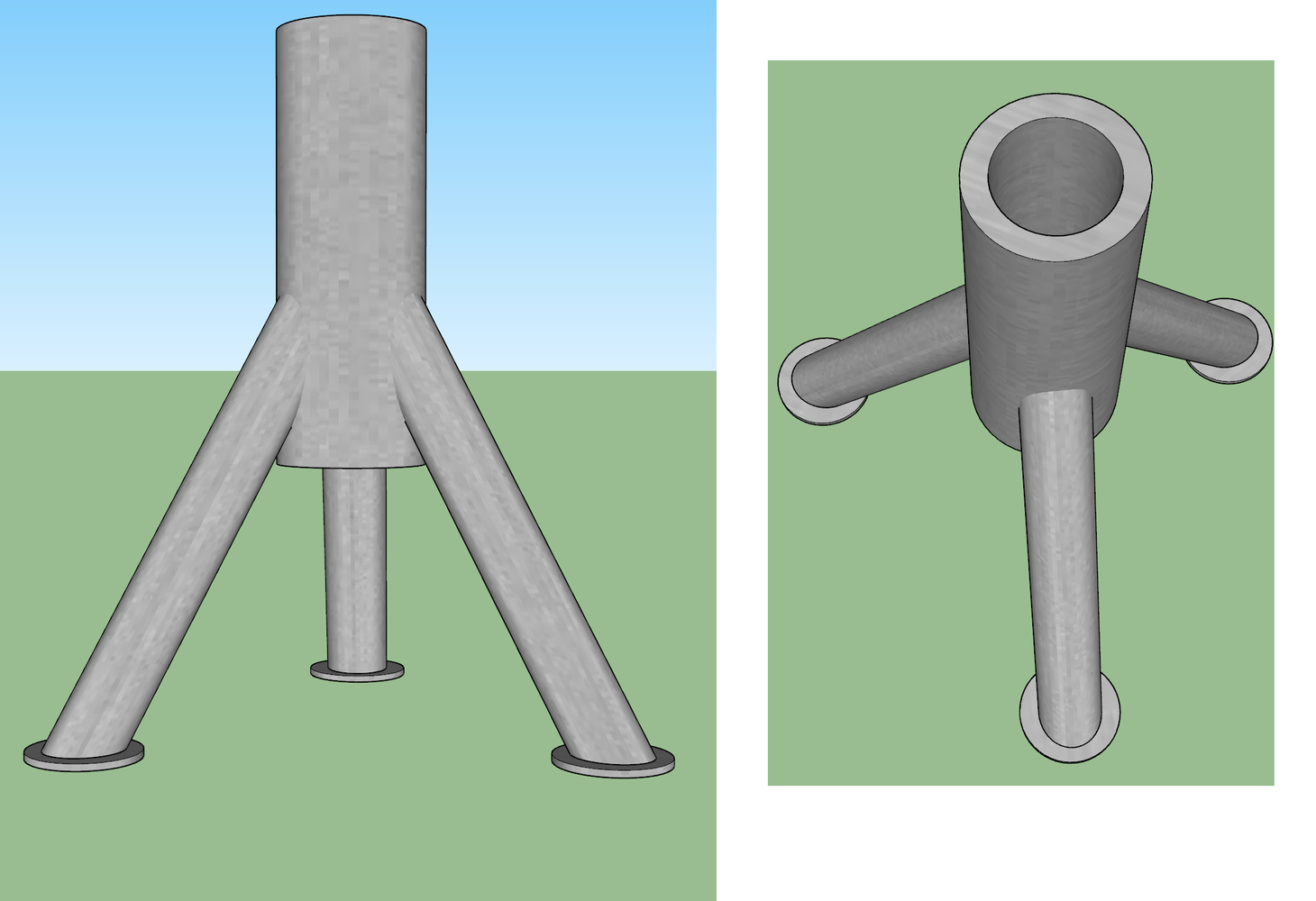

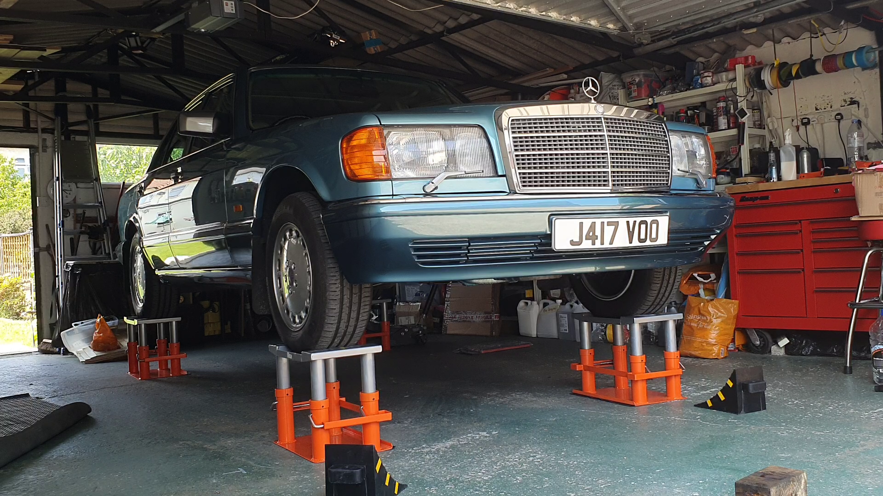

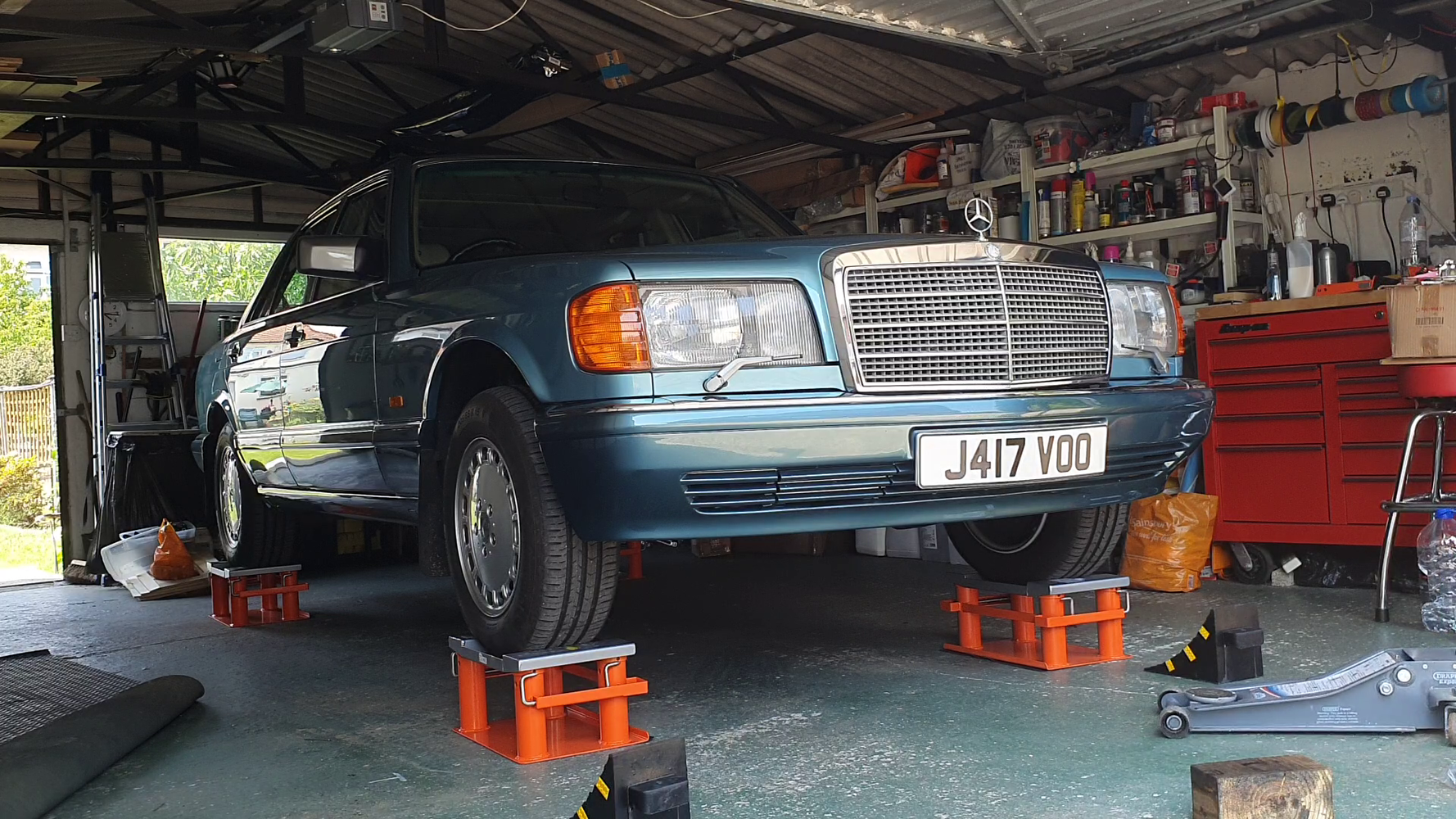

Personally I wouldn't work under a car on just 4 stands...it's inherently unstable if a smallish sideways force is applied to the car.
It would be as, if not more stable than a two post lift.

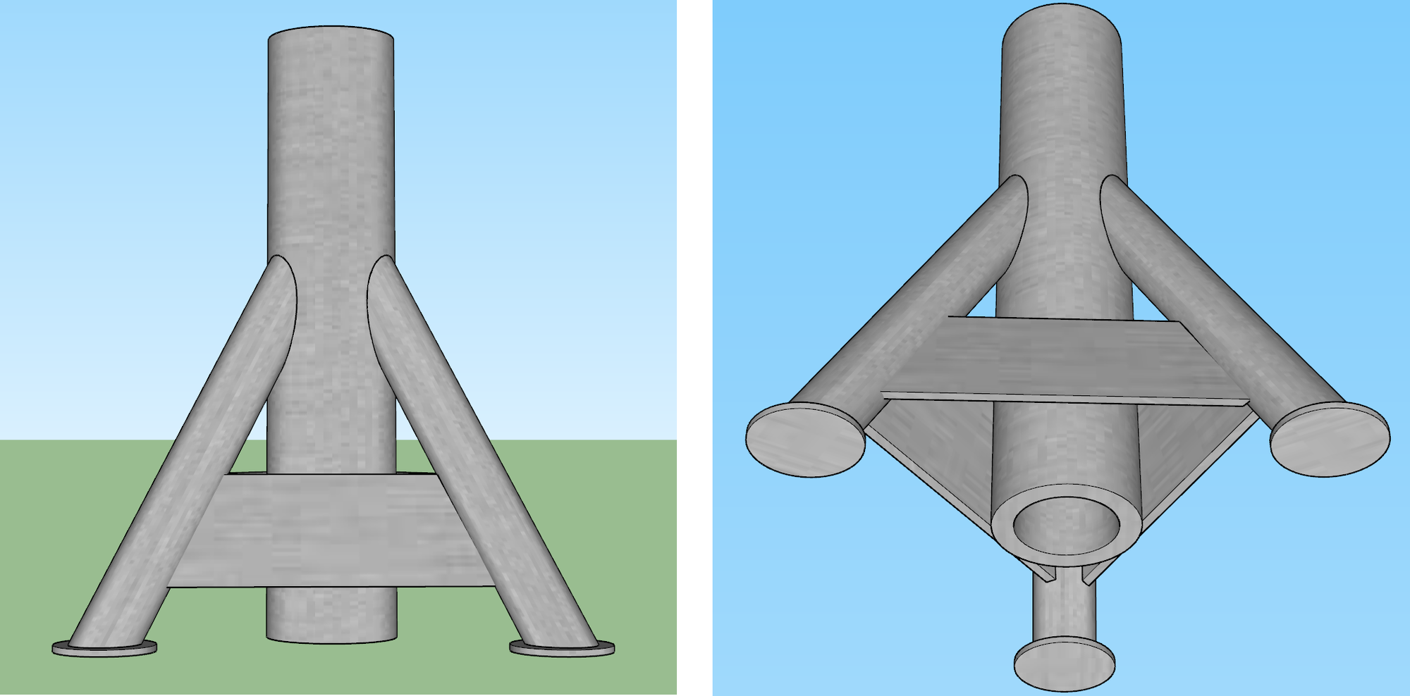

I won't be satisfied in just knowing that 'it seems strong enough', I would like accurate figures before I go crawling around under the car! I'll come up with another design, and see what you all think.
