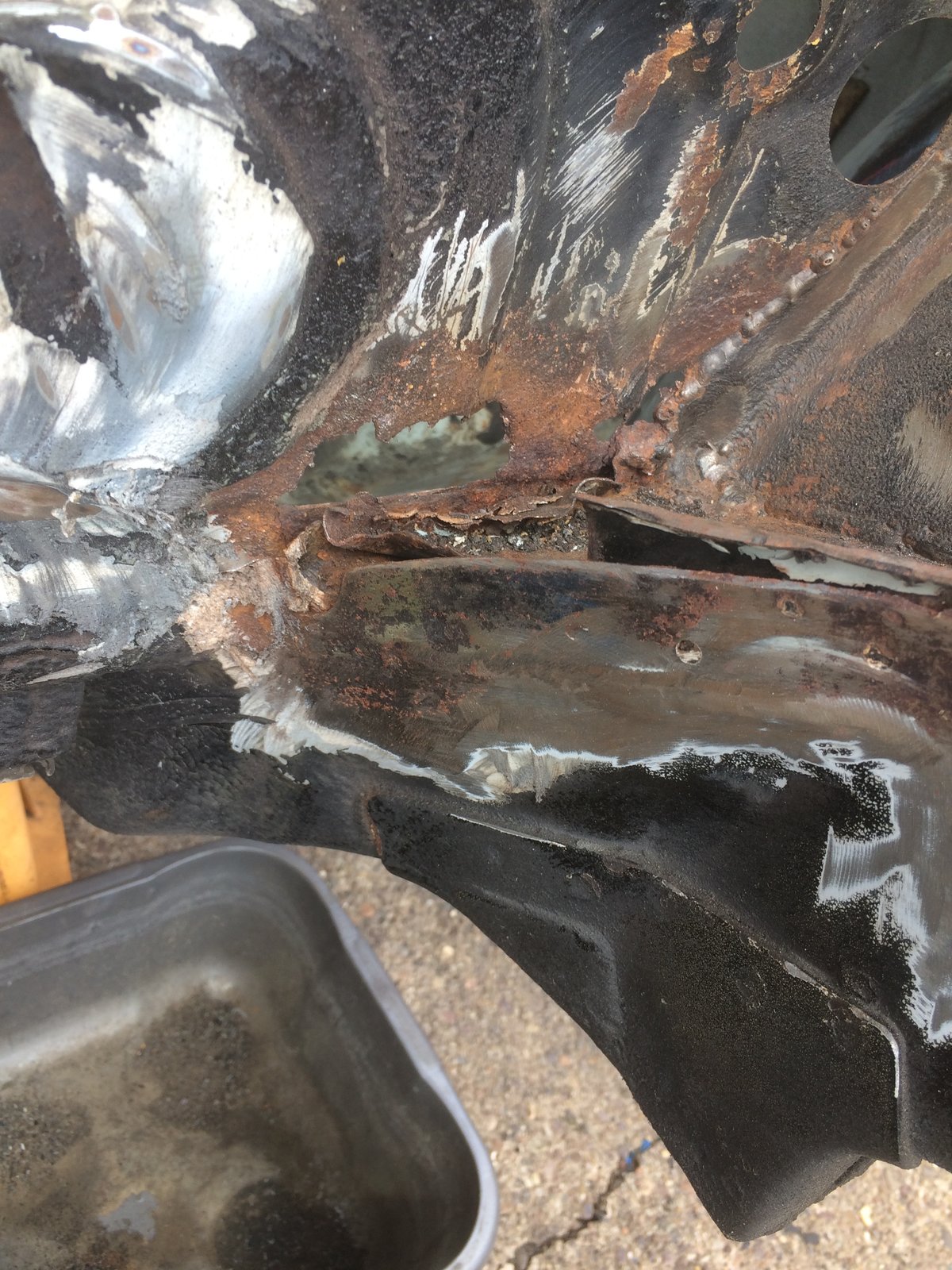

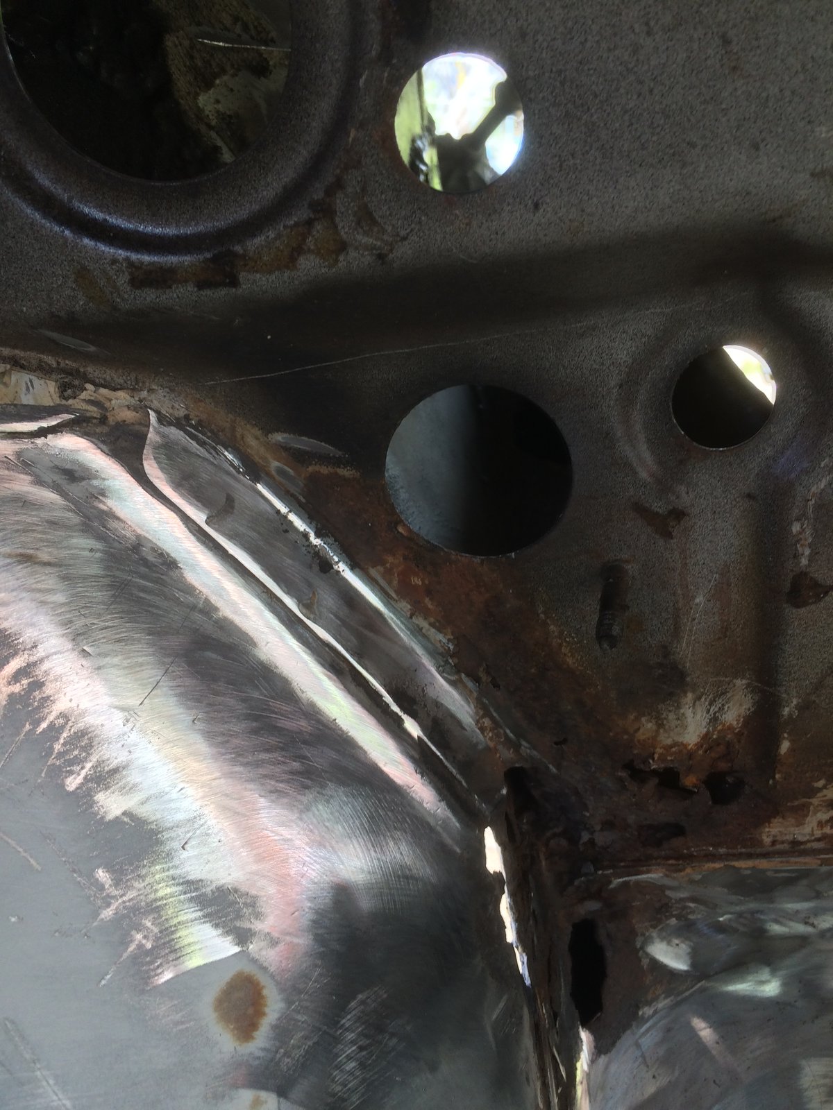

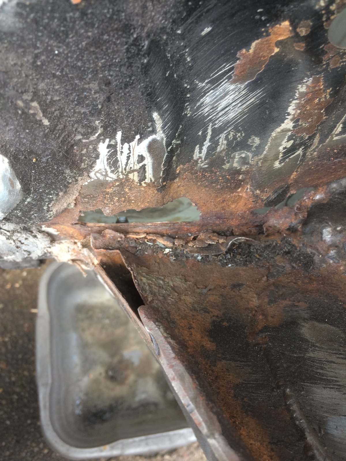

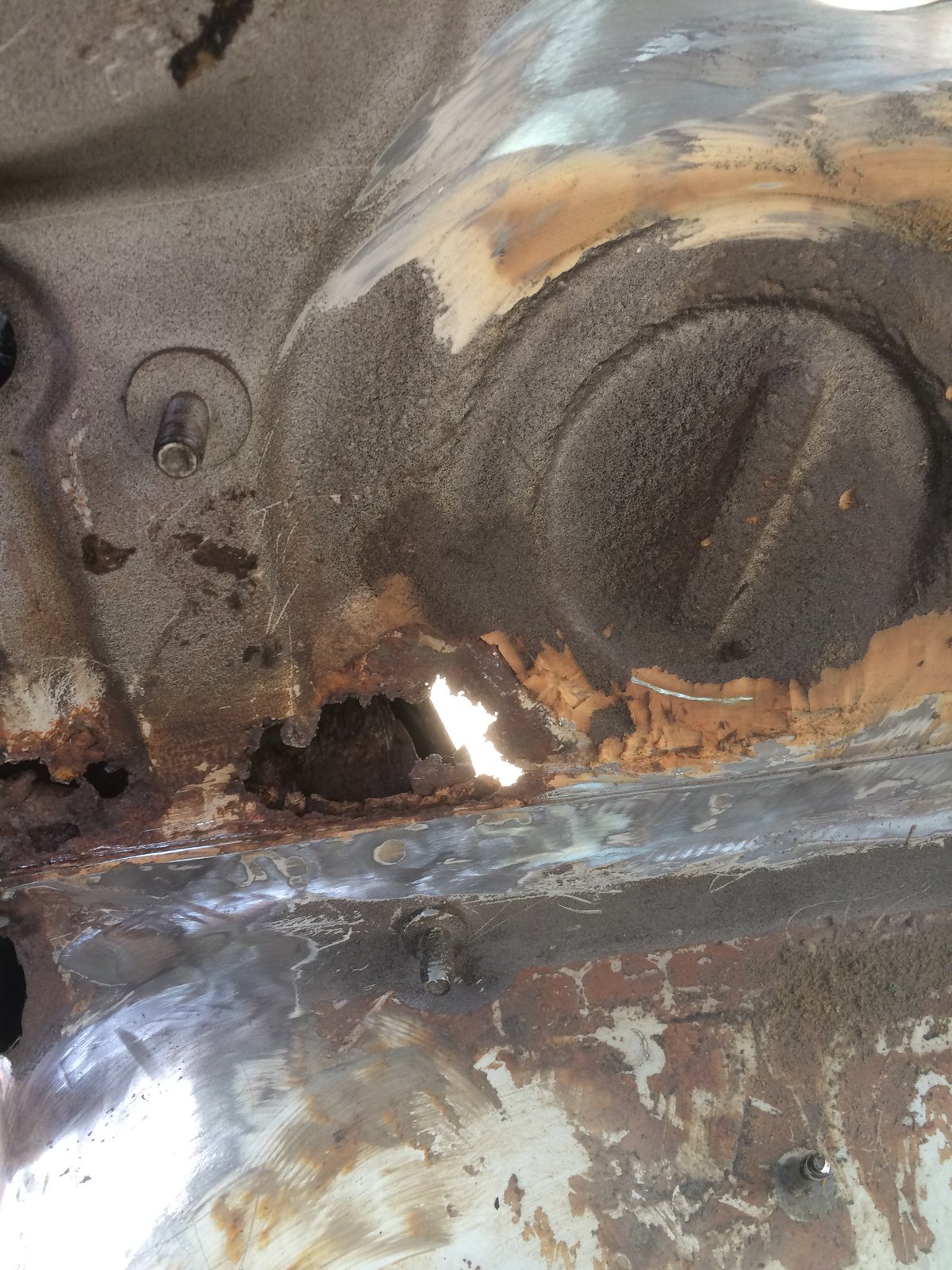

Okay I’ve got a mk2 golf thats holier than god knows. I’m about to attack the footwell I’ve looked up as much as I can and have a fair idea how to go about it. This is a first for me. In the picture you can see it’s gone where 3 pieces meet. My intention was to cut under the spot welds and remove a square section and rebuild that slowly and let the other bits fall in around that. It’s rotten right through to the chassis rail and wheel arch.
There’s also rot on the turret but was hoping for some drawings/measurements before I attacked that incase owt moved. But that’s for another day.
I’ll post some pics of what I’m looking at.
Thanks again folks.

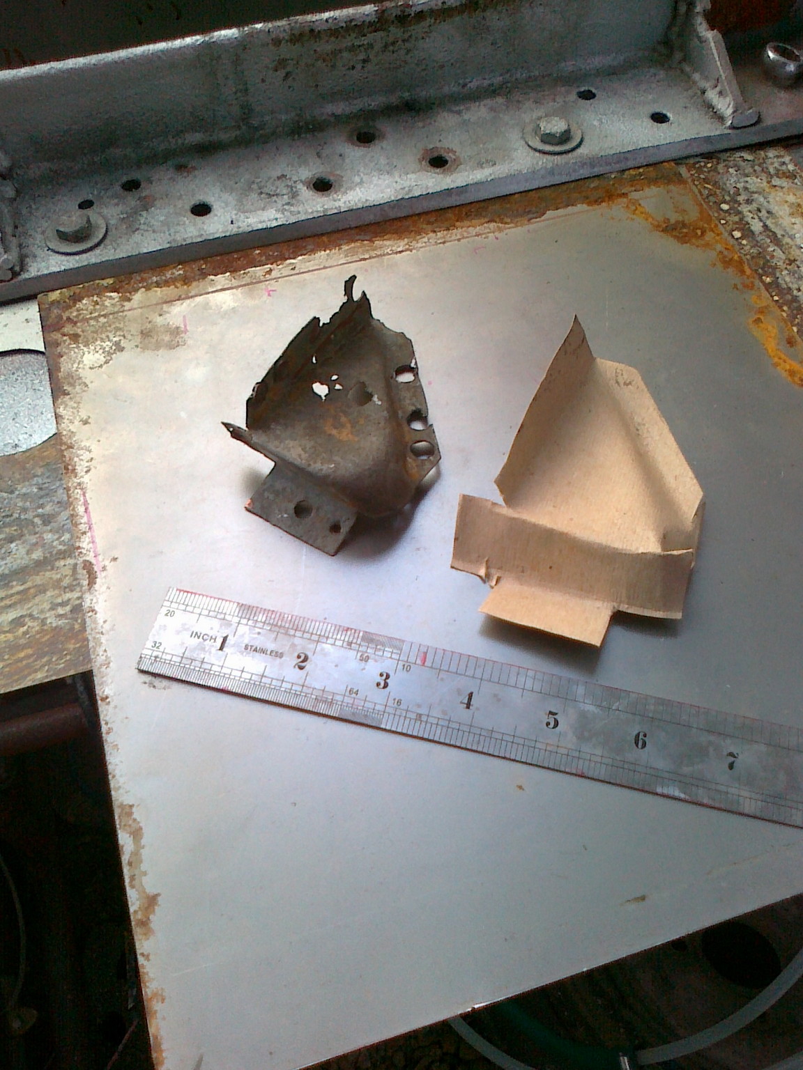

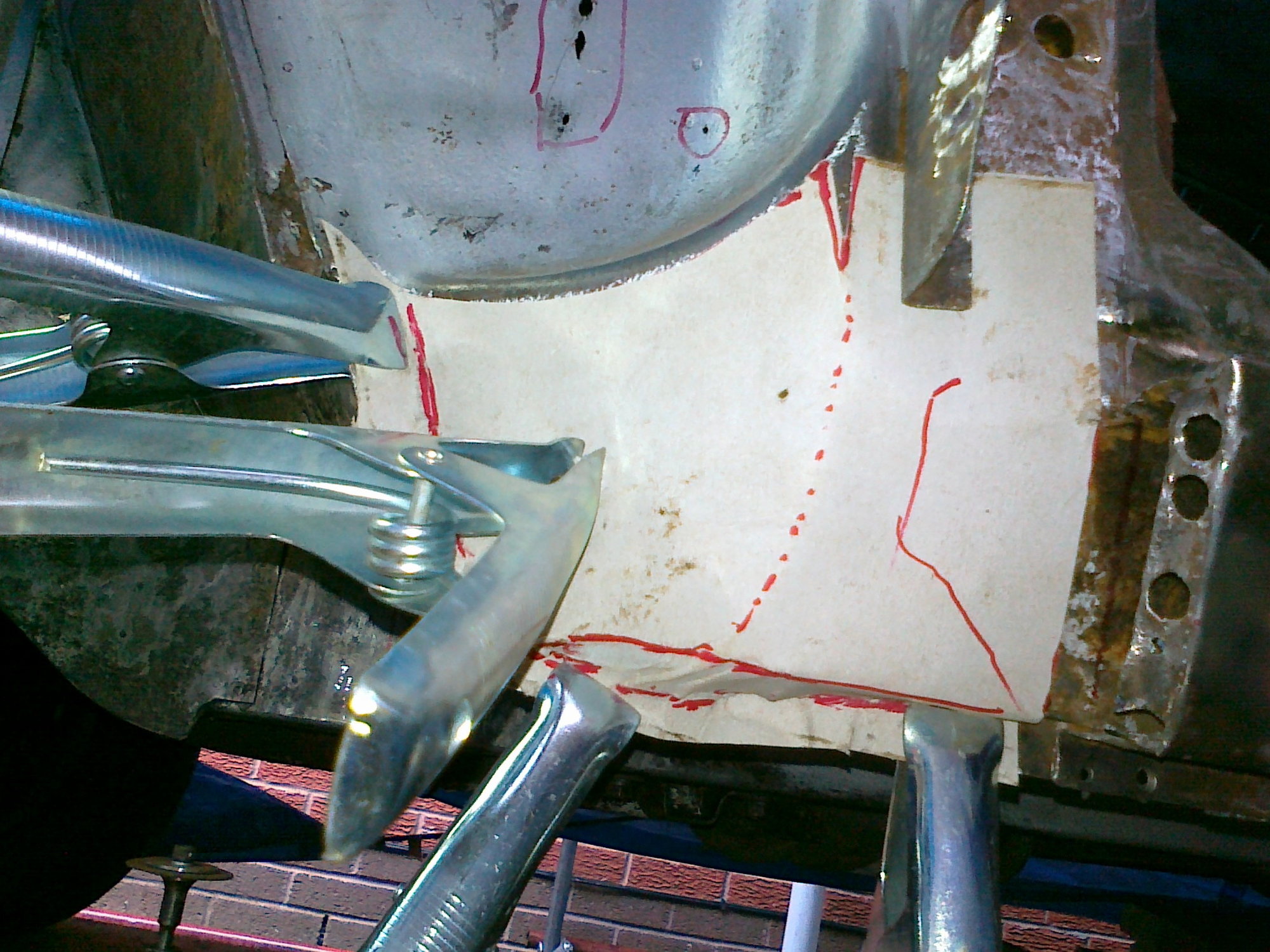

. Bigger flat bit first, then you can work to it using CAD [cardboard aided design
] to bend/shape the rest.
