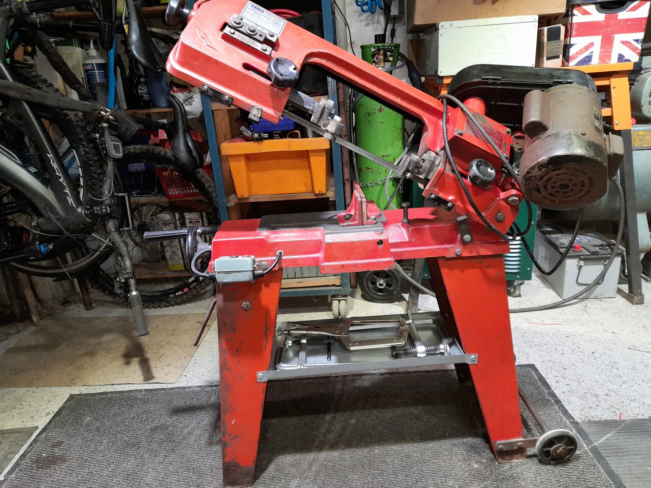

That 6x4 is missing it's tool tray (& strengthener for the pressed-steel legs). Funnily enough, the Sealey 6x4 I bought was missing the tray as well. I made one for mine as the pressed-steel legs are quite flexible without it.I've a cheap Scheppach from Aldi. A bit like this:

I made a new stand from box section which included a tray for mine. Massive improvement.That 6x4 is missing it's tool tray (& strengthener for the pressed-steel legs). Funnily enough, the Sealey 6x4 I bought was missing the tray as well. I made one for mine as the pressed-steel legs are quite flexible without it.
(At some point I need to make a platform with 4 locking castors for it I think. It'll make it more rigid, easier to move & "park", plus I think the working height will be better...& I'll have one more tray to store cr@p on)

I bought an old 6x4 Sealey generic bandsaw for such jobs. MUCH quieter, no sparks, no heat, no abrasive dust. Slower cut (but neater & not hot) but as it clamps, cuts & switches itself off, you can use the cutting time to do something else while it works.
Put on a set of large locking castors, a bandsaw would probably take less time to move & set up than a chop saw on a Stand as well.

Mines also missing the Stock Stop. I'll find some suitable diameter steel rod & knock one up at some pointThe "4x6" bandsaws as they are known around these parts, are everywhere, I have 2 of them.
Wth the 12mm barstock you could tack weld the ends together to make a bundle (probably 4), and then let it munch away un-aided on that.
With a stock stop, and a bucket for the pieces to fall into, you'd be amazed how many pieces in an hour
