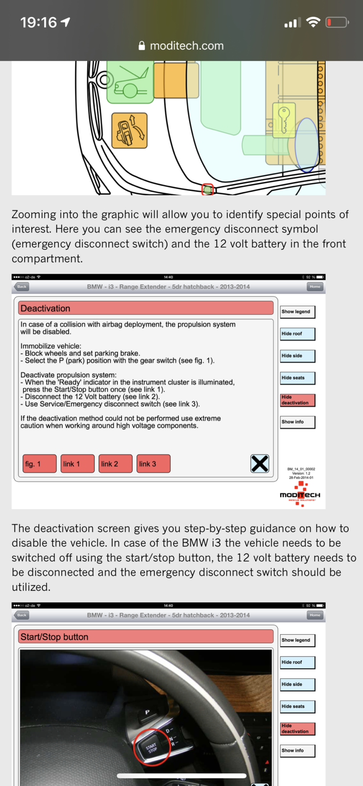

Surely everything but the motors and Regen would be running 12v or below as per ice ?I think what they mean by "statistically" is that they are equally dangerous but people are being killed more by AC simply because there is a lot more opportunity with 240v being in every house.....where as most DC the same people have encountered has only been 12v so chances are it's the AC that will get them!
I wonder if we'll see more DC related deaths as electric car numbers increase maybe...especially when people have been so used to messing with 12v electrics!
I recently attended a training course in Glasgow, where the whole grid sustainability thing was discussed. I asked the visiting proffessor (one of the main European and UK gurus on the subject) - if we were starting from scratch would we use ac or dc? No doubt it would be dc, we might soon even see some "minigrids" where large housing estates will be dc, with converters for streets etc.
from what I can see it’s just battery>inverter>motor that’s high voltage

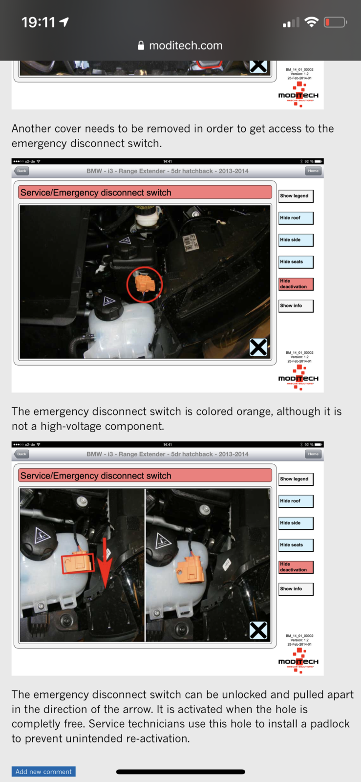

To replace the screwdriver that's just been vaporised.Yes absolutely....but people who know nothing about electrics might think it's all 12v because they are so used to cars all being a safe voltage when in fact the battery packs are supplying 600v?
I'm pretty sure you can slap all the warnings you want on the batteries and the high voltage stuff and someone will still stick a screw driver in it....then try to sue the manufacturer!
