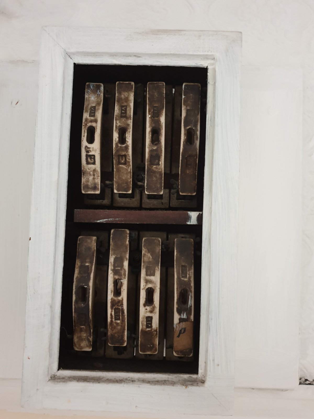

so would I and bin it200 year old house, not been connected for a while but still in place
I'd clean it up if it was my house
Where in the property are they installed? Could be for activating buzzers to summon the Butler/Chauffeur/ Footman from 'downstairs'.![]()
They are definitely fuses,
its a sub mains fusebox used for lights .the neutrals are fused as well . was at a house 4 years ago that had them with lead covered rubber cable still working![]()
They are definitely fuses, above the door to the drawing room. No other bell or buzzer system visible
The live\neutral fuses were standard stuff when I was apprenticed the rubber VIR \ lead covered was also around on a lot of older properties you could remove the neutral fuses & nothing stopped workingwe used to love those re wires down the scrappy with it.

As for servants bells with maybe buzzer & flag never saw any fuses in the circuit most ran of Accumulators or big round dry cells like these
