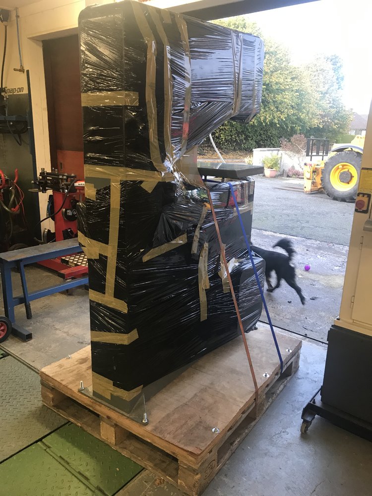

Not if it was bolted down on a 120x100. I have shipped much bigger.On a full pallet that would probably have gone over, the load would have been on the central risers and it would have pivoted on them. Should add some braces. If kept on that pallet and the other side is flat just strap it to the headboard.
Ideally with a sheet of ply screwed to the pallet as well.
