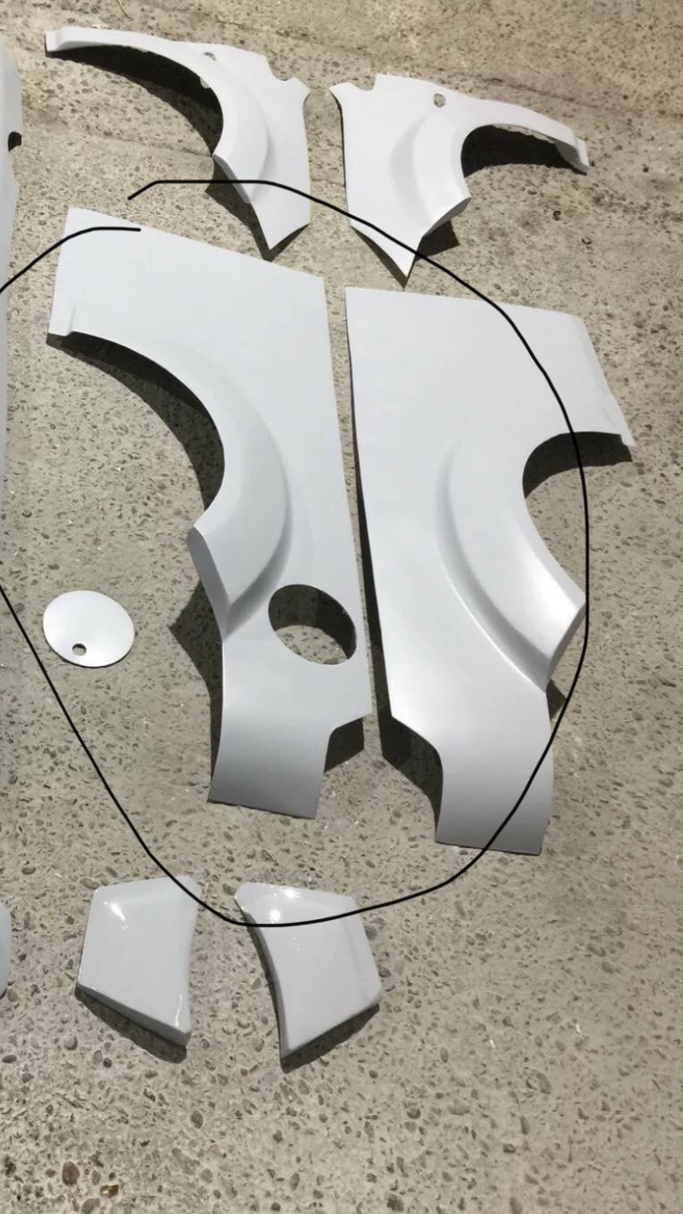

if theres wide wheel arches the inner skin and outer skin have to be cut back and joined together so the wider wheel will have full travel in to the arch then weld the new wider skin on
THEN you start finding the frilly metal.
