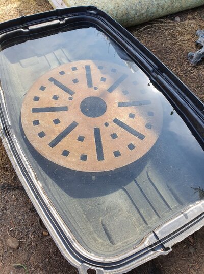

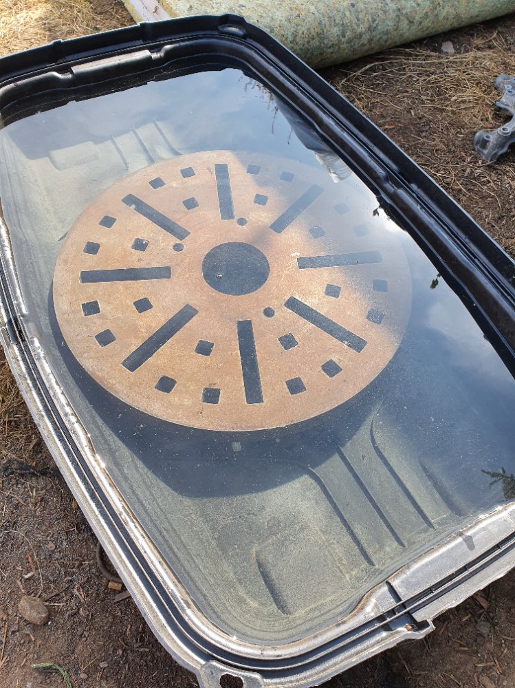

Dont use just citric acid. A far better mix is to use 100gm citric, 40gm of washing soda (tesco green bags) and a squirt of fairy liquid per 1L of water.
It is reusable many times. Doesn't turn the metal black. And doesn't etch the metal so much.
It is a similar solution to Evaporust.

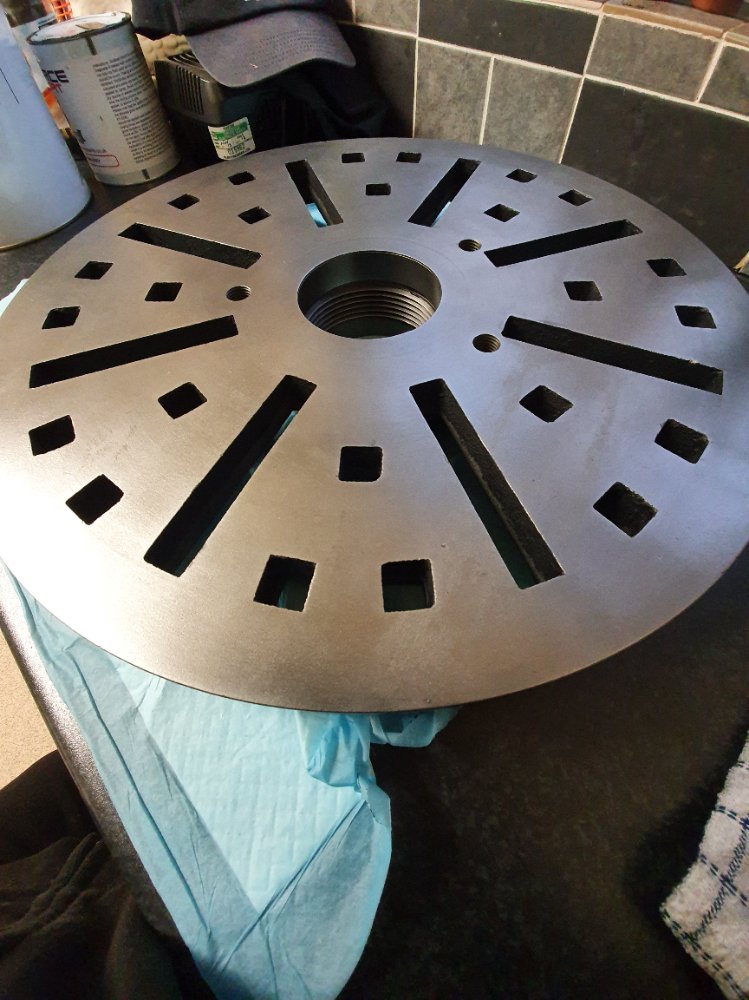

Why are you heating it? My mix worked fine at about 16C in my warehouse. Only 3 hours for some pretty rusty bolts. Overnight should be fine.worked a treat so far , made some up in a bucket with very warm water and its cleaned it up overnight
