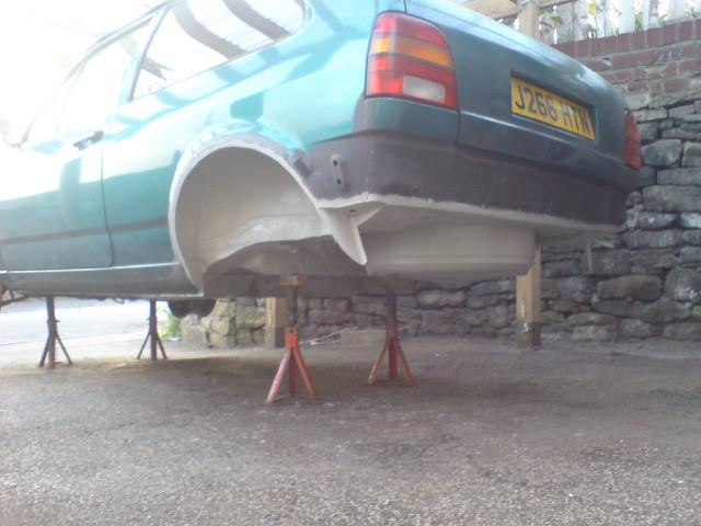

I personally expect my Jotun to last well over ten years if not double that but my chassis and parts have been sand blasted and the body will be back to bare metal.
My only worry is how it will perform in the wheel arches without a stone chip covering.
My cavities are being done with Dinitrol and will be reapplied regularly.
I'm just using Jotun 87 on the underneath of my cars. One I did the rear third of the car,stripped back to bare metal and then applied the jotun with a brush.
there are only a couple of small areas that need touching up again, but it looks more like its because I "missed a bit" rather than the properties of the Jotun. I only drive 1000 miles a year in this car, but it is parked outside and not garaged. for cavity wax Im using Bilt Hamber dynax S50

Wirebrushed areas, by hand or grinder - after 10 yrs the epoxy paint had become detached in flakes, sheets, whole sections, letting water under to rust what was good steel
Areas I blasted were still intact - the epoxy still had a good hold on the metal - to get it off in areas to do other work, I had to blast and grind it.
I covered it with a top coat of machine enamel - I used machine enamel has that's what I had numerous 5ltr tins of. Then a good sprayed on coating of underseal - the difference in colour between the underseal and the enamel allowing me to see any areas that had worn off from having road grit thrown at it.
None of which stopped other bits rusting out from the inside - I used waxoyl and Dinotrol on this car - not sure there was much difference. On it's rebuild, I'm using noxudol 700, the stuff Practical Classics decided lasted well in their 3yr test.
I've put Jotun Hardtop on top of my epoxy primer and it is rock hard, but appreicate the comments and I'll consider some stone chip covering. Is this the rubber stuff? How is it applied?
