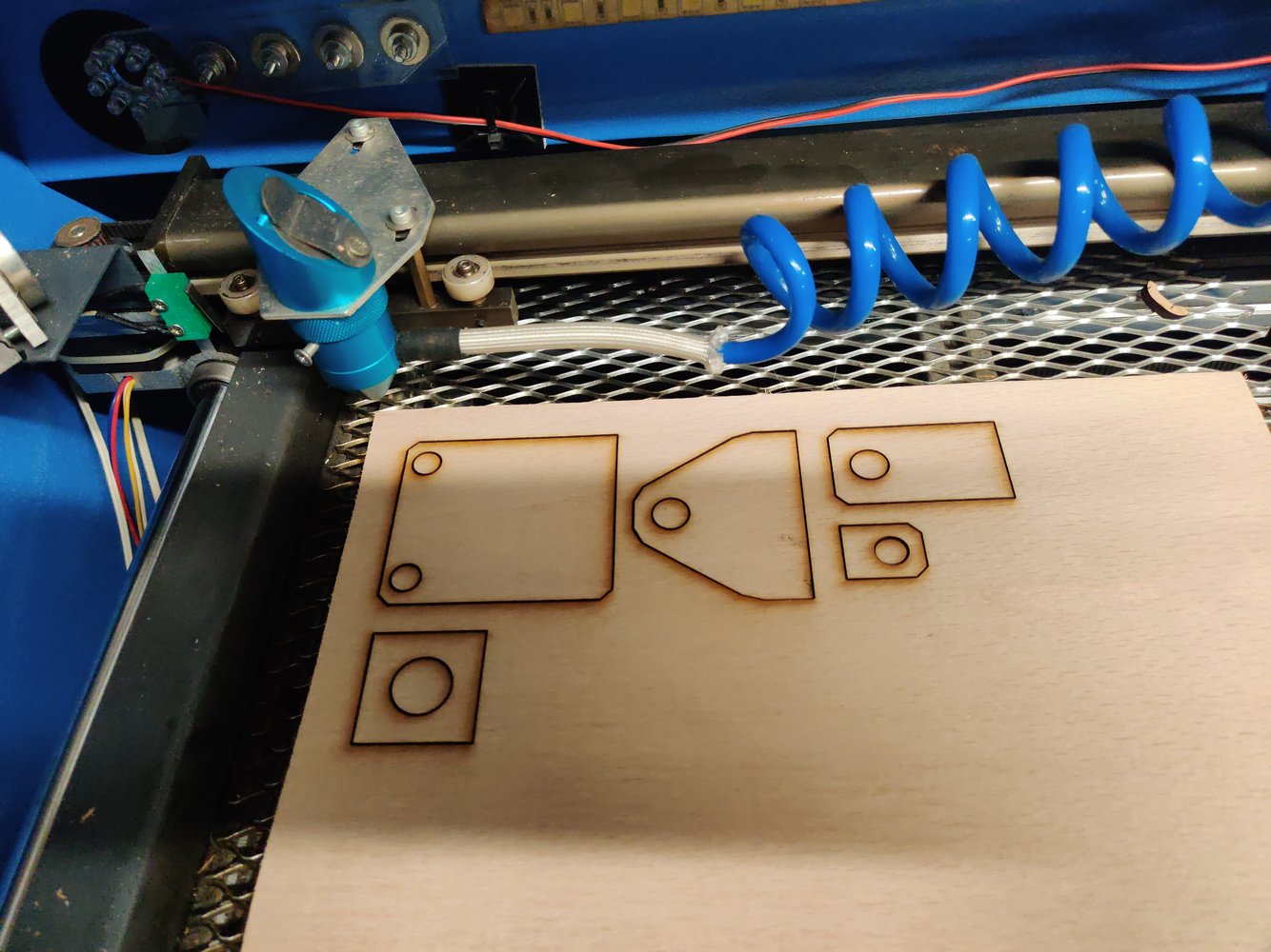

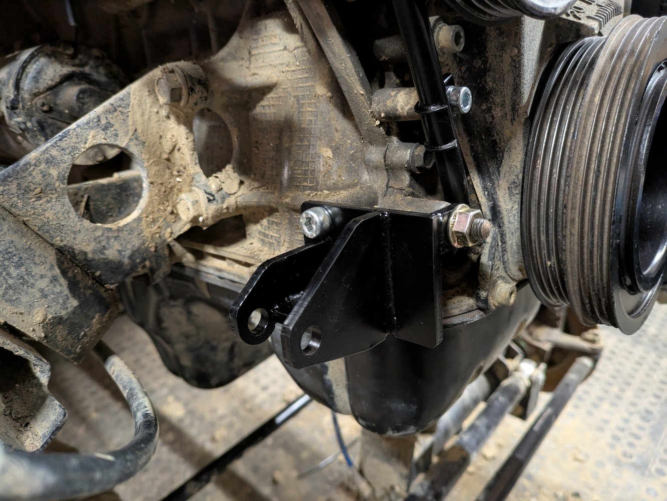

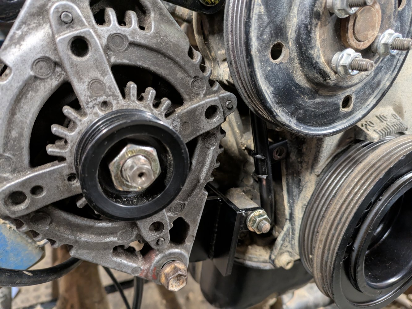

This is a method I've found works for making custom brackets for my buggy build. It's absolutely not for everyone, but I'm faster with CAD and CNC than I am with an angle grinder. It also avoids late night noise that would otherwise annoy my neighbours. In this example, I needed a custom alternator bracket with 1mm accuracy to get proper belt alignment.

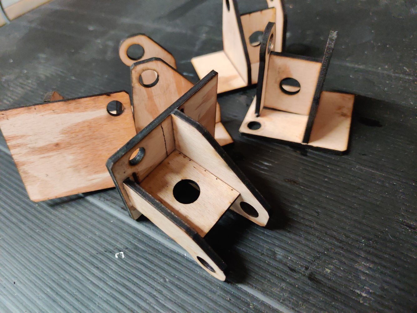

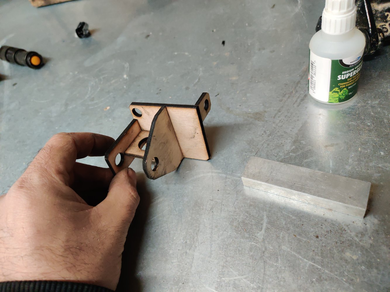

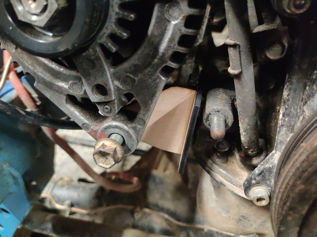

The method starts with first making a bracket out of plywood using a low cost 40 watt laser cutter. It takes several goes to get a precise bracket, adjusting the design after each attempt. I use superglue for the plywood because it dries almost immediately and is strong enough to support a 6kg alternator in this example. Once I have a plywood bracket that fits and works properly, I send the final drawings off for cheap eBay laser cutting.
I've made some pretty neat and elaborate brackets, and as always, forgot to photograph them until this last simple bracket.
