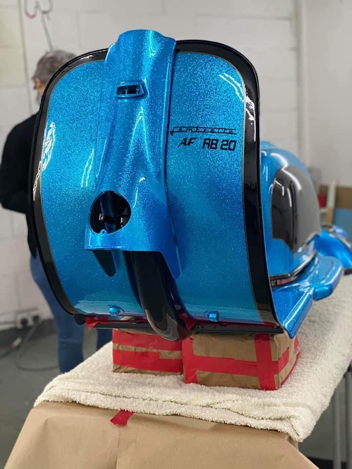

just wondering how they painted this one - there's a silver pinstripe between the flake and the black - nice detail. I'm not bothered about flake but a similar scheme with a metallic would be cool.
Is it silver base (just a band where you want to colours to join), intercoat/clear to seal. Tape the pinstripe you want to leave then mask one side and do the blue flake base, then intercoat/clear it, then tape the blue off and do the black base, then remove pinstripe tape and clear the lot? I assume you need to clear over each base colour to seal it and so you can mask it, but would you need to sand the clear at any of the stages or before the final clear coat over the whole lot to remove any edge?
Or have I got it completely wrong?
