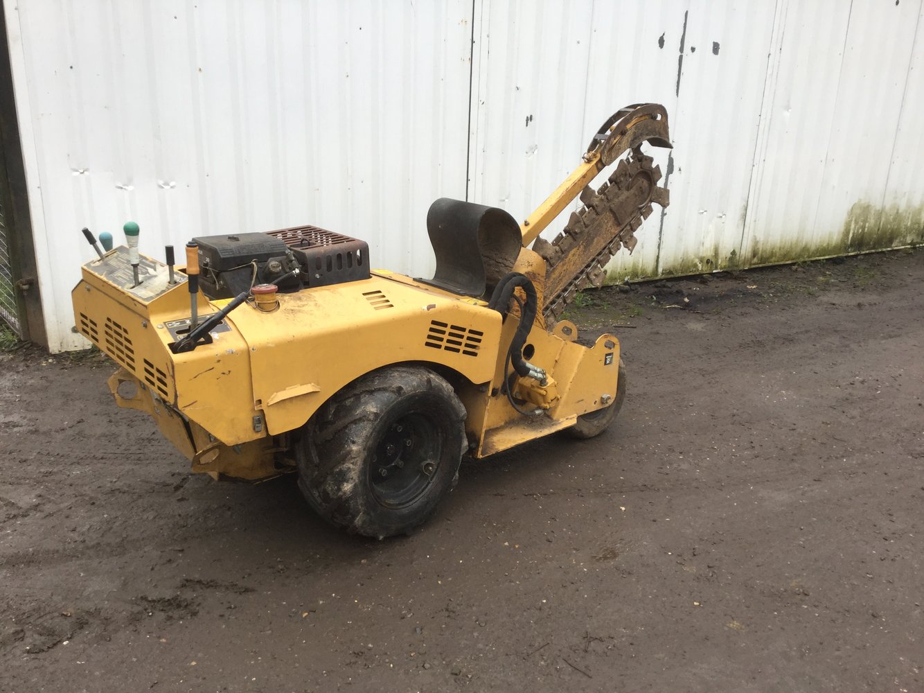

When I was 16 & a BT Apprentice I spent a period with the cable gangs.To be fair there are cable winches that are trailer mounted and work in a much similar way to a machine track, they are usually metal drum to wrap the draw rope round.
BT use them a lot on their cable installs & upgrades!
