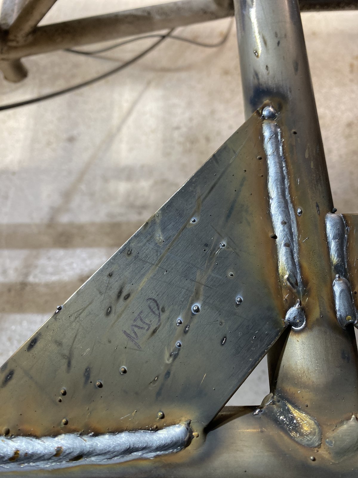

Is it possible to do anything to stop spatter like this?
I’ve tried increasing voltage a little, changing torch angle, higher and lower gas flow, nothing helped. many ideas?

Your voltage is too high.
Exactly what I was going to say.
It sounds counter-intuitive - surely more voltage will burn hotter and give less spatter? Well actually, not really, not if you're pushing it into a globular transfer range.
You can also see a wide wetting on the beads which would indicate more voltage than necessary.
Run the lowest voltage you can get away with to give good wetting. That hot and nasty spatter will disappear, and you'll get much cooler and easier-to-remove light spatter instead.
If the power source is a good one, you'll end up with zero spatter.
