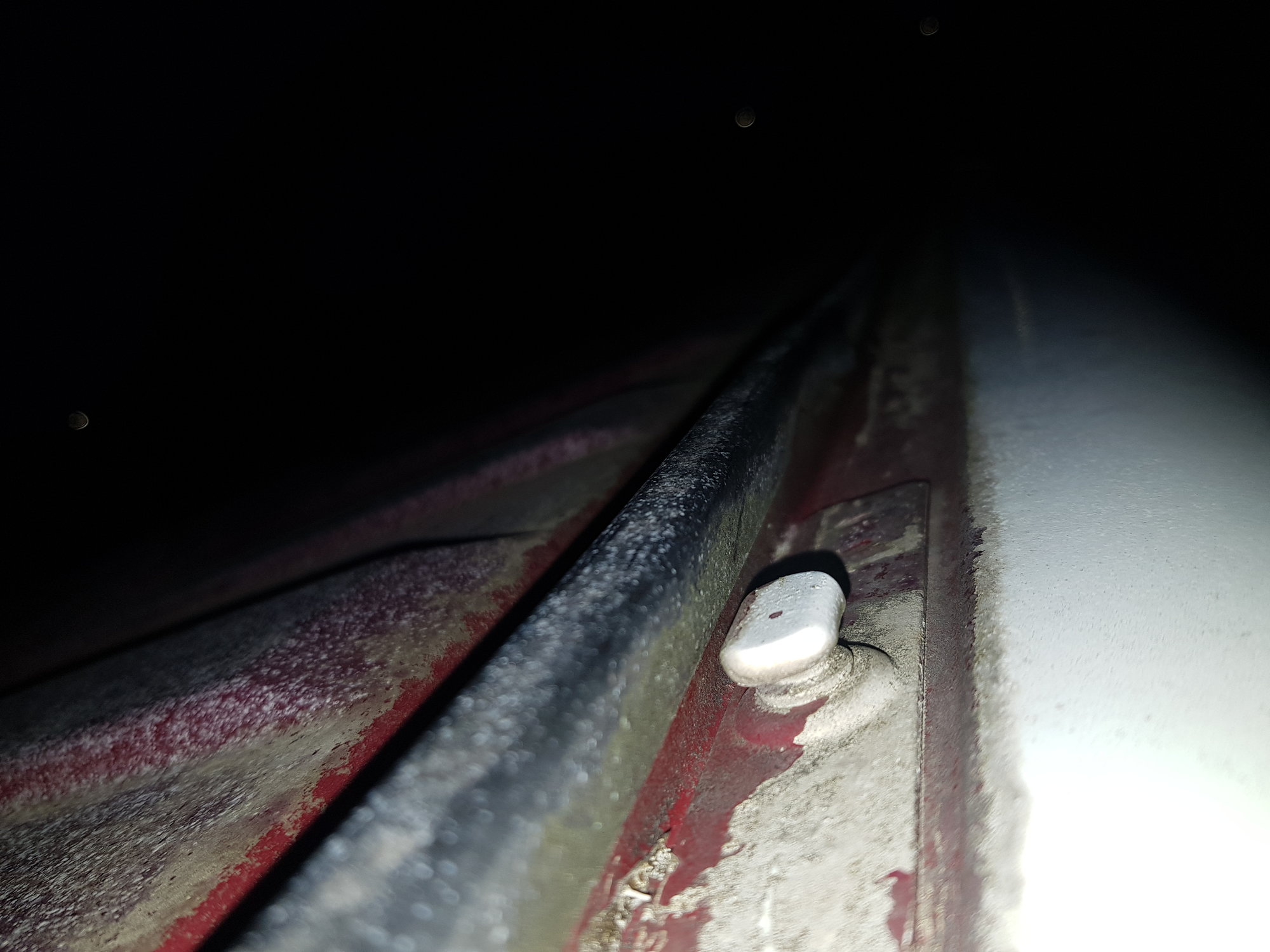

A Adam Marshall Member Messages 489 Location Nottinghamshire England Mar 8, 2020 #1 I have been making a roof rack for my van but thinking how I can fix the thing to these lugs without welding it to my van. There are 3 lugs each side of the van as you can see in the pic they are like a mushroom shape. Thanks in advance 20200308_182350.jpg 280.4 KB · Views: 50

V VeiRoN New Member Messages 27 Location Kent Mar 8, 2020 #2 Can you weld nuts after taking the lugs off?
the snooper getting older by the day Messages 21,086 Location Hull UK Mar 8, 2020 #3 Slide some small u bolts round them then build off those
qwakers Member Messages 2,642 Location cornwall, united kingdom Mar 8, 2020 #4 it looks like the lugs unscrew leaving a standard threaded hole to bolt into.

A Adam Marshall Member Messages 489 Location Nottinghamshire England Mar 9, 2020 #7 Hi it's a citroen relay but an old one 2005
Beeezer Things are really chaining for the better…. Messages 899 Location Northampton Mar 9, 2020 #8 Unistrutt. Slips over then twist, fit what you need to to that.
