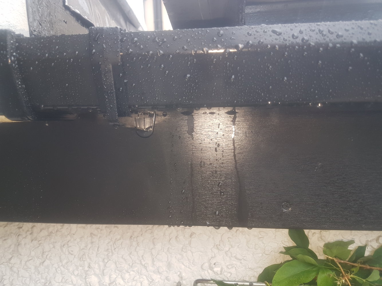

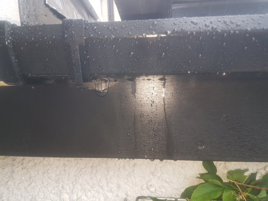

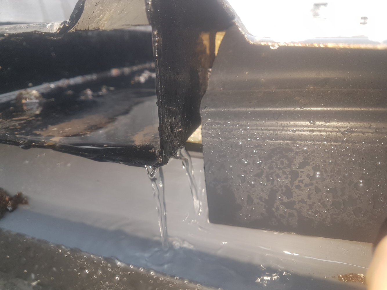

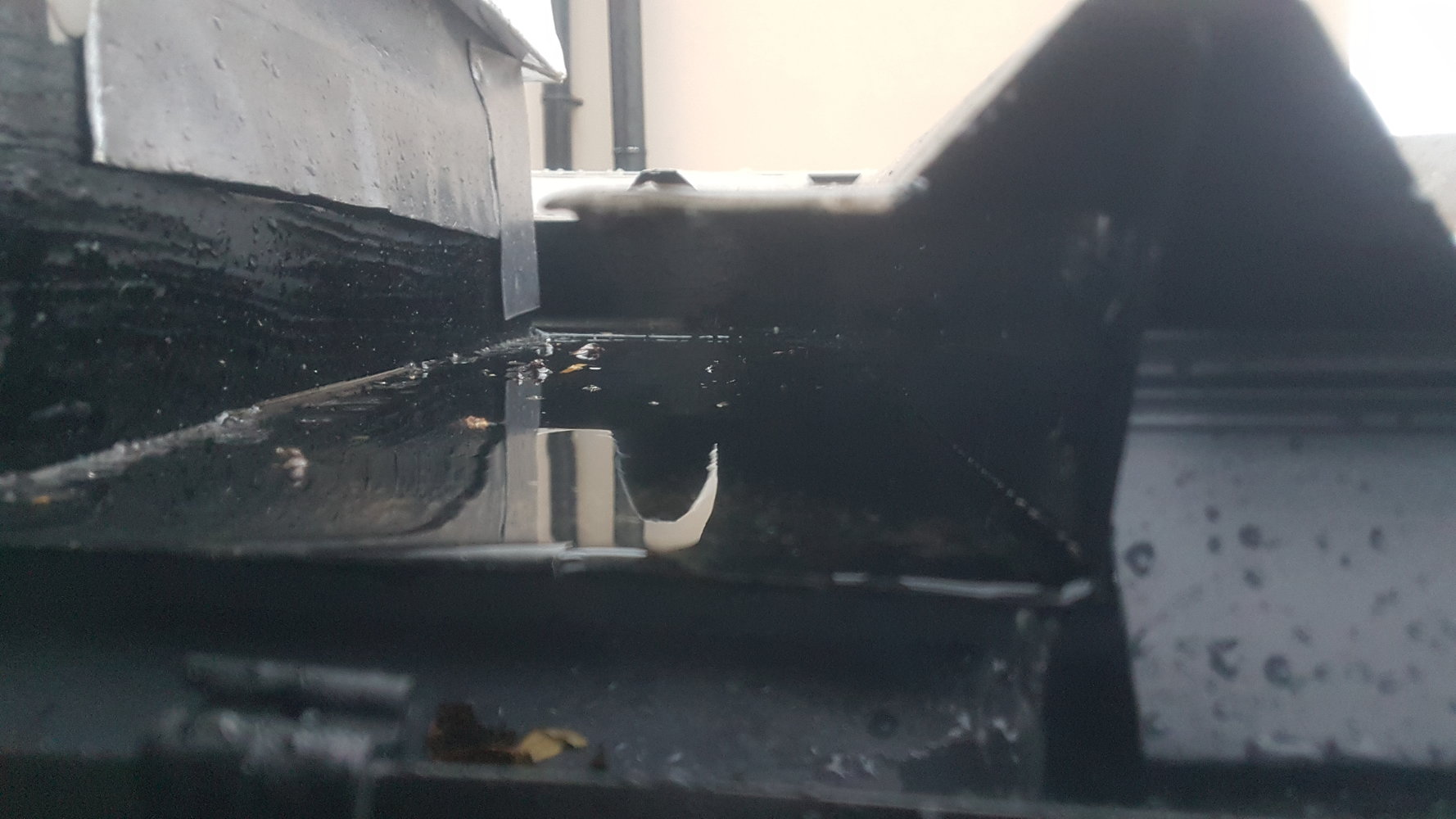

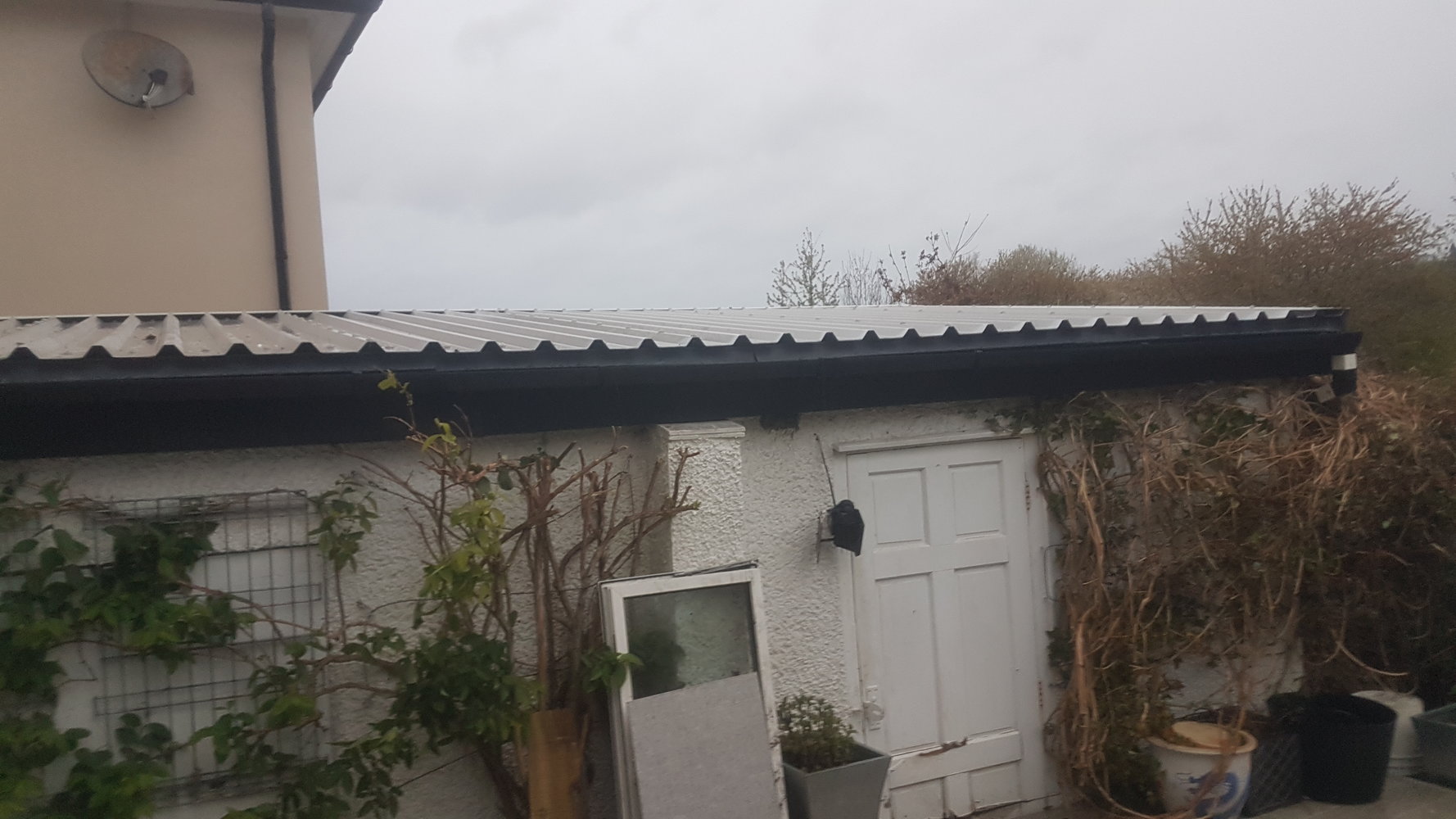

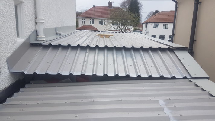

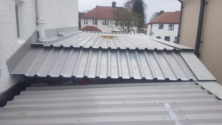

Would work the same as cutting into it 5 or 10mmand bending it down.weld a lip on the end ? for a drip like a window sill
thats what I thought, I got some lead mate left in the gun that will do the job quite nicelyuse a thick silicone bead is all is needed and it will drip it for you

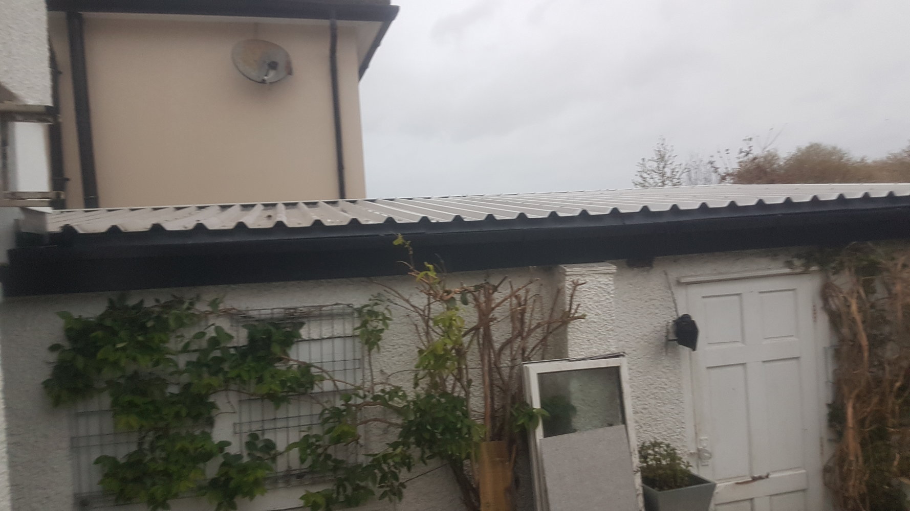

it means unscrewing it to fit those foam inserts though.you can buy these if you want but match to your roof profile
34/1000 Box Profile Foam Fillers / Eaves / Infills Roofing Sheets 10 pairs BLACK | eBay
