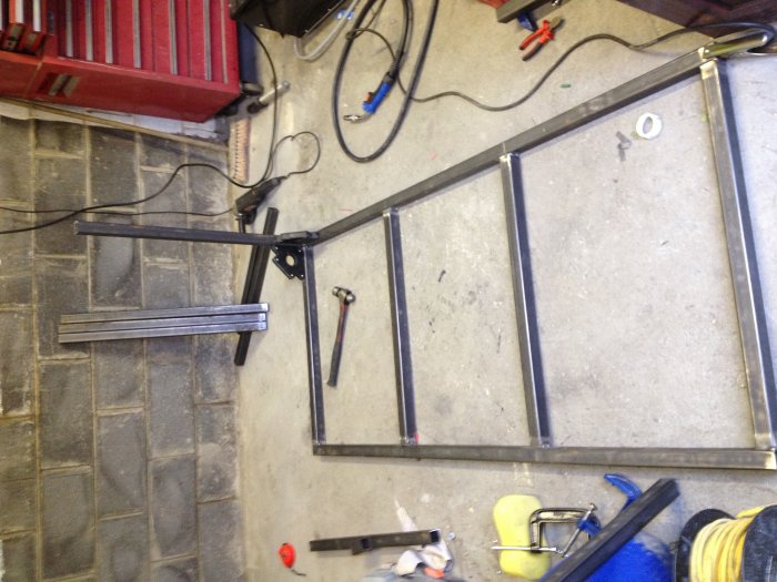

I'm not convinced its sagging under its own weight. When the plate was flipped over it was high in the centre. It's the bend in the plate that's flexing the frame and not the weight of the plate. I have a couple jobs to do at the moment so ill just have to live with it for a weeks or two until I have time to sort it.You got to remember, its sagging under the empty table weight.
You need some serious strengthening to allow another 500 kilos on the top in the middle.
A 2 meter length than can bend up and down, should be supported in this case 1/5 in from the long ends. Ie. 400mm in. If only using two supports on the long length.
But as you want a rigid edge, then you should go for a middle leg imo. ( making 6 legs in total )
Here is an image of the frame under the top 1850mm x 880mm
