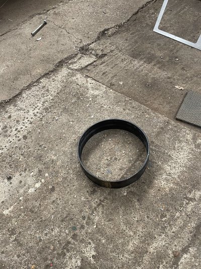

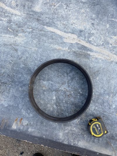

If you are worried about HAZ and machining after welding, bung the whole thing on the BBQ until it is red and throw into a bucket of vermiculite for slow cooling.
