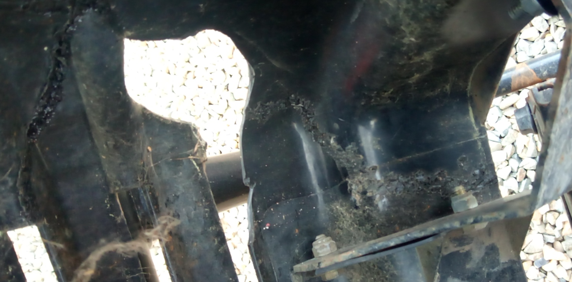

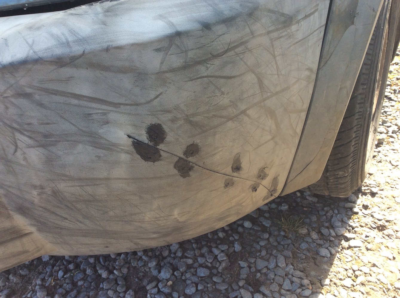

“Micro solution”Lastbodge upI did, just drilled lots of holes down each side, then used a piece of thin ali full of holes on the back clagged with an epoxy adhesive. Smoother off once set.
No it was definatly a bodge. But the micro halford touch up hid the mess, well enough not to affect her trade in price“Micro solution”![]()

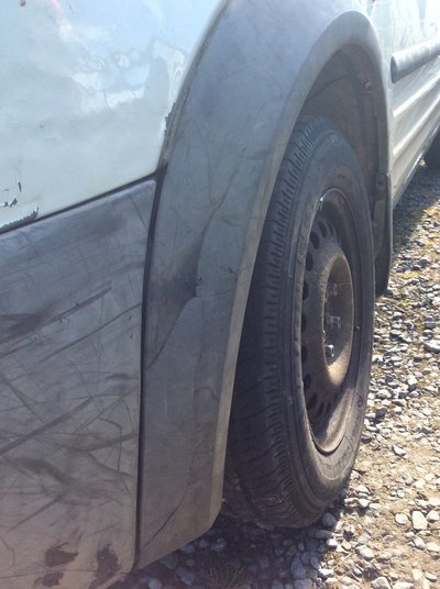

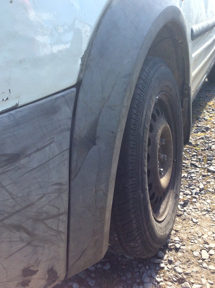

The bumper comes off easily. I’ve laced it with cable ties but it got the thumbs downI’ve drilled each side and laced them with cable ties before now. You need access to the back mind.
