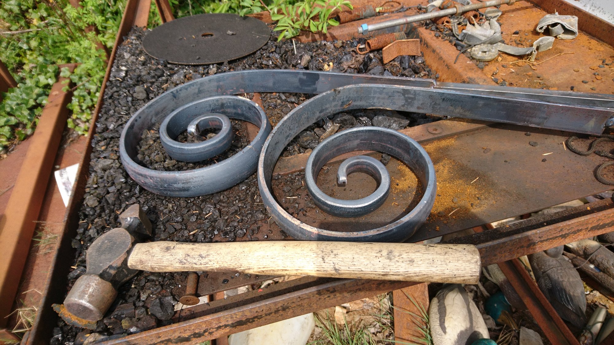

Practice is the answer. And also knowing how to fix errors if they occur (you only learn from making those errors)@Kent they have come out good.
I could probably have a go at making one, but to make any more and keep them all the same is a skill I don't have
