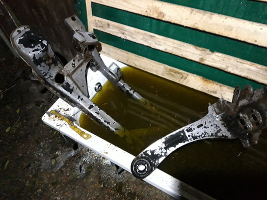

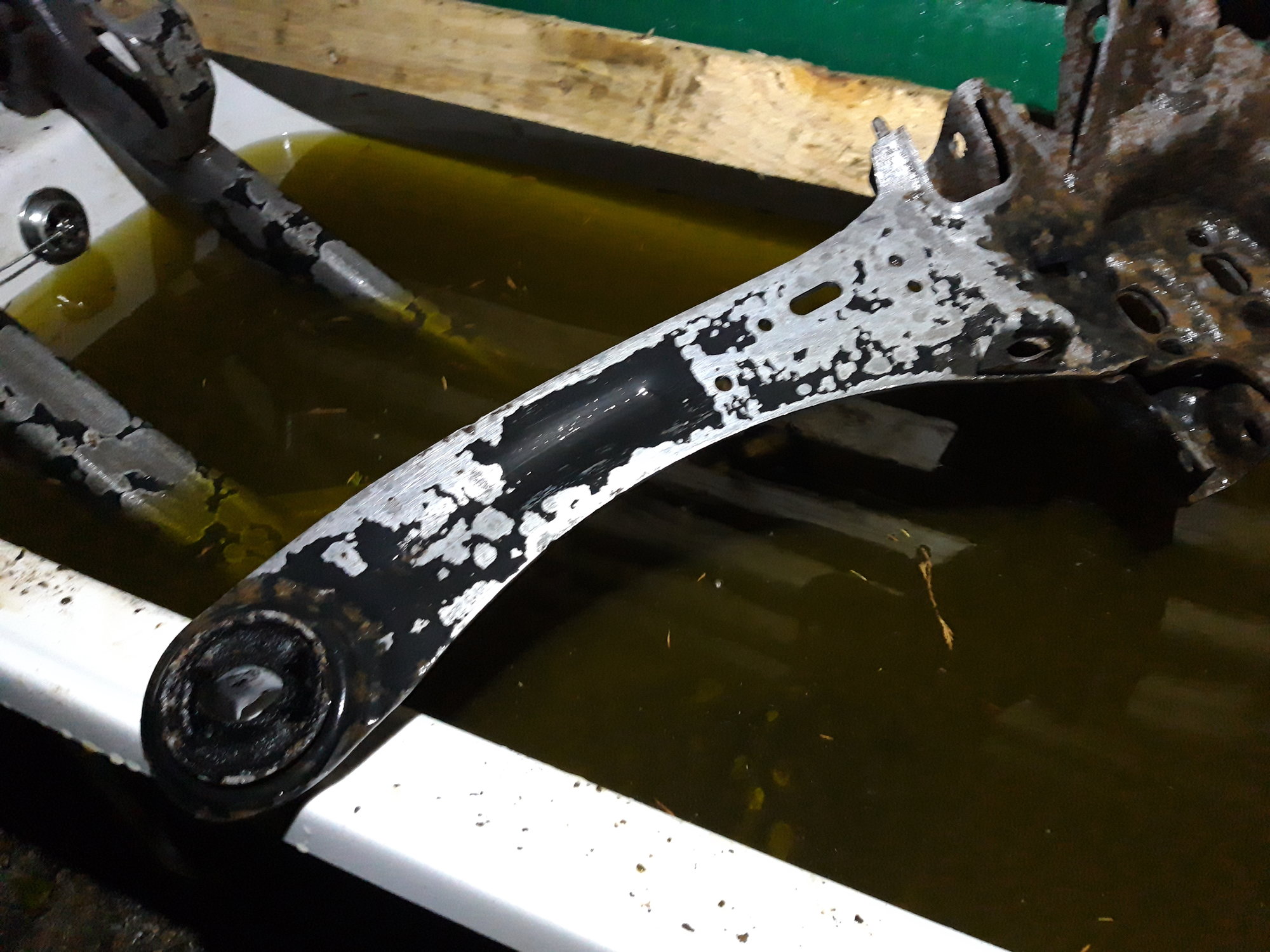

I agree with your thinking, butt if he doesn't put decient paint on it what's the point?
Also leaving it longer than necessary before painting it (once and properly) seems silly.

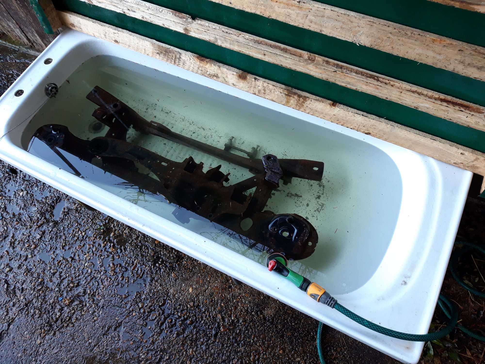

If you don't wipe off the citric acid solution and just let it dry, that will protect till you need it, wash anf dry just before you do need
I used that AutoTek primer once, it was terrible, seemed to have silicon contamination in it that showed up when top coated.
