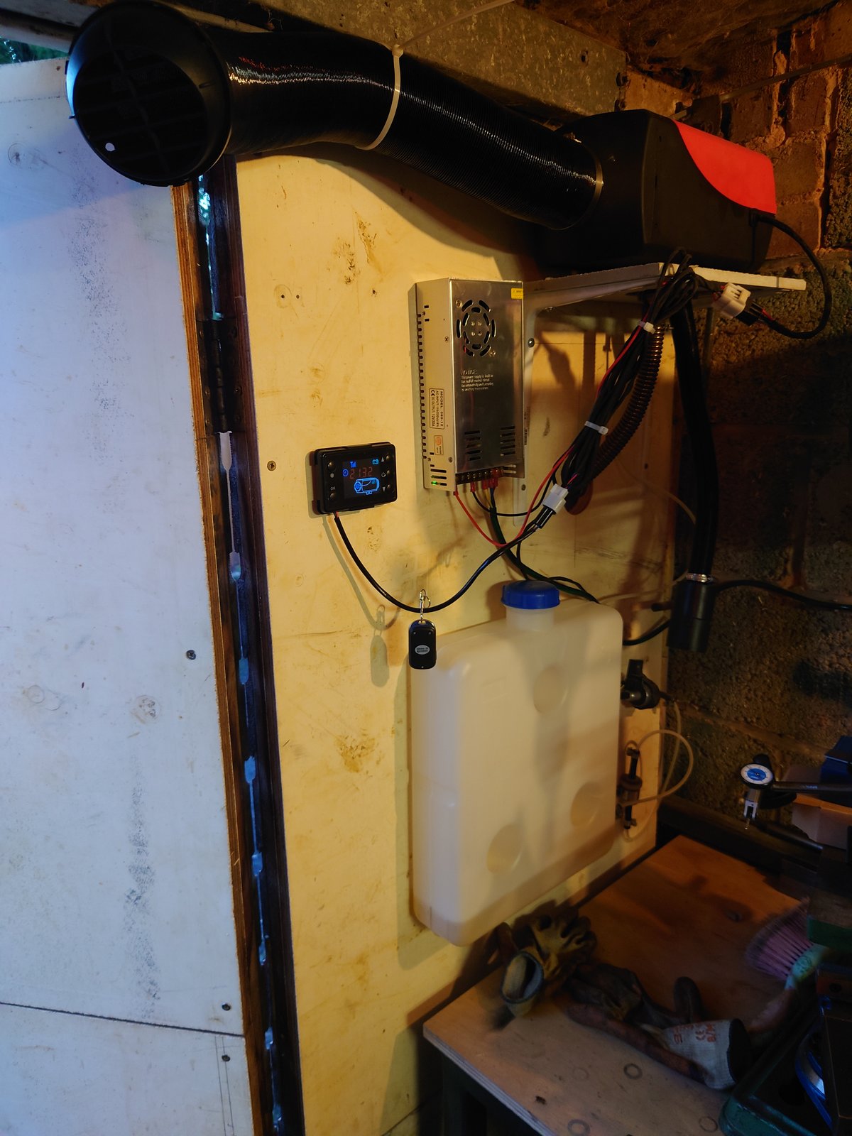

Reason i say that is ti have a 'garage' workshop and a similar heating system. If your Heater is 5KW like mine then a warm air vent into each room would keep them both warm enough. I run my heater at the 'door end' of my garage (for simple venting reasons) and the heat travels around very well and I need to run the heater on low or its a sauna! if you are trying to keep heat at one end because you arthinking it will be warmer that might be something to test?
Failing that a simple 'shop extractor' type 'blast gate' in the line might work, there are loads of homemade ones on youtube....

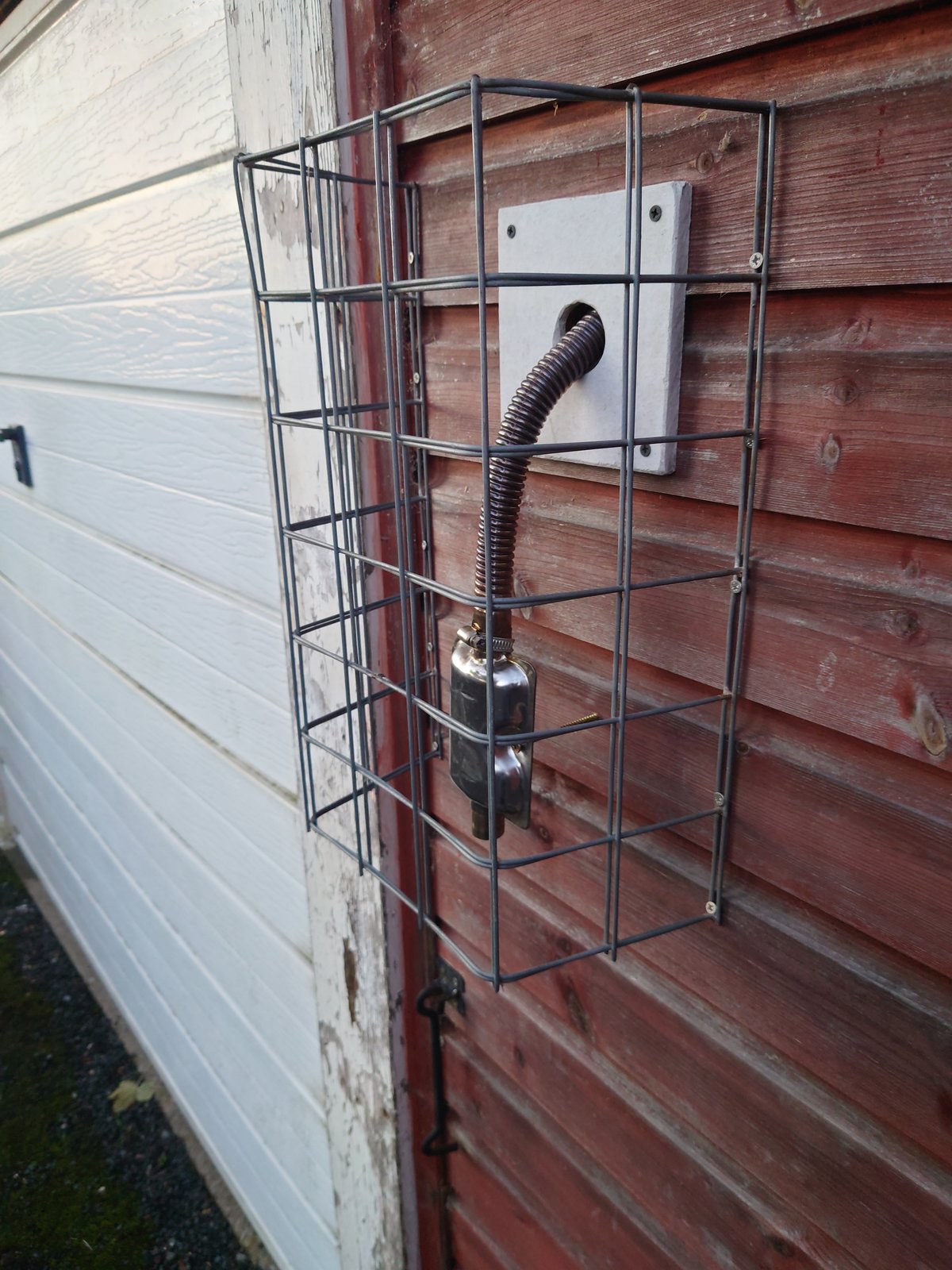

Just a thought... Here is my set up just in case it helps in anyway
View attachment 263167 View attachment 263166
